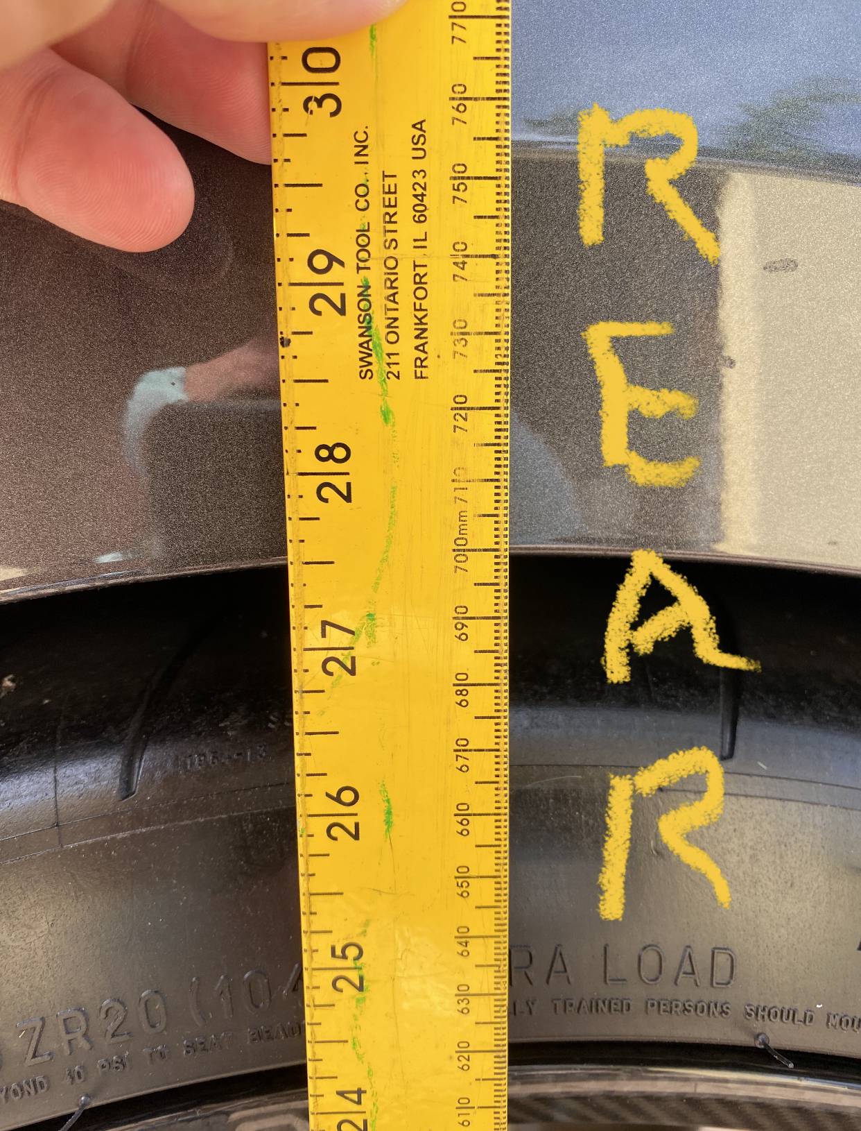

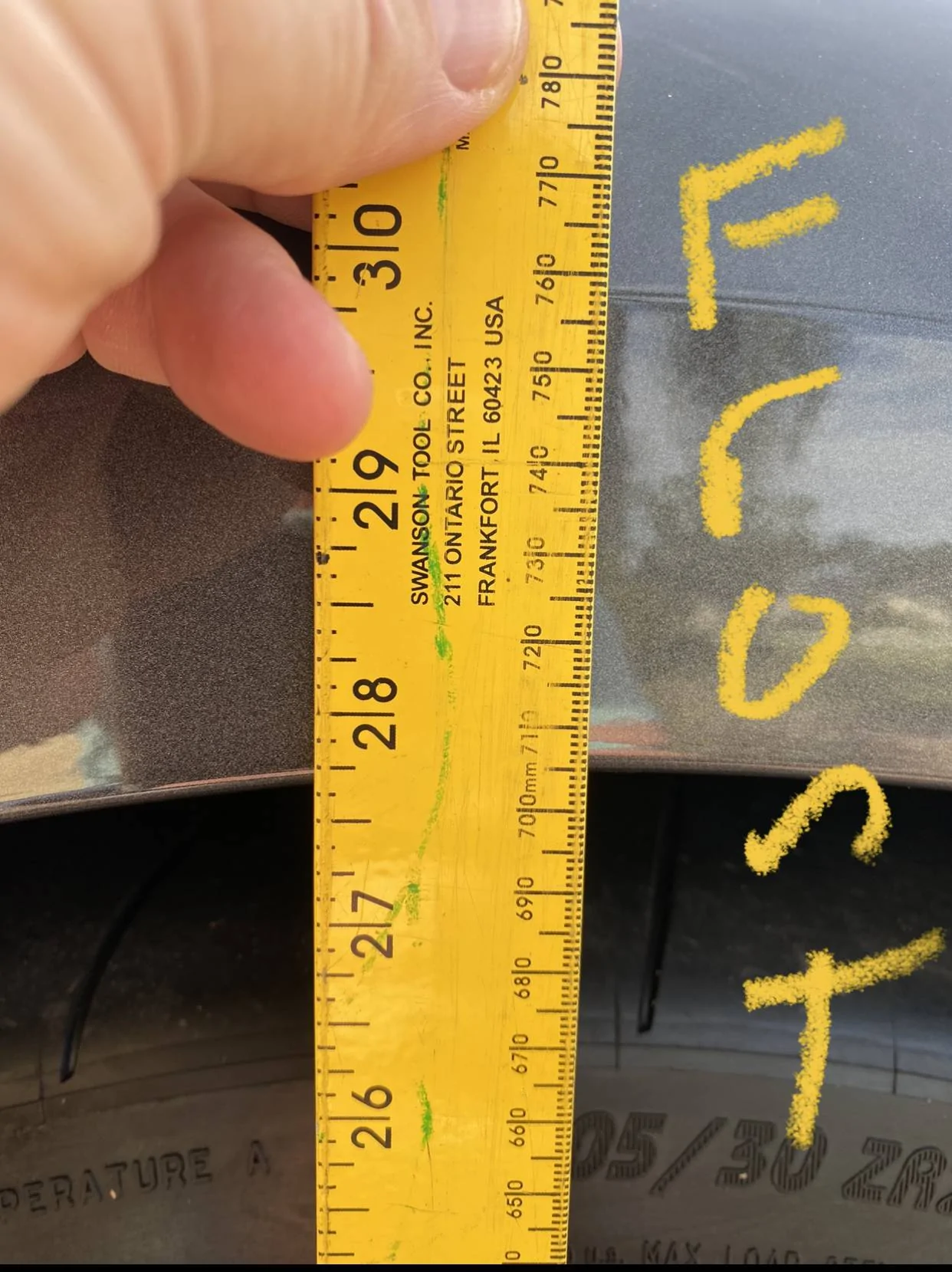

Installed the BMR Springs yesterday on my new 2021 GT500 CFTP. I will be selling my CFTP springs for $250.00 shipped if anyone is interested. Only 150 miles on them.
BMR lowered the car 7/8 more up front and 1/4 more on rear. I will post pics soon.
