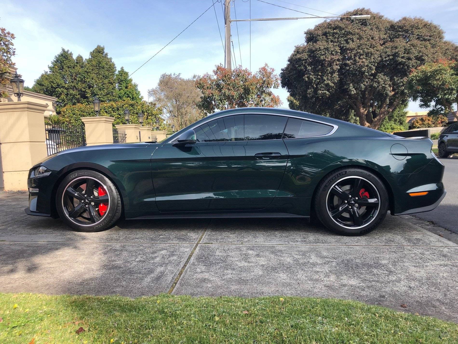

I have Steeda lowering springs. 1inch drop. Perfect and no impact on ride. Ford Performance also have lowering springs with a recalibration of the Magneride but only 20mm drop. Mustang Motorsports and Rob Herod both in Melbourne are the gurus.

Hey can you post a pic of your car I wanna see how the ride height looks

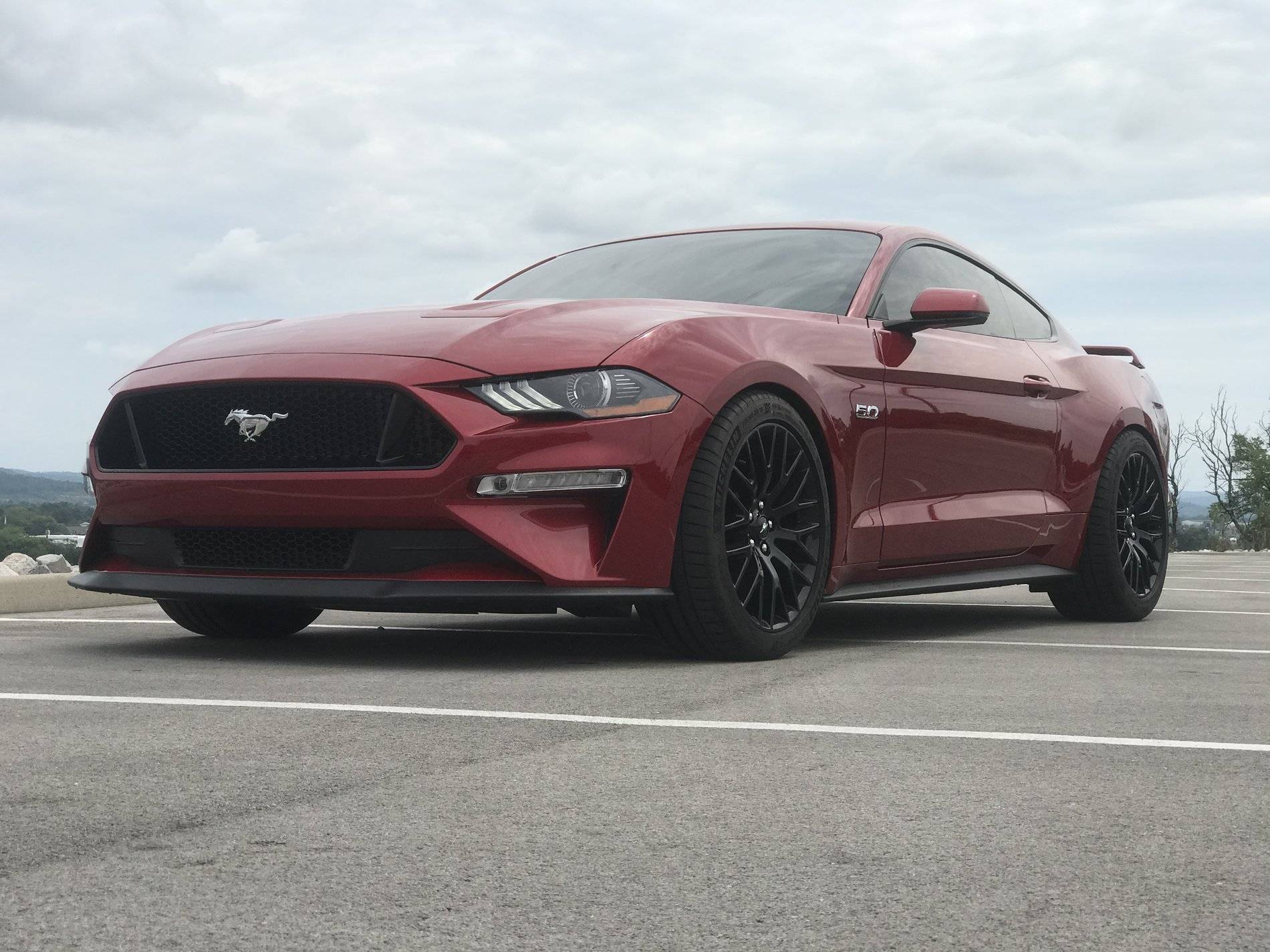

BMR here
zack.whitford
Jul 12, 2019
176
131
Los Angeles
Zack
2019 Bullitt
Steeda magneride springs and 25mm spacers. No calibration needed.
That looks fantastic. I would love to obtain that look without getting bigger wheels but spacers make me nervous.
