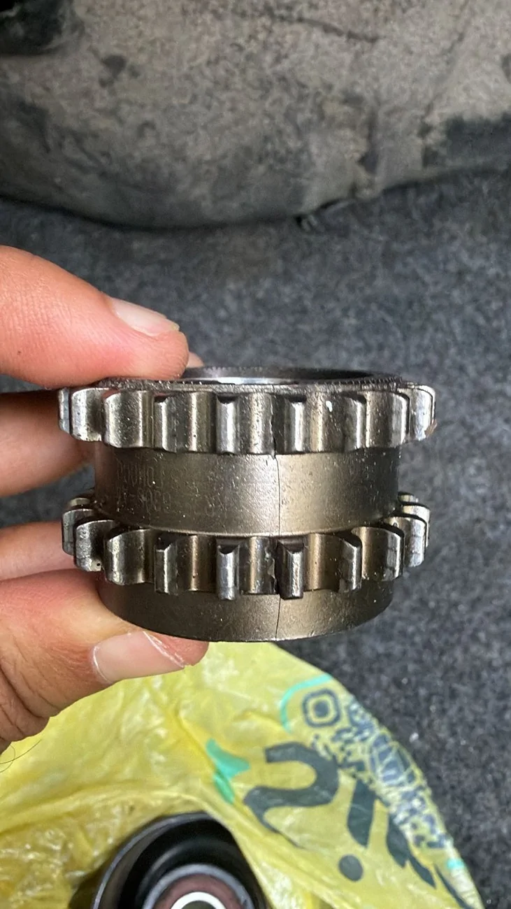

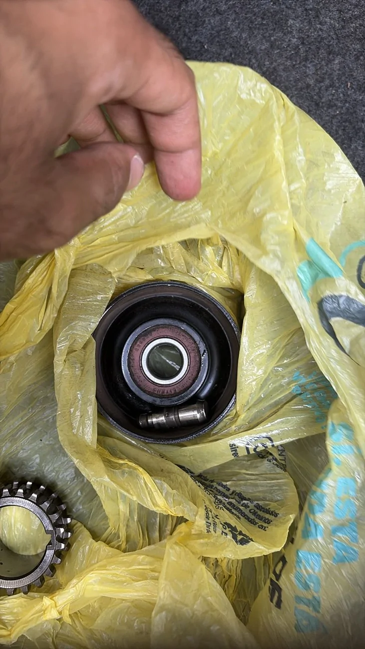

Hi everyone, I have an update. After trying a thicker oil (5w40), applying two flushes, and using Mollygen with Ceratec, the noise persisted (though a bit quieter).
Since I ran out of options, I decided to take the car to a mechanic recommended by several people who own Mustangs. To make a long story short, the mechanic found three bad lifters, a pulley slider that wasn't turning, and a cracked crankshaft pinion (I was lucky that no teeth broke and that the part held until I got to the mechanic).

That was a major repair IMO. Pulling the valve covers, pulleys and dropping the oil pan to remove the timing cover was a lot of work. The remaining noise sounds like it could be injectors to me.
Do you still have the foam pieces over your fuel rails and the foam block that goes in the intake valley? Those are designed to help mask some of the noise.
