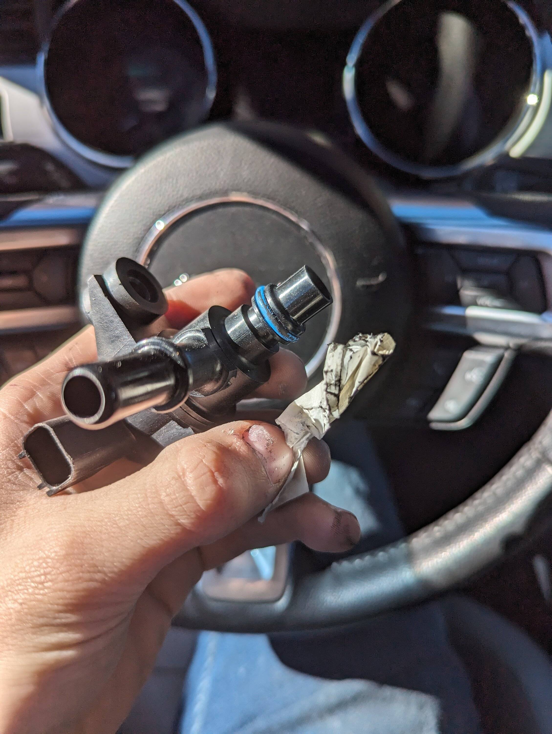

Remove the vapor line from the Purge valve and see if there is fuel or oil in it. Also inspect the electrical connector for corrosion, bent or pushed out pins.
Alright I'll check that tomorrow when I get off work and I'll post an update then

Hey I checked the old purge valve for gunk in it, all I found was a little bit of maybe oil in the side where the I ring sits, the other parts were clean and no bent pins

How about the electrical connector? Look at the tiny tabs inside the connector and make sure they arent pushed out, corroded, damaged

See Post #8. He pulled the plug on the valve and it stopped ticking
