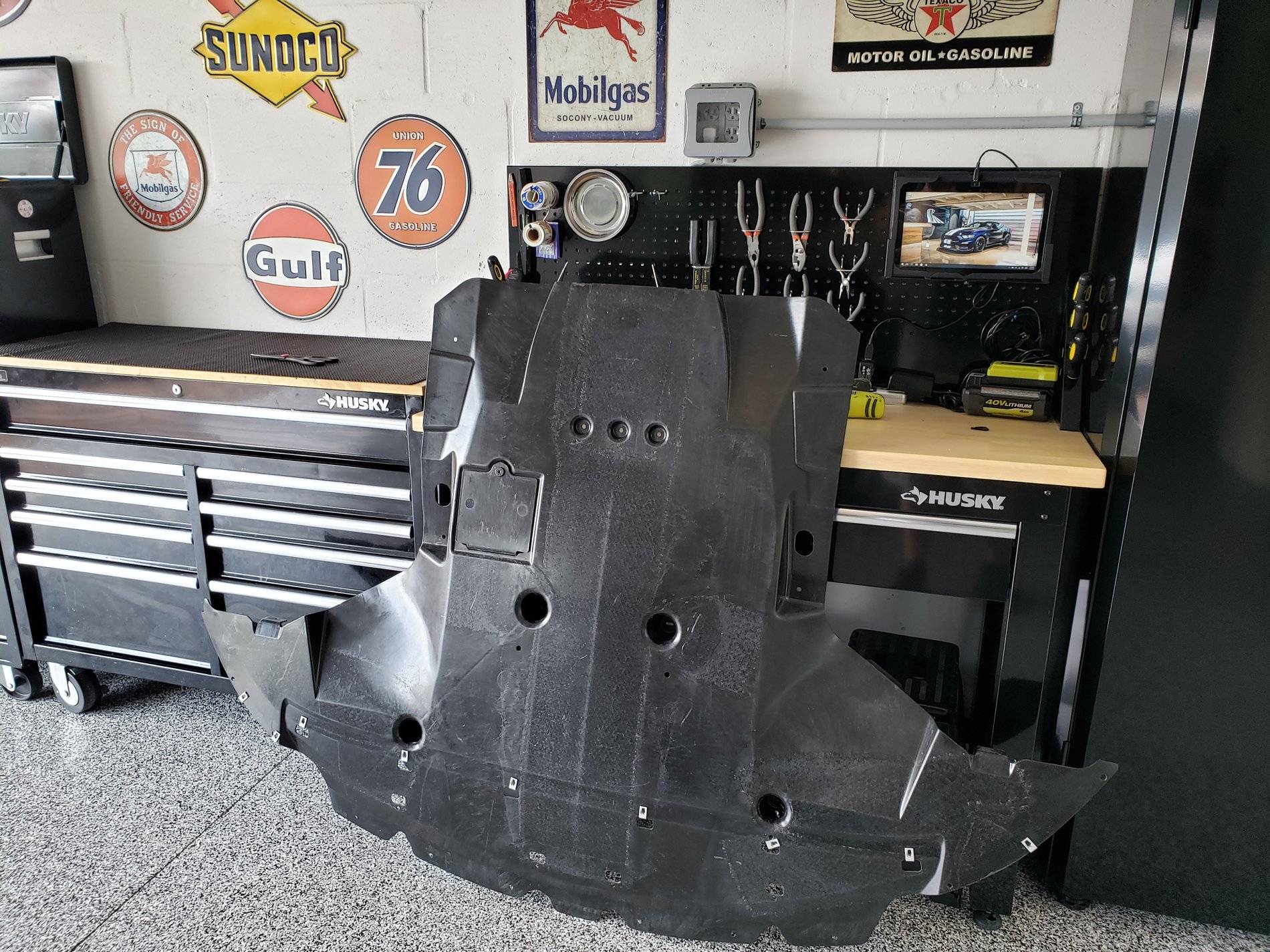

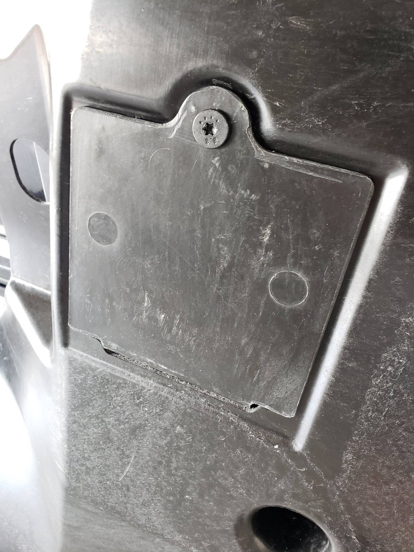

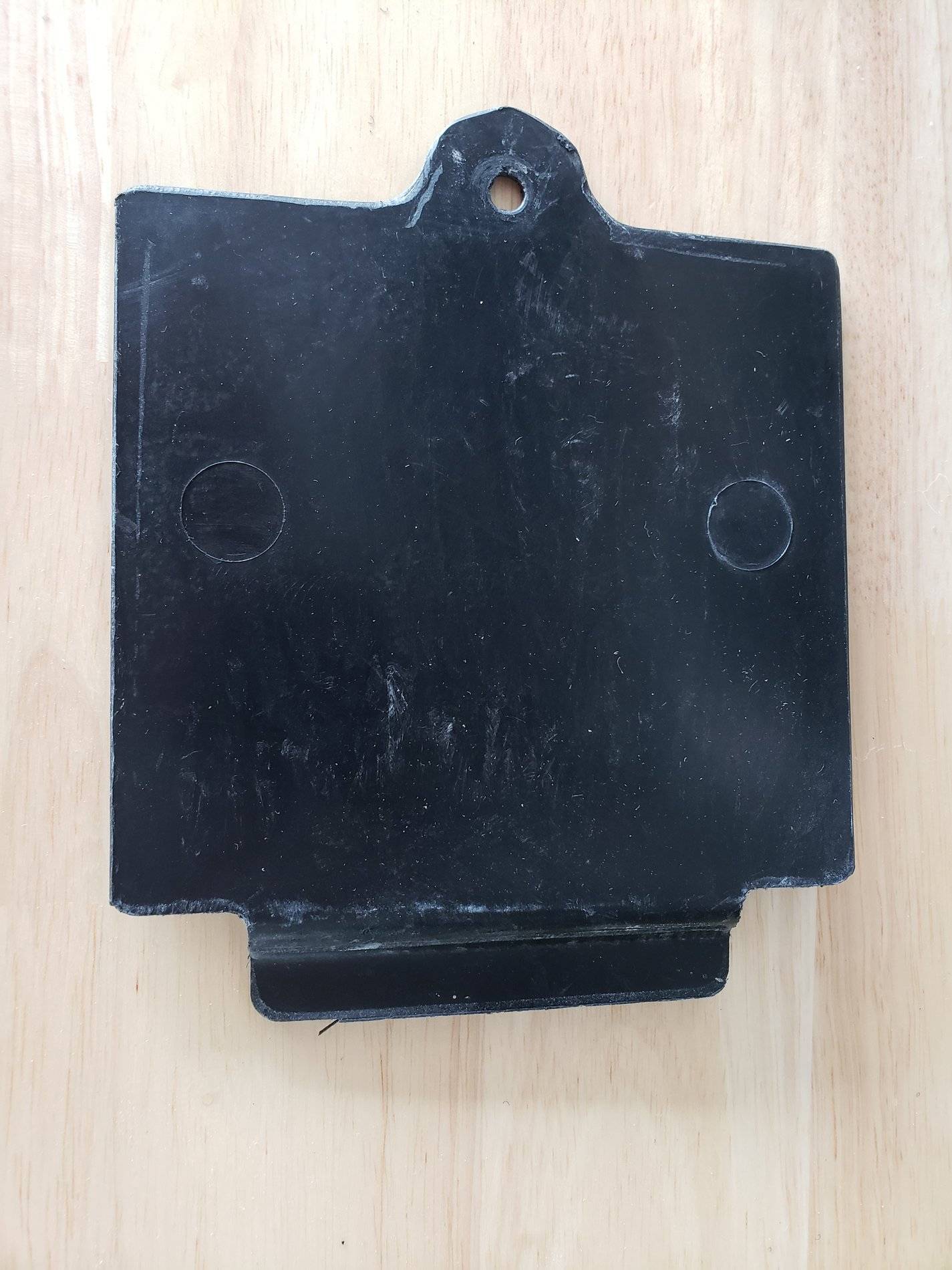

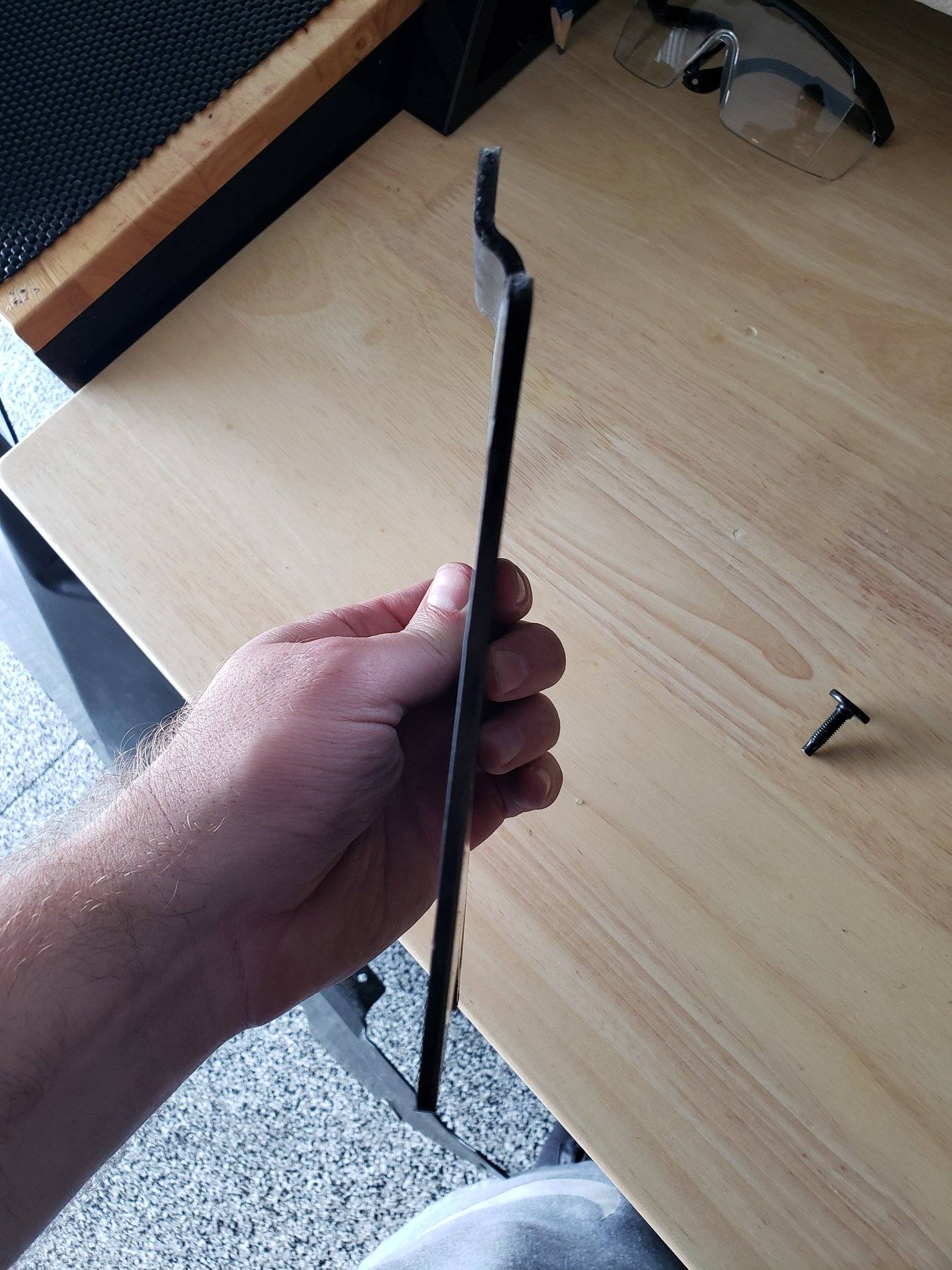

Okay folks so after 2 months and $500 Tasca Parts finally got this to me. I'll be looking for a company to 3D print this little access door to get price quotes. So far I had $70/scan the item quoted plus the cost to print. Figure I'm in it now for at least $570++ so I'm gonna gave to sell a shitload of these....

As others have said, have it scanned and 3D printed, or take it to a local machine shop And have them make you one out of aluminum or tin.

Is that supposed to be a new pan? Looks beat up to me.

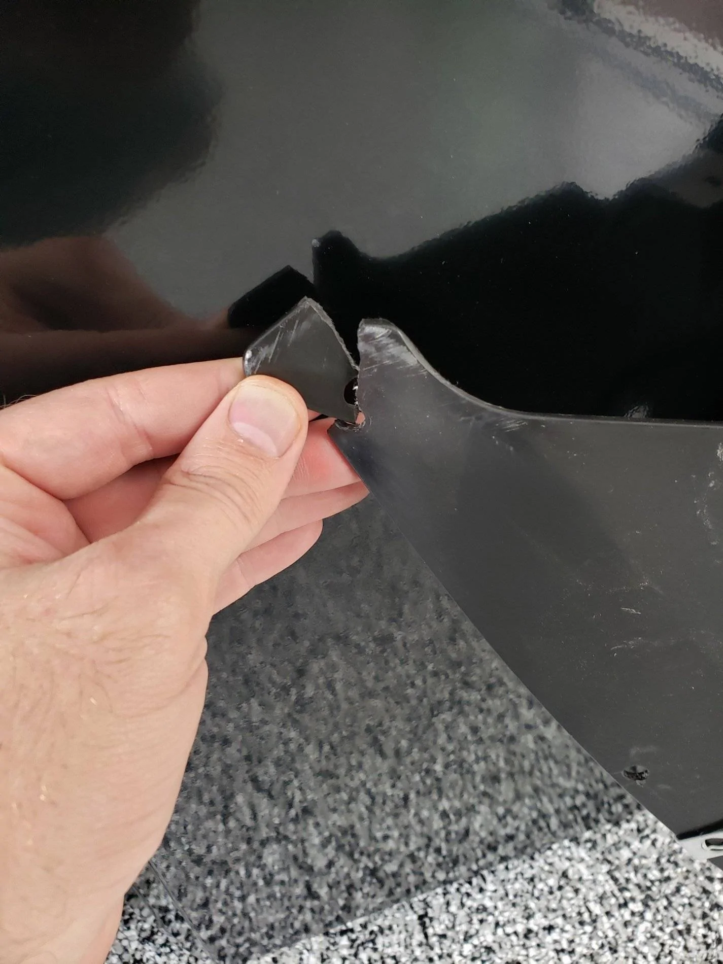

Tasca parts is actually sending me a replacement. That one got mauled in transit. They didn't even ship it in a box!

You shouldn't have to scan the door. This would be a pretty simple exercise in CAD. For production, you could water jet or laser cut aluminum plate and then a quick bend on the brake and it'd be done. Hard coat anodize or powder coat and it'd be ready for service.
