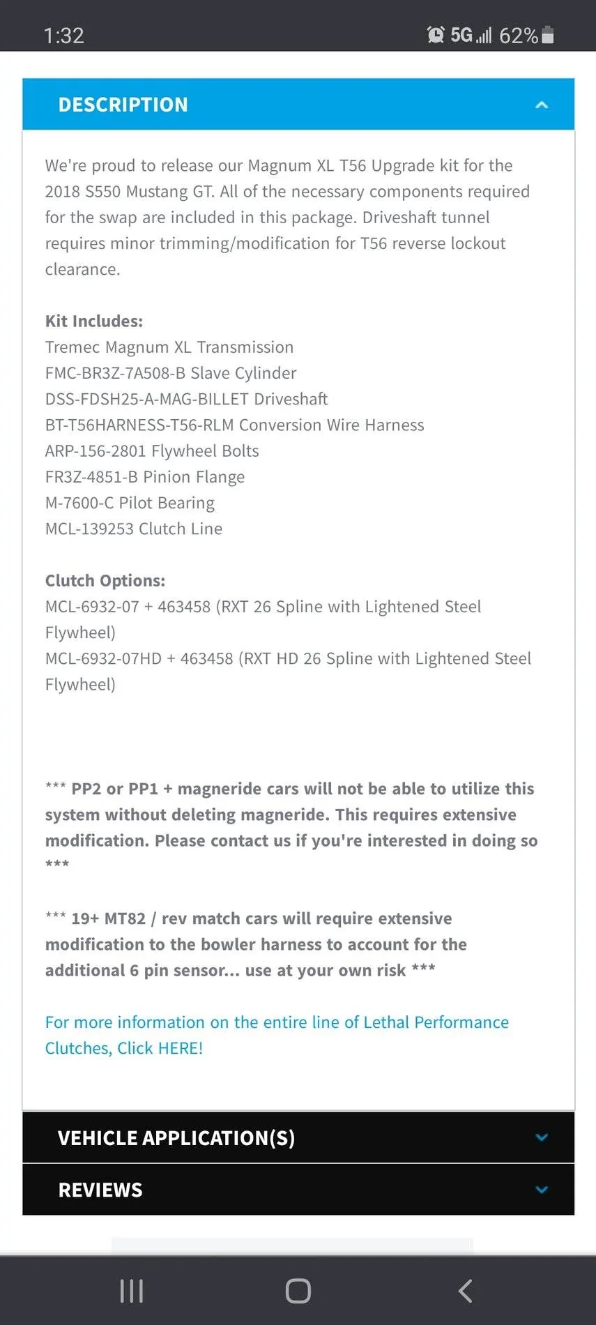

Yeah, I know. I was reffering to the link that was posted on the calimer trans they only have 15 to 17 versions. I need the d4. I already called Ben and he doesn't have any 18 and up cores in stock. Does anybody know how to modify the bowler harness that comes with the t56 swap kit from lethal? There is a disclaimer saying that basically your on your own to get the rev matching part to work

Here's off the lethal site:

This makes absolutely no sense. I'm desperate to hear why 18+ owners would have to delete Magneride if they want a T56 trans.
*** PP2 or PP1 + magneride cars will not be able to utilize this system without deleting magneride. This requires extensive modification. Please contact us if you're interested in doing so ***

I believe that the active exhaust magnaride and reverse match would all not work if that electrical connection on the back of the trans wasn't hooked up. If it was plug and play with no codes I would definitely go t56 but seems like right now nobody has that figured out.
