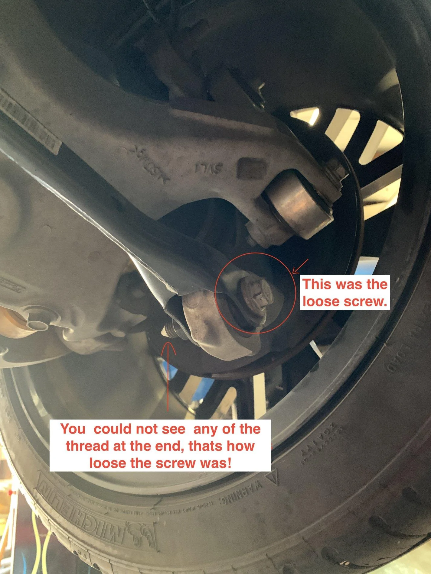

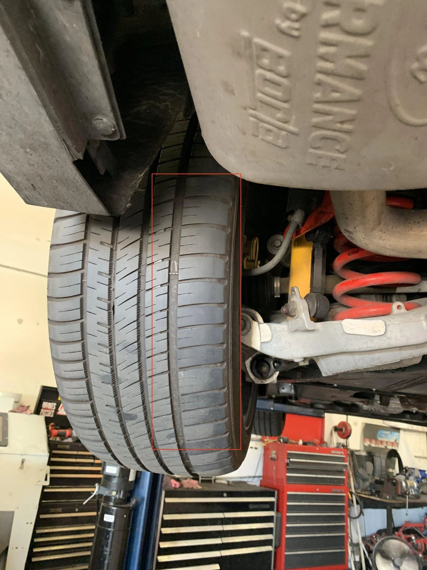

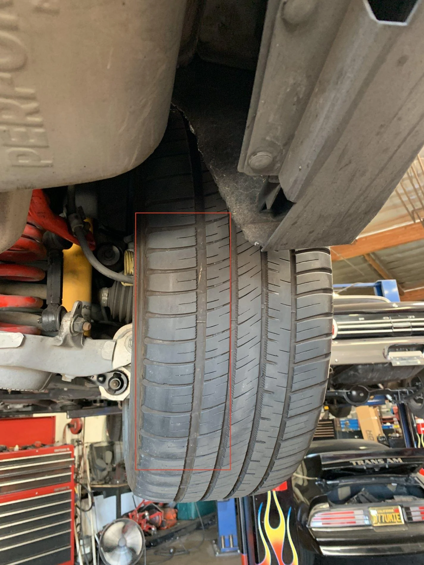

Aright peeps, took it to a different shop. These dudes were cool, and seemed knowledgeable, but who the heck knows!
But they were welcoming, and let me inspect the car with them right off the bat. I dove the car myself onto the lift, and we all looked under at the same time... and holy crap..
First off, the bolt for left rear control arm was pretty much about to come off. The tech said, he believes this was a mistake and that someone forgot to screw this back on properly (he did not believe it could have happened on its own, especially since the right side was good, and yes he was awake of Fords having one time screws, and their issues).
Not a few moments after that, in an expletive manner, they asked who the F*** did your alignment lol
The tires were worn only from the inside, and it was so bad only the inner side of the tires were warm, the outside was cool to the point where basically it showed no sign of use (I had driven about 70 miles from work to the shop).
These guys don't do alignments themselves, but have a shop that does. Monday were going to correct the alignment., and in the process they are going to check for other things just in case. I will keep you all posted, and any further alignment suggestions than was has been suggested already, please let me know..
