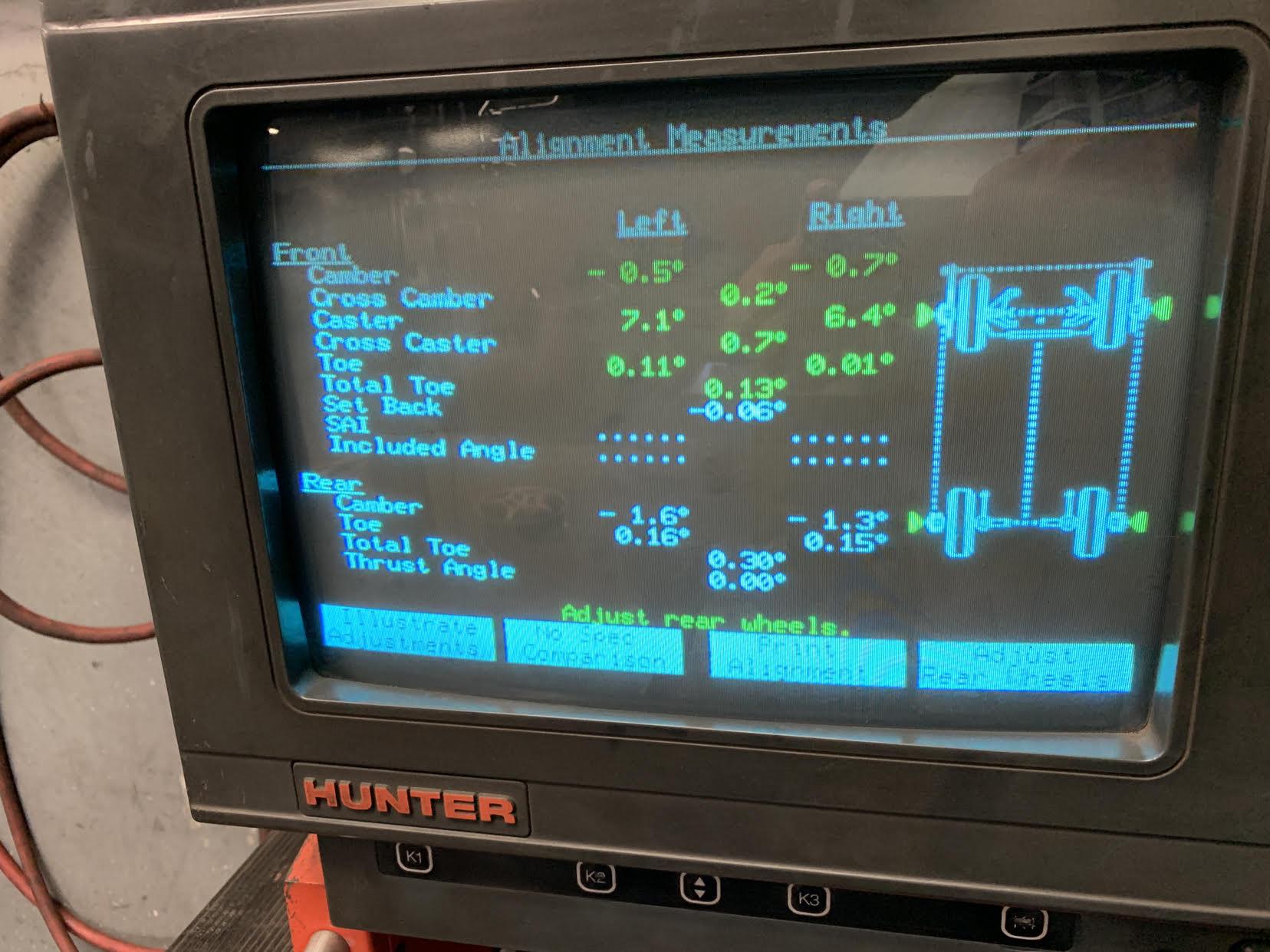

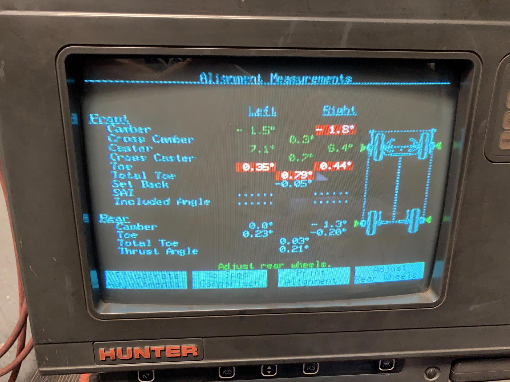

Alright Folks! We are in much better shape, but there may be room for improvement. I am hesitant though, to mess with anything lol. Thanks to everyone for their help! But a special shutout to @Dr. Norts for specifically pointing out that some may not know how to adjust the camber adjustment in the rear on our vehicles,
Long story short, the new alignment guy (who was really cool btw) said he was unable to adjust the camber in the rear, and that I may need something to help with that. I immediately thought maybe I do need adjustable toe-links... but then I remember Dr. Norts comments. So I told him to hold tight, and did some research online, and lo and behold, this is a known thing with our cars, most folks don't know where the bolt is. Once I nudged him the right direction (found a great thread on here with actual Ford manuals), I think he was more ecstatic than I was lol, and got it going. In his defense, he had a catalog he references, and showed him nothing for our cars. Also another big lessons learned for me was to hang out there the whole time, while he was working on it. It helped immensely.
Onto the results, much bigger improvement, but do the front still need to be aligned even more? BMR's suggestion is a little different than what he set me up with for the fronts. He told me BMR's suggestion is good, but aggressive, and more suited for the track.
Before:
After:
