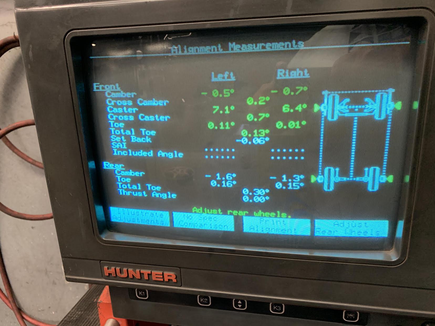

As for the Alignment, this is my current read out:
Looks like the fronts really need to be adjusted. I think this is the first time I am going to try out (adjust the alignment). I showed him the BMR specs, and he told me he thought that was too aggressive. Im going go back to him.

So took it in for an Alignment, got it much closer to the BMR recommended specs. Steering has gotten a lot better. There is still some play, but not as bad. Now whats bothering me even more, is this (having a hard time explaining) soft/bouncy feel of the car. I just don't feel like I have full control.
