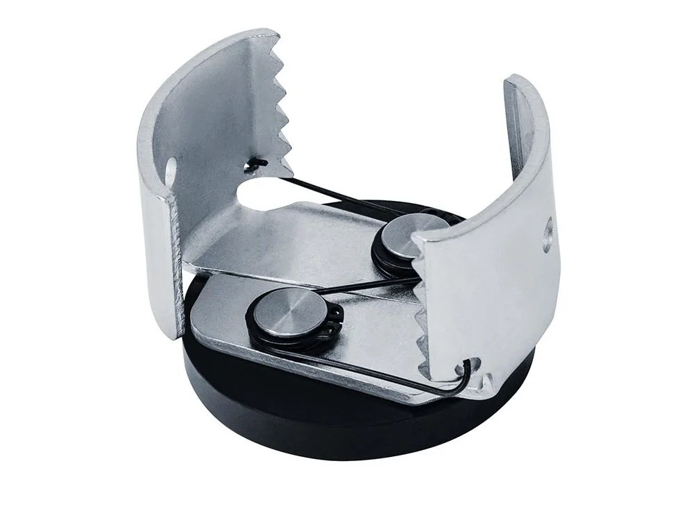

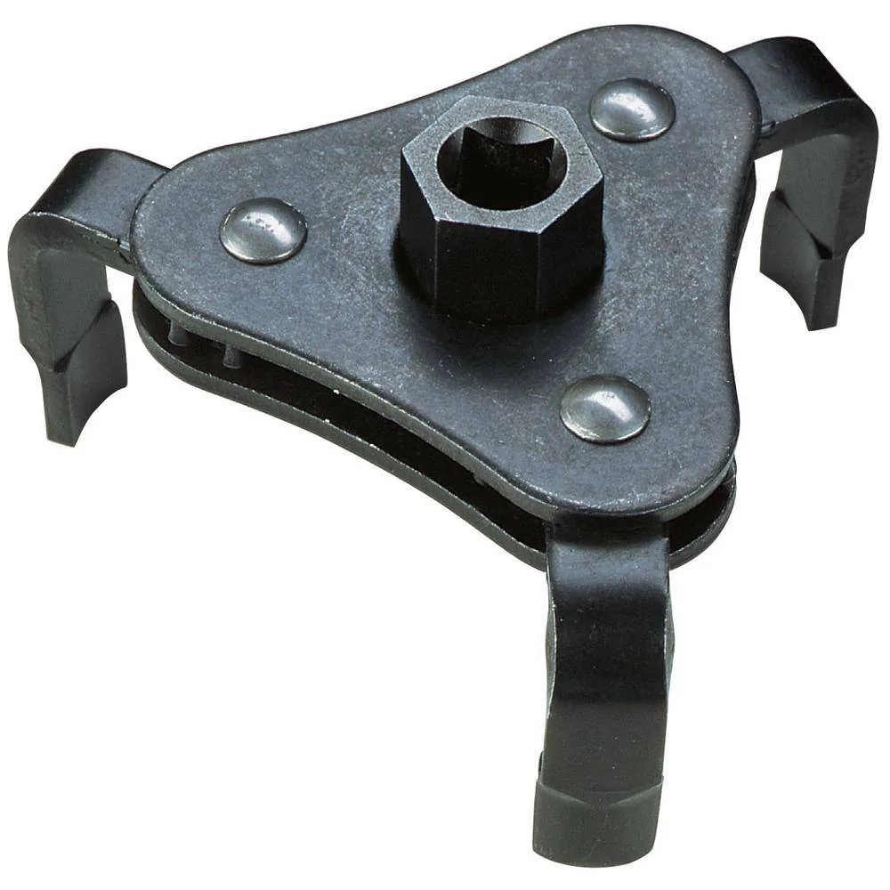

Go to autozone and get something like this for 3 dollars.

I already ordered the Lisle 61650 thru Amazon the other day, since I want to change the oil now (just shy of 1K miles). It should arrive Sunday. It should work fine. But thank you for posting those 2 other options above. I've seen the first one before, and for some reason, doesn't look too effective to me. But the last one looks interesting, and should definitely get the job done... although probably making a mess. Ha ha.

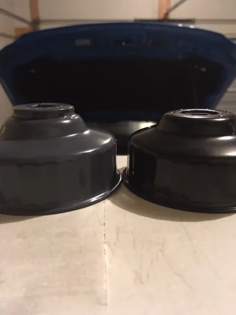

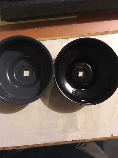

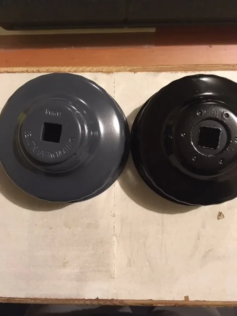

Here is a quick comparison. Steelman on the right, Lisle on the left. You can see that Lisle puts the wrench plate on the outside of the unit which extends the length a bit compared to the Steelman. Steelman puts the wrench plate on the inside. Both are based on the same design of 76mm with 30 flutes. The fit is snug on both units. I prefer the Steelman for the more flush fit and ease of getting a wrench attached, can be purchased direct here:
Interesting; thank you. My Lisle should be here tomorrow. Didn't know about those differences, but I agree with you the Steelman design is better; hope the longer Lisle is not an issue with my car. Both seem to have the same 6 tack welds, which I hope are strong enough. The factory filter is usually tightened to hell and back, so once it makes it with that, future ones should be cake.
