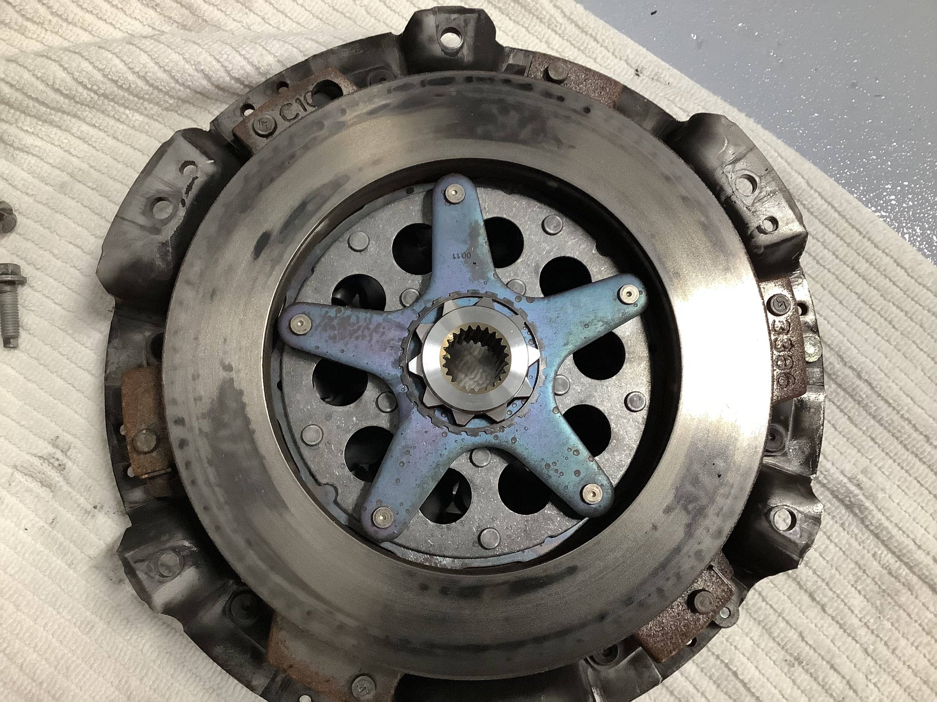

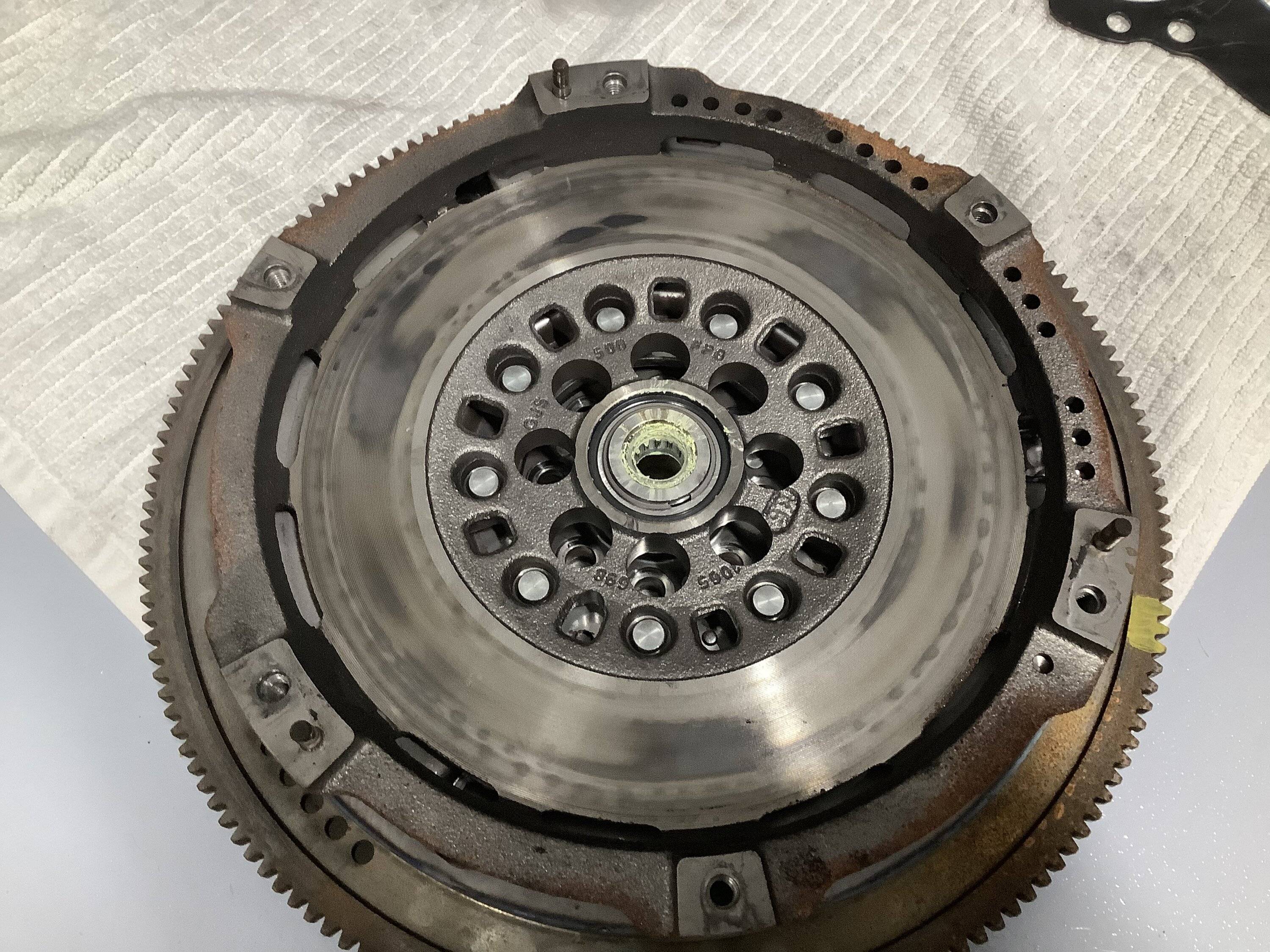

I am curious as to what condition your clutch and flywheel assembly were in? I remove the outer clutch plate to see what it looked like underneath and here’s what mine looked like at 6K miles.

No where near that and I had 12k on mine. I’ll try and dig up a picture
