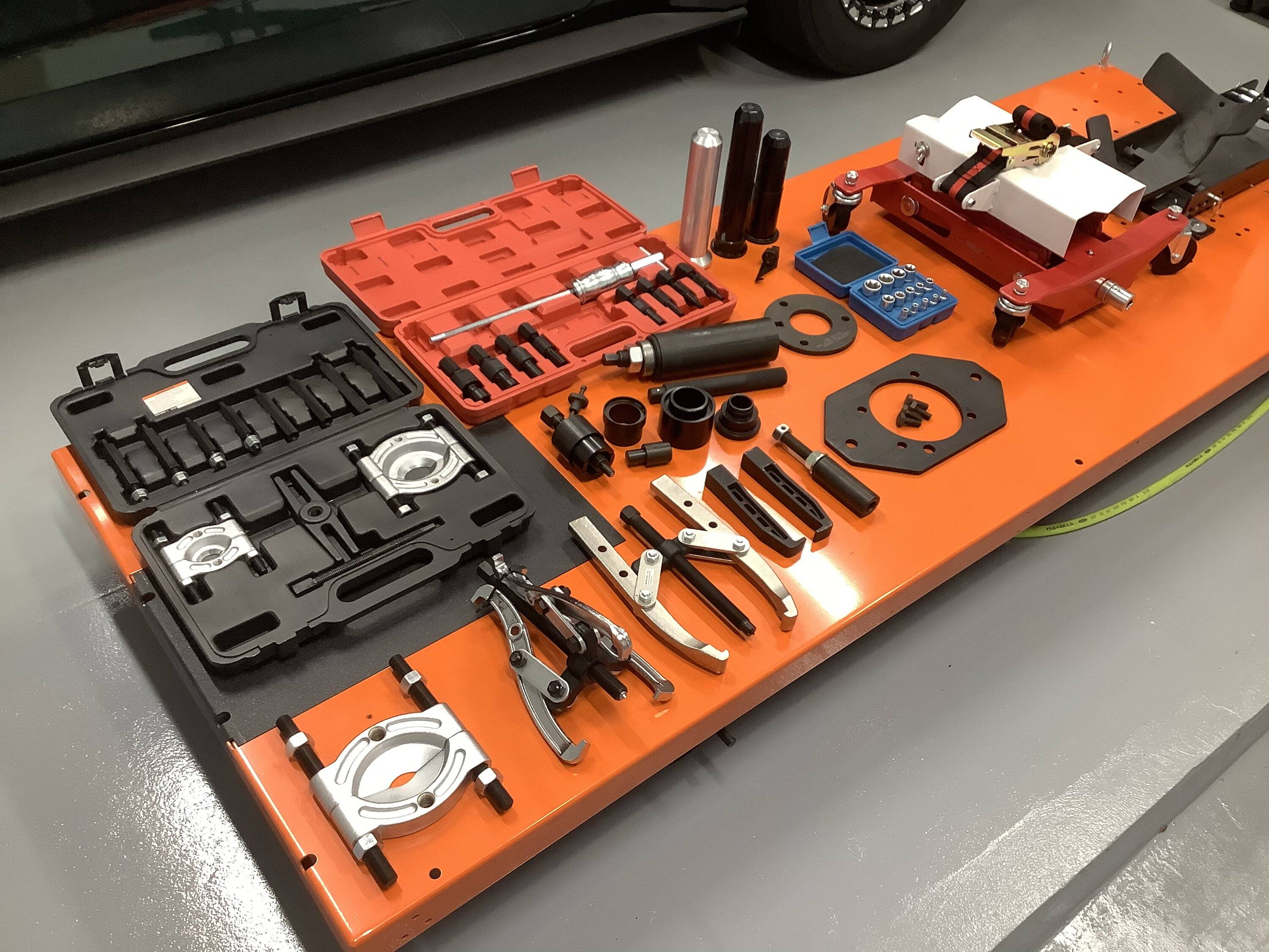

Is there anyone here that has handled their own MT82-D4 transmission rebuild? I will have to pull mine at some point and would like to obtain a list of required tools with part numbers to help facilitate a complete disassembly and reassembly. Any help provided will be greatly appreciated. Thank you!

I’ve found and ordered a few tools already and will continue to collect whatever I need to do a teardown and rebuild.

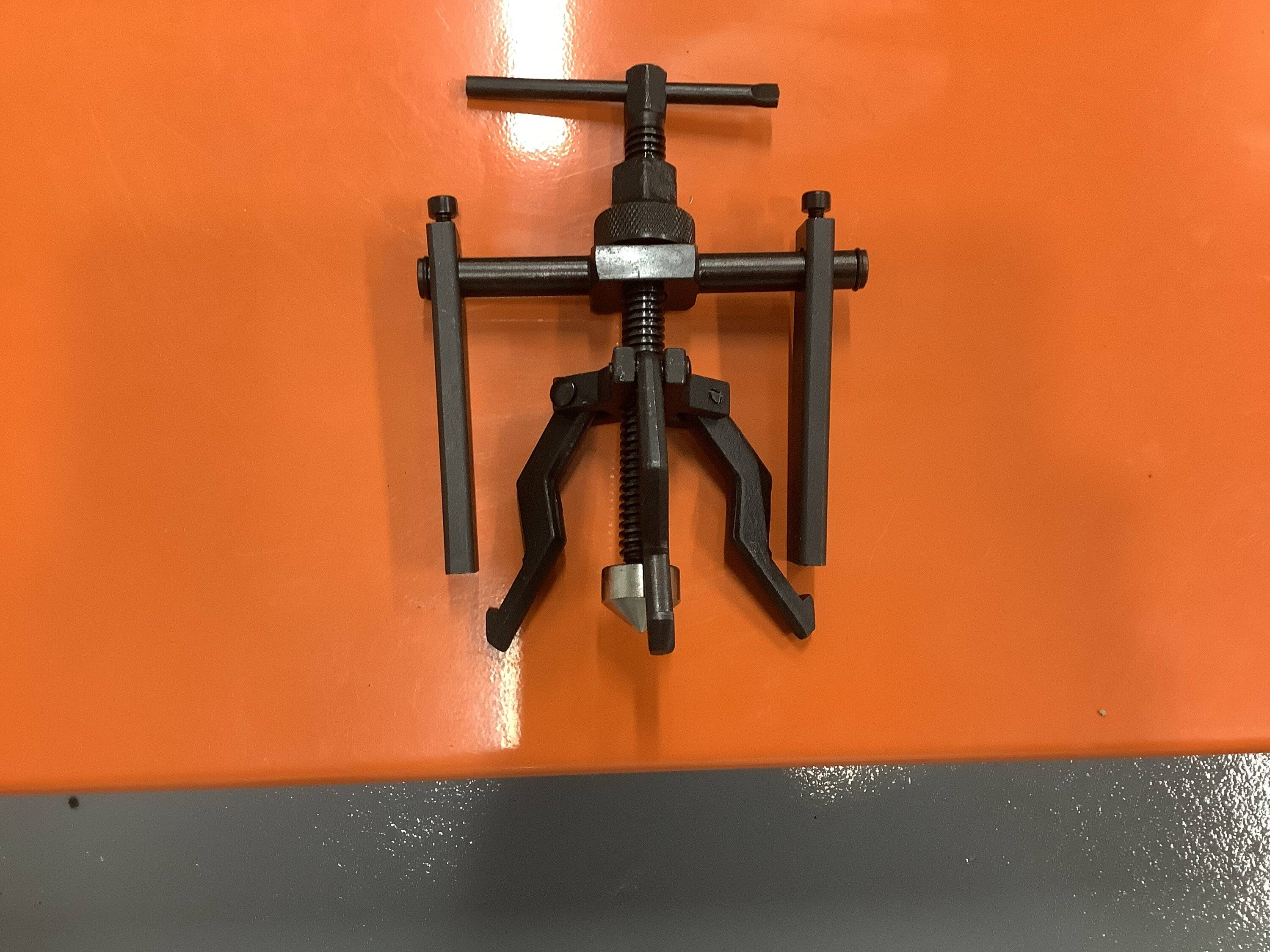

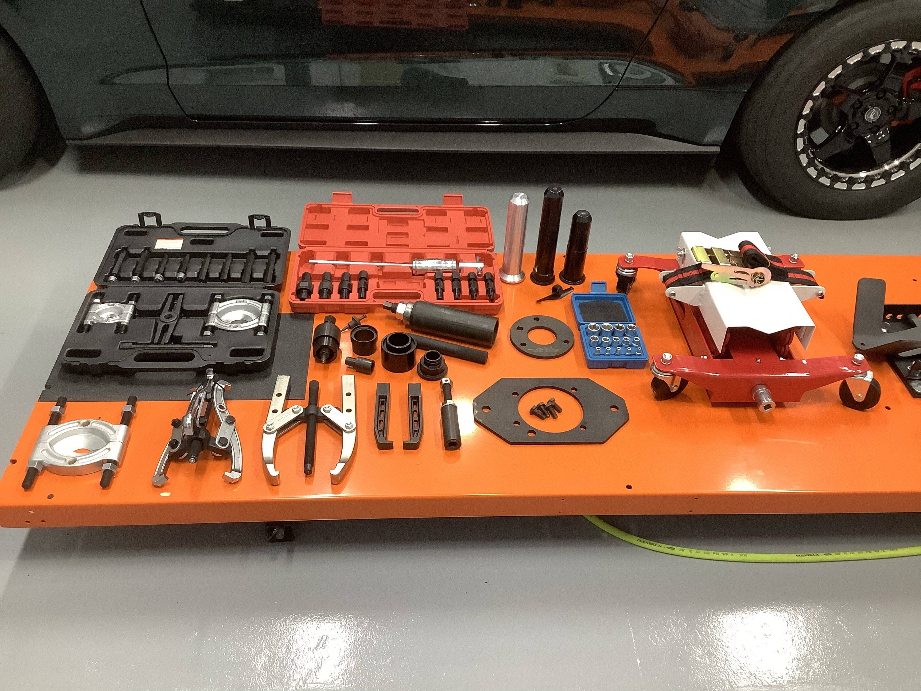

I now have all of the tools in hand, except for three that are on the way (2 jaw puller with a 15 3/4” reach for splitting the case, another slide hammer and a bearing/seal install kit).

It sure looks like you are doing it right! :) There's not much worse than getting deep into the job and finding you are missing that one special tool. Please keep posting your experiences with this, I may find myself doing it one day. :)

@boB, I’ll definitely document my experience with delving into the MT82-D4.
