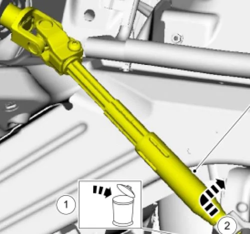

I just put on a set of long tubes and want some more clearance from the steering column shaft and the number 6 pipe on the headers. If i put a 1/2" spacer under the engine mount brackets to the engine mount it seems to work, but it takes away almost all the top nut threads and i don't want to have the motor up another 1/2 (if anything would like to lower) The engine is already slid over on the mounts to the passenger side so i have no more room in that direction. This said looking at the steering column shaft if it was actually reversed (with thick side up top) it could possible work, but it can't be reversed. Does anyone know if there is an aftermarket steering column shaft available for the 2019 s550? I can't seem to find any anywhere. Also does anyone know why the shaft is collapsible other than to make install easier? Thank you for any thoughts you may have.

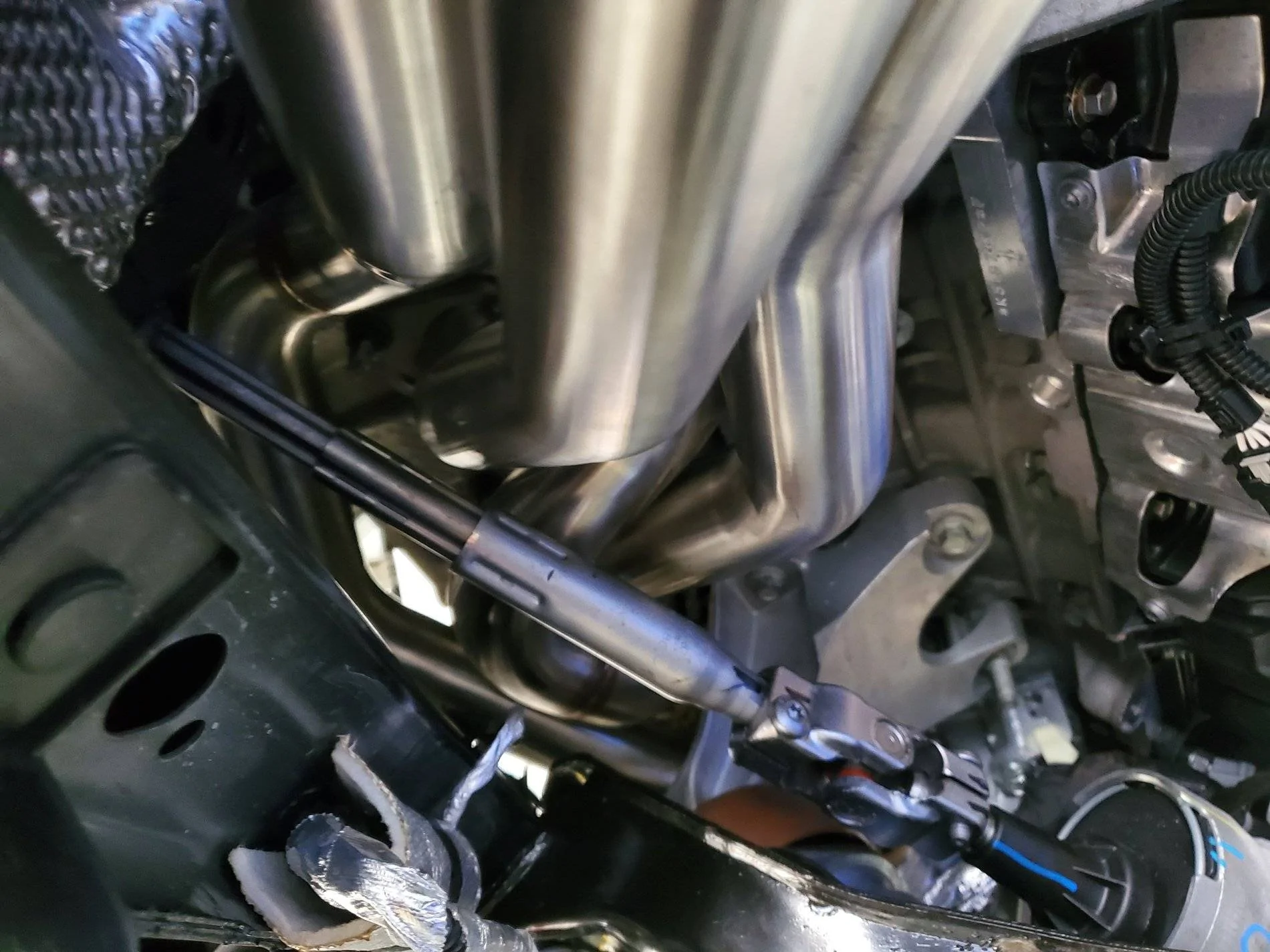

They are 2M. They are nice and everything went in without issue. Once I lowered the motor back down is when I noticed it. The steering turns, but it is right on the shaft. Now in 2019 Ford changed the AC lines so the passenger side is right at the ac block. If it was a 2015 it would not have been an issue. Having done a 2015 and now a 2019 header install I now know this. So if I put in lowering mounts it may put the header below the ac block allowing me to shift the motor over to the passenger side thereby giving more clearance to shaft. So I just need to figure out best path to take.

I just put some heat to the same tube and dimpled it in the area I needed some more clearance. It won't effect performance any.

I had considered doing that as well. Just trying to see all peoples thoughts as well as seeing if a custom shaft existed. The stock collapsible one is WAY larger than it needs to be.

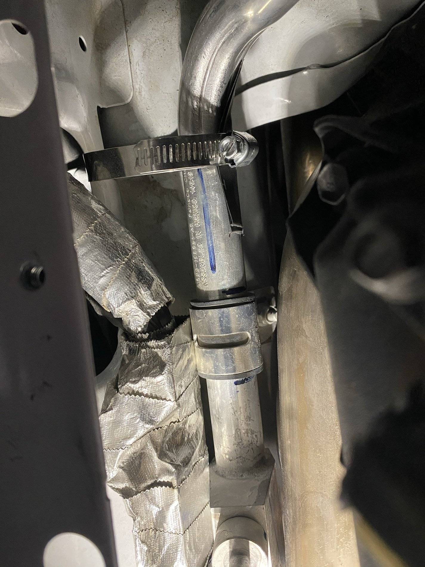

There was a Facebook post not too long ago that had lots of people chiming in. From what I gather, if its the "Lone Star" style headers from 2M, then you will have clearance issues with the steering shaft. They sell another set that is a Stainless Works replica that apparently does not have this issue.
What I did is dimple the drivers side where it hit the steering shaft. I. then loosened the bolt holding the AC line and used a hose clamp to pull the line away from the header. Theres a slot in the frame rail that fit the hose clamp perfectly. Seems to have worked for me. Doesn't touch anywhere or rattle like it did before.

The steering shaft is collapsible for safety reasons. It allows the front of the car to be able to crumple and not force the steering wheel into the driver. The situation with your headers sucks, good luck with getting them to work.

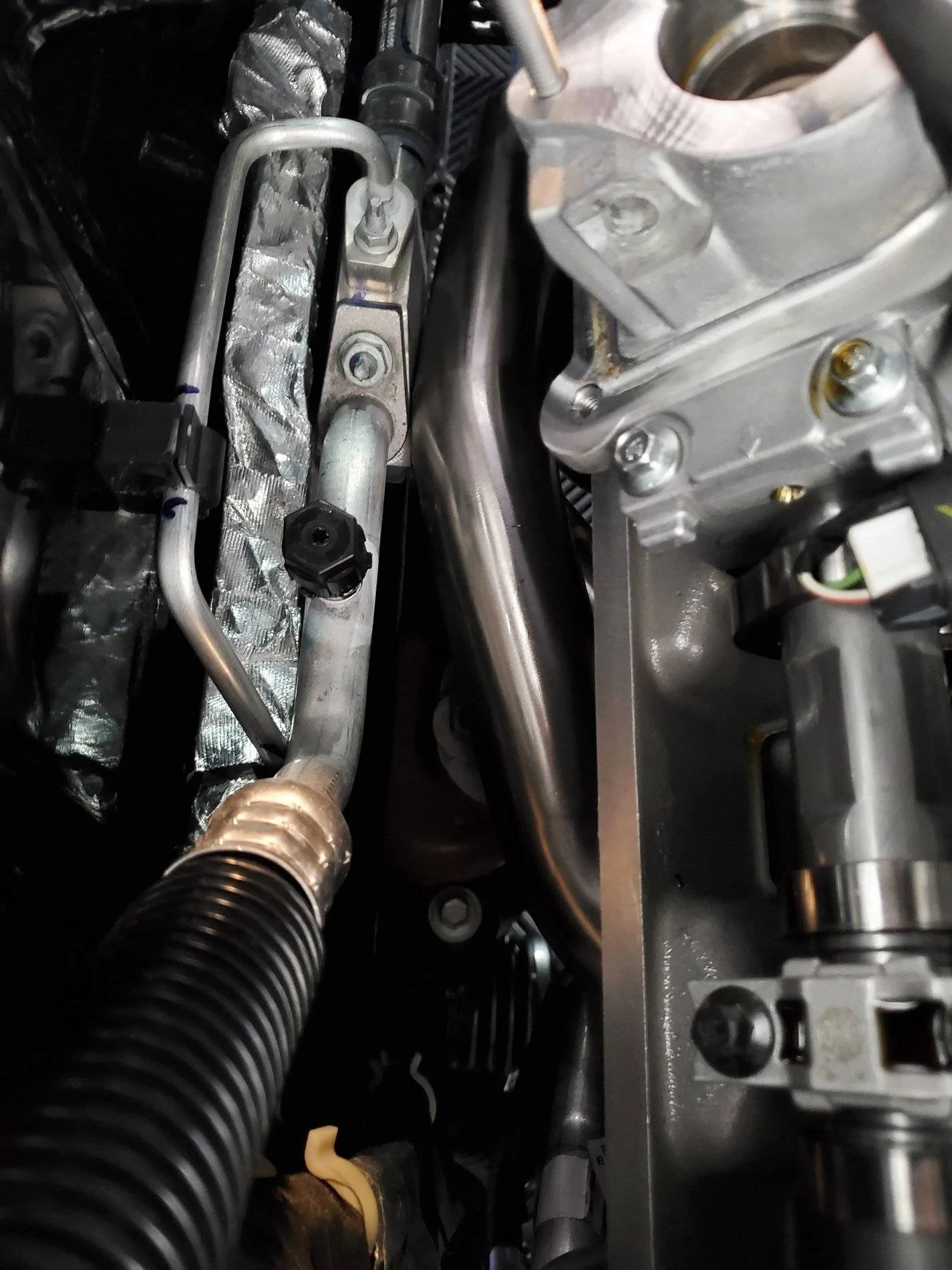

sabtaj1
Sep 11, 2019
31
1,157
1,340
Bettendorf, IA
Jason
2019 PP1 Mustang GT, 1965 Fairlane 500 wagon
