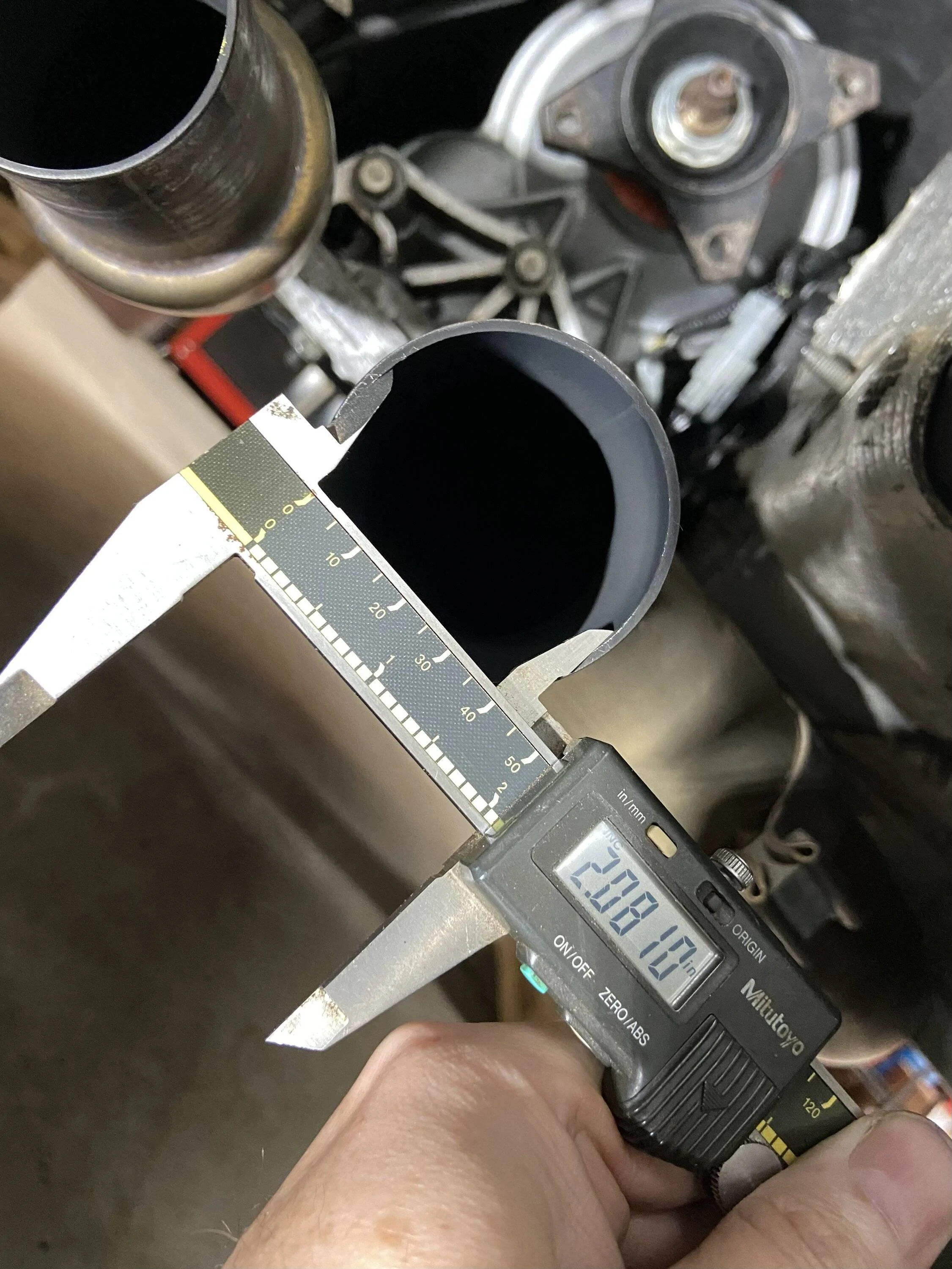

Kooks and ARH are the top. Factory connection is necked down yes, but isn’t really a worrisome bottleneck unless you’re in the 1000whp+ range.
Here’s my necked down measurement.
It was surprising, but the power amount and curve at RPM is still where it should be.
