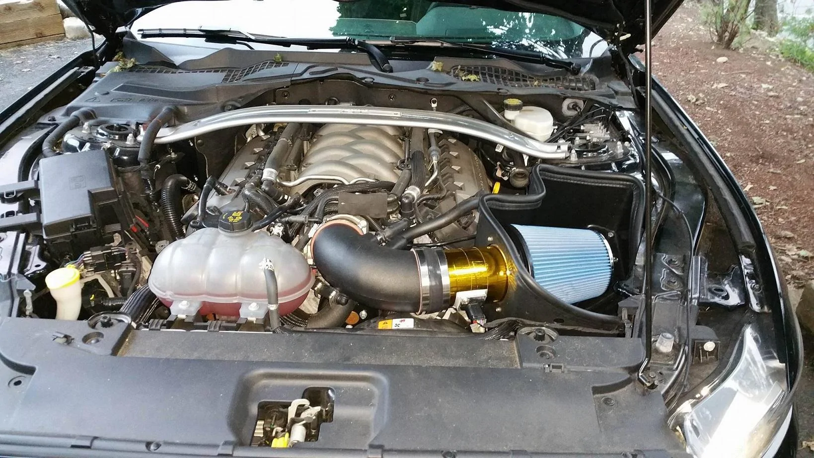

Well, didn't notice any change while driving. I did notice a 3c-4c (roughly 7f) drop while stopped. Not a huge amount, but an amount none the less. I think wrapping the intake tube will help (as per mentioned earlier).
On a side note, the airbox itself ( where it's wrapped ) is much cooler then the intake tube. Cheers.

Blankie :D Will test tomorrow.

Good idea wrapping that tube and still having an open filter.

I only wrapped the metal portion of my intake, seems kind of pointless to wrap the whole thing especially plastic.
Looks nice and clean besides the odd color of the wrap compared to the rest of the engine bay.

Well thermowrap never looks purdy eh :D
Makes a difference though. Cut the IAT 10c or so everywhere. :thumbsup:
Your results may vary :lol:

Wrapped the parts of the factory air intake tube closest to heat sources with Heatshield Lava Mat. I'll compare it against our other car when the weather allows.
Oooh that looks a lot better and more subtle than the bright gold wrap, kinda reminds me of carbon fiber.
Would be interested if you notice any difference. Although by wrapping the tube AFTER the MAF, you won't be able to actually measure IAT differences since that measurement is taken at the MAF. So you could lower the temp of the air itself by 10* throughout the tube, but you will never see that when you scan for IAT.
