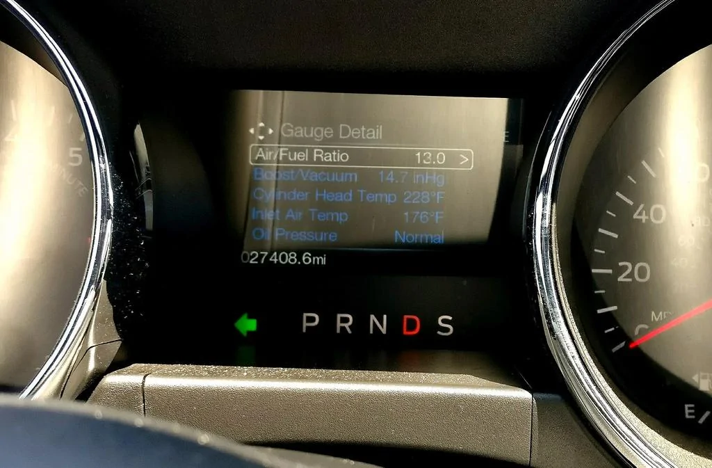

I need to do something for my PMAS "box." I snapped this picture earlier today. Granted, it was 100F and sitting in traffic, but it didn't cool down much when I got up to speed.
Damn. I think my hottest has been 158 here in FL.
