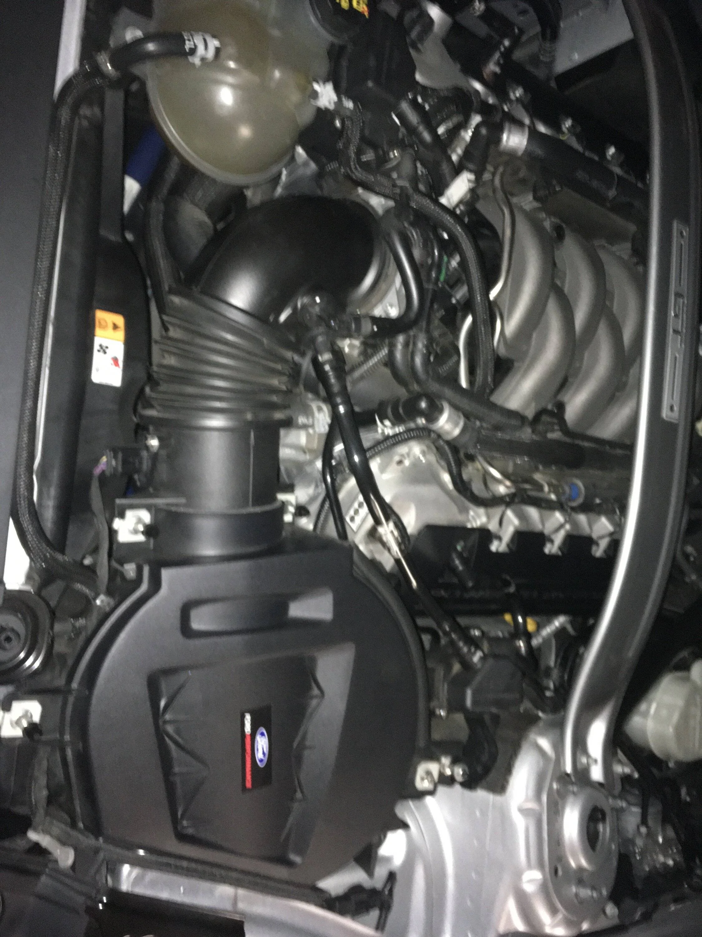

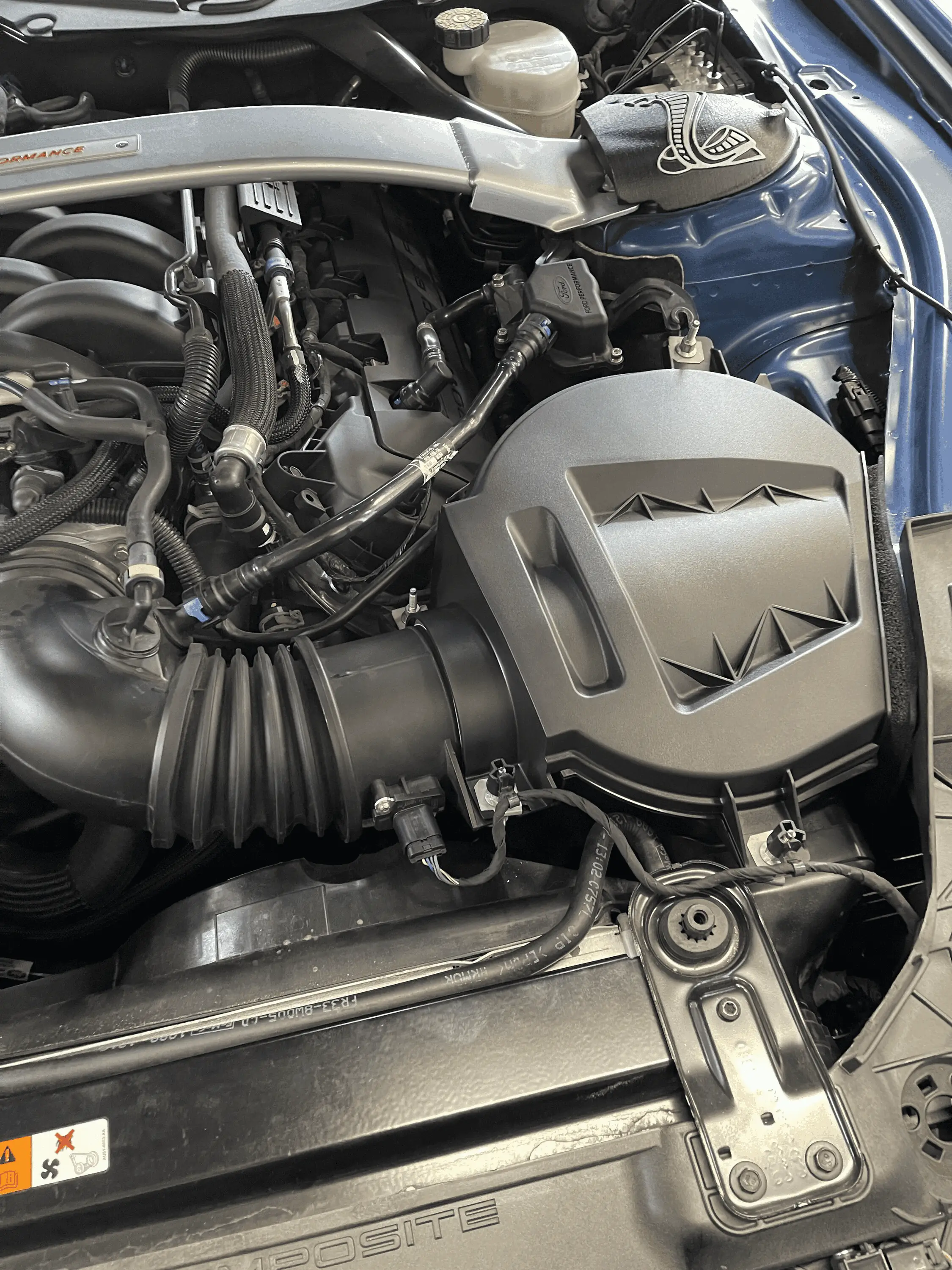

Gt500 top on 350 base.
The only thing you had to purchase was the lid? I. E. The GT500 lid attaches right onto the GT350 box with no additional pieces?
I have what is presumed to be a competely sock GT350 box as was supplied in the Ford Performance Power Pack 2 kit.
