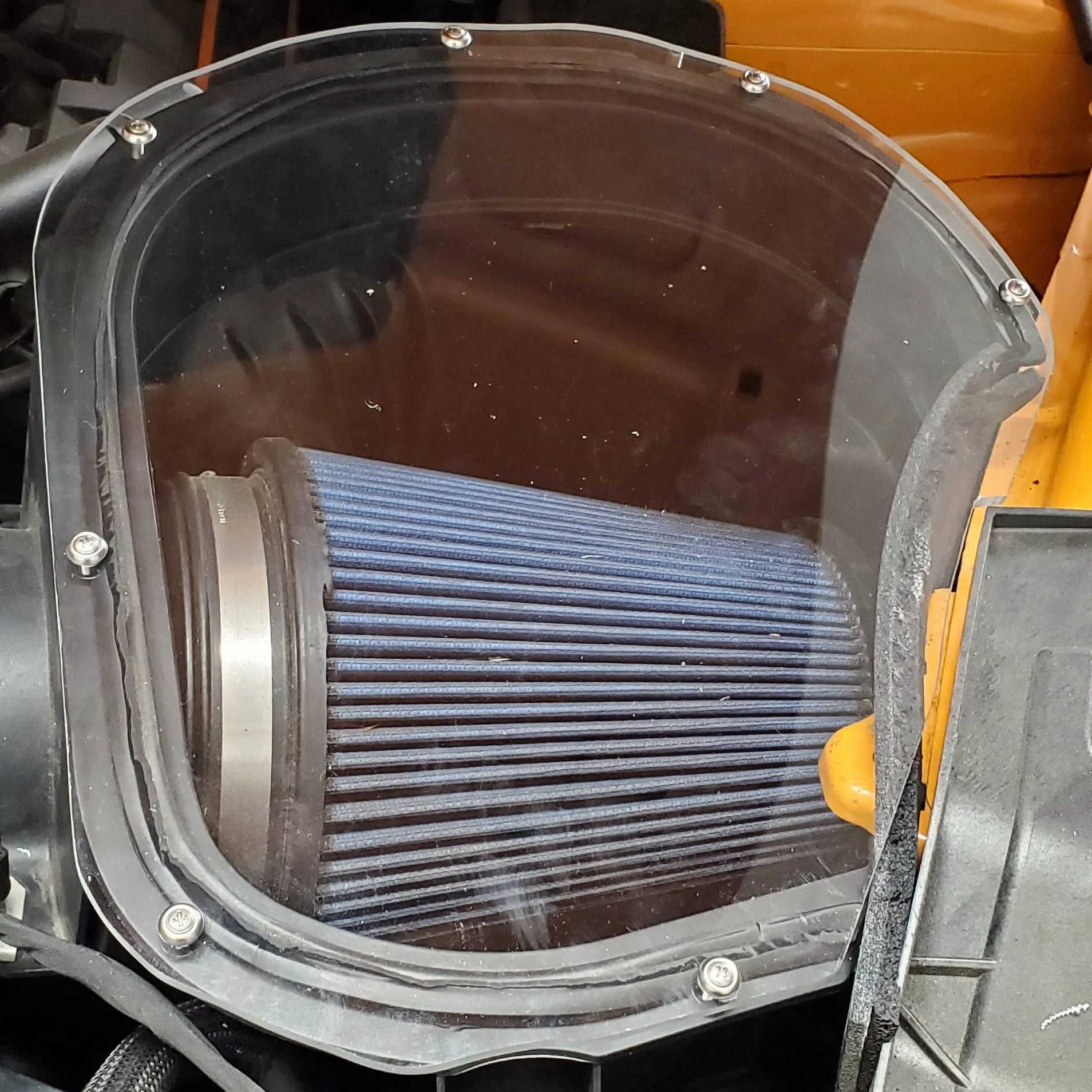

The only thing you had to purchase was the lid? I. E. The GT500 lid attaches right onto the GT350 box with no additional pieces?
I have what is presumed to be a competely sock GT350 box as was supplied in the Ford Performance Power Pack 2 kit.
I also have the pp2 on my car
There are a couple of gaps that you have to seal. I used foam tape and weatherstripping.

Correct. PP1 car here. I installed the GT350 TB/airbox with tune and didn't love the open filter. I got the GT500 airbox with lid and it mates good to the GT350 intake tube. Just fill the connection with weatherstripping like luc mentioned. I also wrapped the back side of the air box with heat tape.
Temps are pretty good and I'm happy.

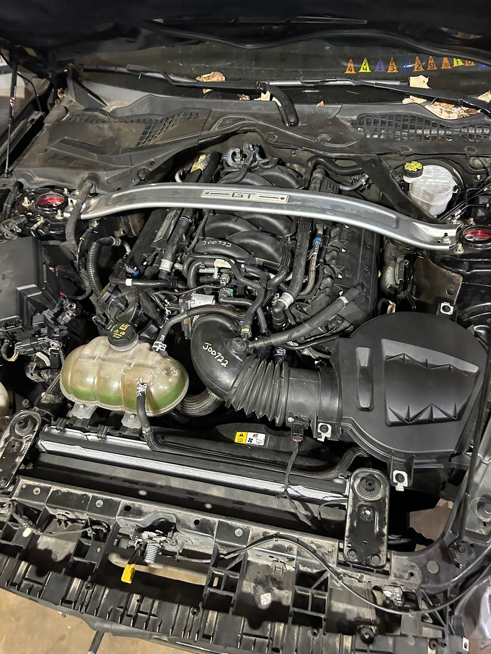

my situation is a little special, I’m putting a Voodoo 5.2 into a GT and it didnt come with any airbox, so the levittown kit killed two birds with one stone. I had to source the shorter snorkel from the grill to the airbox, (the GT part I had was much longer to reach the smaller GT airbox) but you’ll just will reuse the snorkel from your mach 1 airbox when you put in the GT500 part.
In the photo you can kind of see the ground through hole where the snorkel I was missing would be (next to the radiator bracket). I just needed to buy that part separately. One of about 10 little gotchas on this rare swap job.
