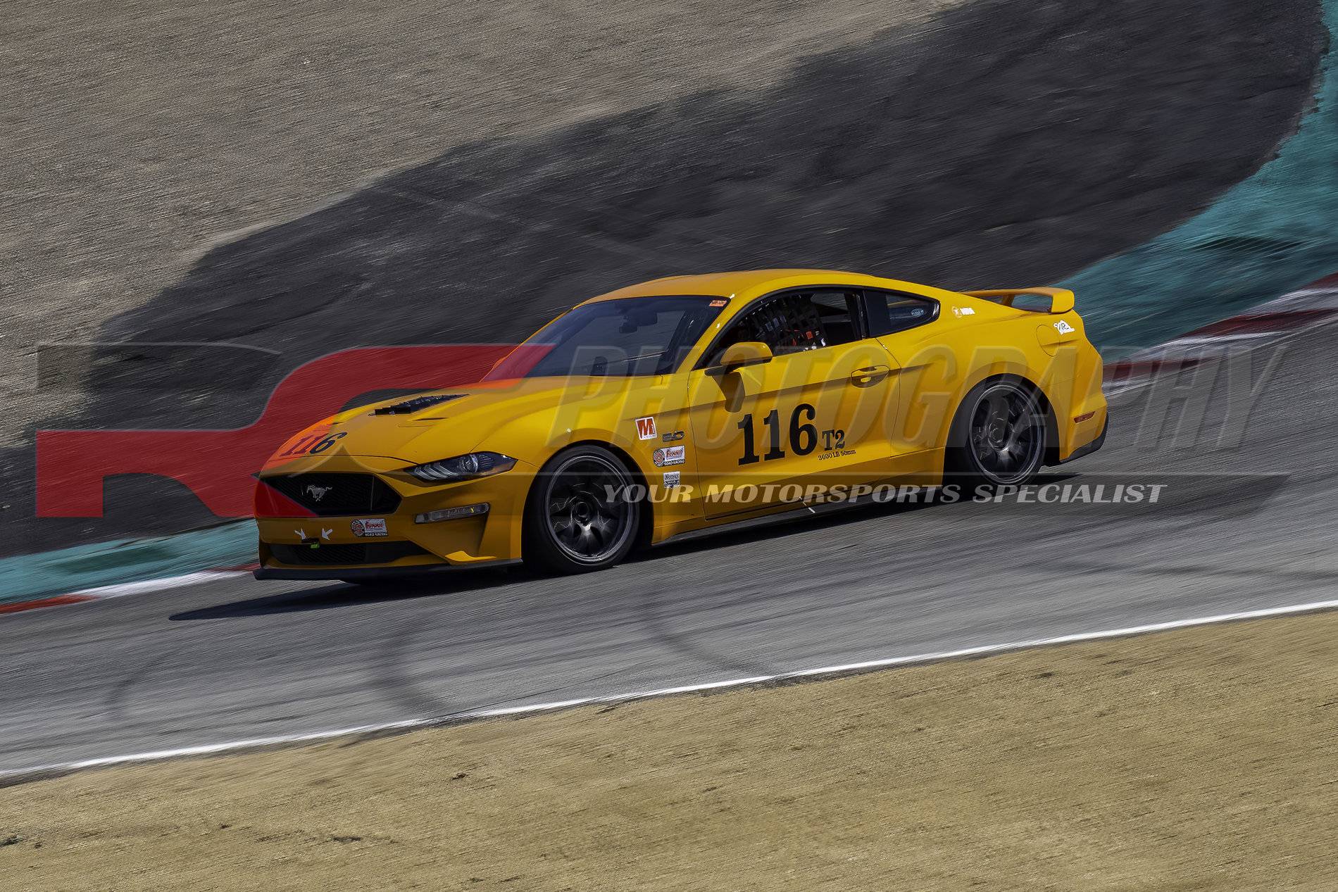

I race a 2019 GT PP1 A10. It isn't a GT350 but developed from a new stock streetcar. I've raced at the highest amateur level for a decade and at lower levels before that. So that's my backround.
When a car starts off as cr@p all the work the driver does is for naught. So you have to have decent starting point. I hear the GT350 is good out of the box. I do not know but the GT is a real POS that is becoming a decent racecar. From stock there was a huge improvement going from PP1 19" street tires/wheels to 18" Dot-R tires/wheels. This provided more grip and lowered the car 1.5" and the smaller overall diameter gave better acceleration. The square set-up took some understeer out of the car built in by Ford.
The next big change came with coilovers. Well damped shocks, additional rideheight lowering now 3.75" when stock was 6.5", heavy springs front 600lb and rear 750lbs on coil not divorced spring. Nose dive was gone and roll in cornering was gone with stock PP1 bars but front debonded. Coils means you can now corner balance the car too and even weight jack for track specific instances. I was skeptical of spring rates way out there from any other manufacturer's rates but dang these springs work! I might even go their heavier spring rates. I might be bottoming these out or close to it.
Finally, I adding in basically the kit you describe locking out the diff, subframe, vertical links, adjustable end links, yada yada but honestly I can' feel any difference and I have not done before and after testing to see if my laptimes are reduced from all these little changes. I think I tend to just drive around issues sort of like what you do when tires start to fall off in a race. Honestly, can anyone really feel the effects of spherical vertical links? Maybe I have an insensitive Butt-o-meter. All these little things like RLCA are supposed to add up and I hope they knock off time. I do not know what the time value of these little mods are but they sure add up to a lot of money to try and fix Ford's dumb suspension design. The 1st 2 mentioned above were like wheels and tires wow different car. The coils... wow different car again. Then all the rest humm....was it really worth it? Well it is supposed to be and should on paper.
