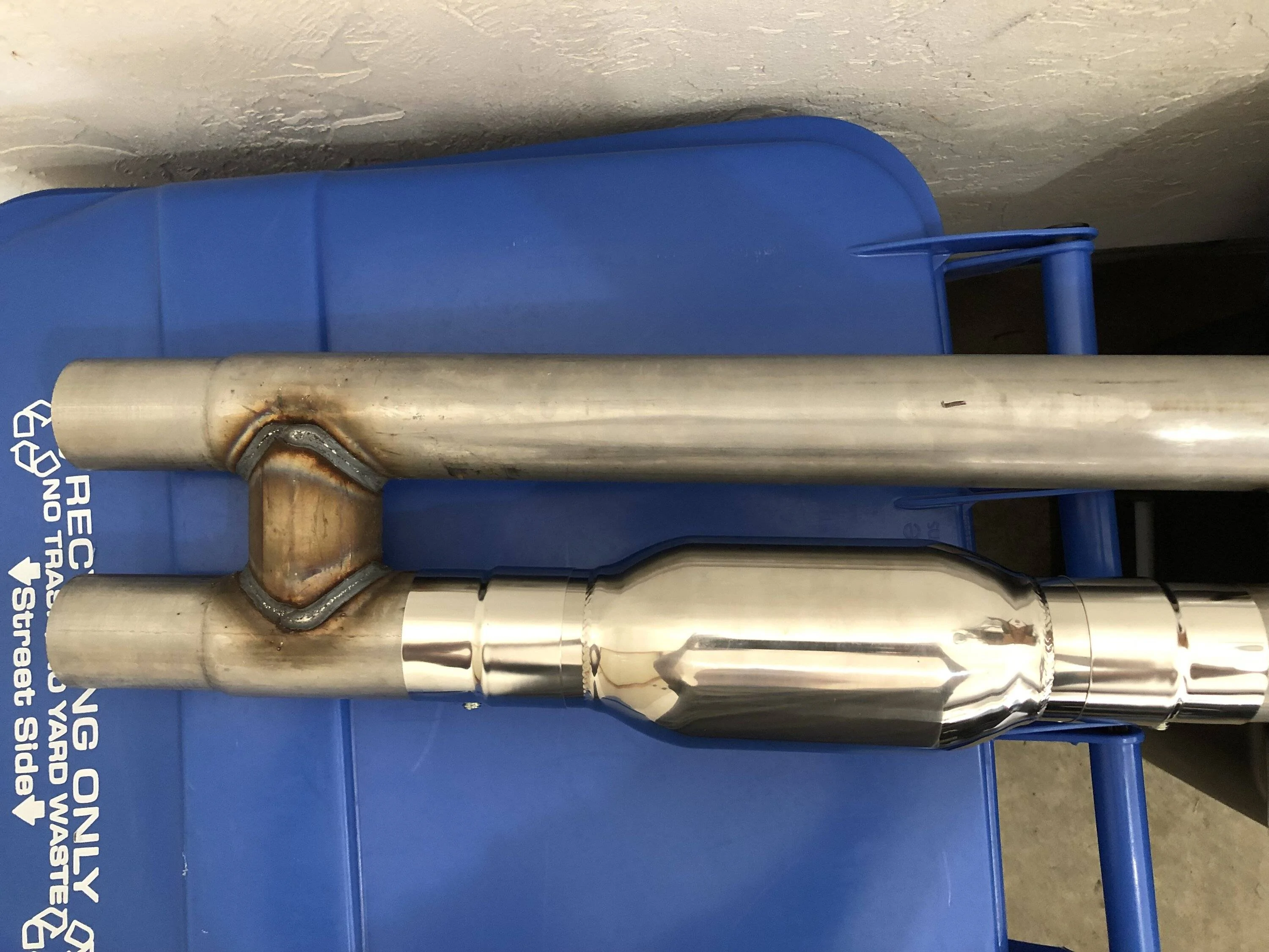

Seems like any X or H will drone around 2K RPM, I hate that "boomy" sound and yes with tinnitus the drone is horrible! My solution... one Vibrant resonator in the drivers side of a Summit H. Still keeps the volume but cuts down on the boom.
Excellent suggestion. I have been searching for a drone solution for my Headers/H-pipe/Borla setup. I love the volume but hate the drone.

I have drone with my MBRP H-pipe and I did the sound tube delete a long time ago. The drone only started after removing the axle-back portion of my MBRP Race setup which had J-pipe resonators built into it (I replaced those with Borla S-type mufflers to cut down on the insane volume after adding headers, and this change helped with the volume but the drone has been an issue ever since). So now Im looking to add a Vibrant resonator to the driver side of the H-pipe as Mikepol2 suggested.
