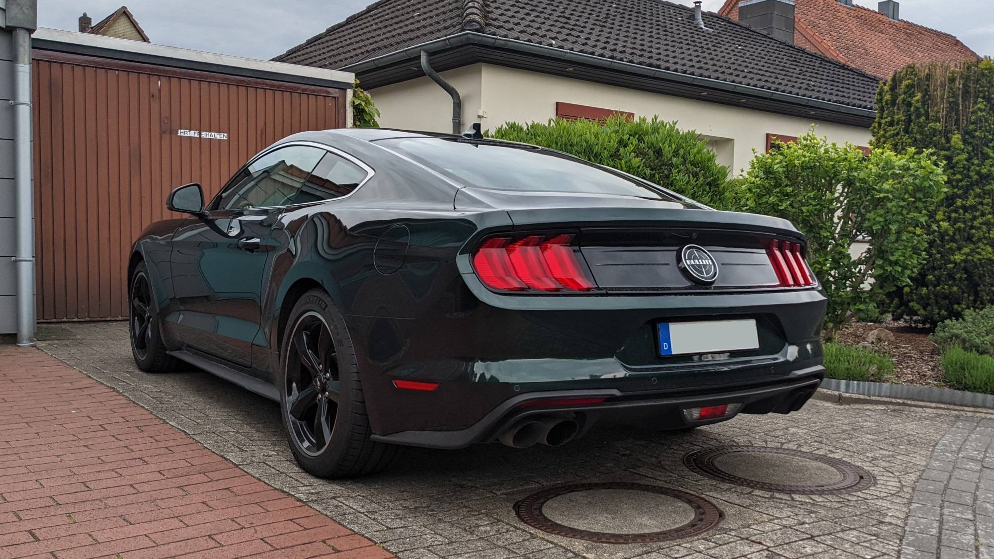

Did it with the EPM 7 mode tail light, purchased from EPM's German partner.
But have problems with digital radio receiving when flashing and braking (interference signal from the lights or their electronics).
Am just thinking about whether I try to dejam them or return.
Decided to go with the original US look in red matching the calipers.
There is also the VLAND for half the price, but the turn signal is not really orange, if you go for red.
Both are plug&play for EU models if you buy the right market version.
The read side orange reflectors I have exchanged for red side marker lights (so far without electrical connection because of the German TÜV...)
