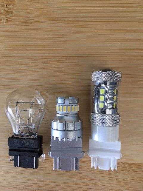

Oh, below is a picture of the 3 bulbs I promised you. I'm going to leave the eBay one, which is the smallest, and probably the brightest too. Wish there was a bulb without the stupid yellow squares at the top (so visible from behind), but all I've seen do, either with, or without, a clear dome. Oh well. Not a big deal, but just looks non-OEM.
