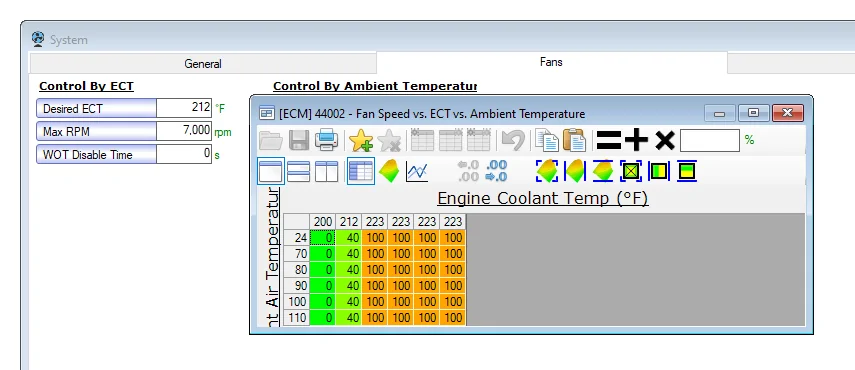

From the factory they are set to come on at 212.
Ive heard Lund sets them at 190
I'd get a 170 T stat
Thats what I have and my fans are set to 190, my CHT never gets above 200

These are the stock figures, the target ECT is 212*.
However, given that you are tuned it could be that your values are completely different...you would have to talk to Lund about it.
Couple things though:
1) those temps you are experiencing are not bad, not sure why you're so keen on reducing them
2) simply adjusting fans to come on earlier won't do much, you really need a lower temp thermostat to keep idle and cruise temps lower
I don't have Forscan, but is that a screenshot from Forscan?

No that is HP tuners software.

Think I'll give Lund a call and see if they can change it to 40% at 200* and 100% at 212*. I would prefer to keep the factory 180 Tstat if those speeds/temps will work with it.

Is the stock thermostat 190 or 195? Just curious. And if you set the temp where the fans run at 100% at only 212-deg, they'd be operating basically non-stop in summer, even on the highway if hot enough (like in TX). That wouldn't be good. The engine is designed to operate at the factory settings. If you burn the fan (only a matter of time that low), and the engine overheats, it'd be worse than just leaving things alone, but to each his own.
When cruising at anything higher than 40 mph my ECT stays at an average of 185. That's 27* difference to get to 212* so I don't think the fan will be running 100% at highway speeds. I'm told the stock Tstat is 180. Today at 74* ambient with car fully warmed up and seeing ECT temp of 183* cruising at 45 mph and then stopping at a red light for approximately 3 minutes the ECT jumped 13* to 197* and would have kept climbing if the light had not turned green. So I know the fan was not running and would not have come on even if triggered to come on at 40% at 200* and 100% at 212*. After reaching 45 mph again it took about another 3 minutes to drop to 185*.
