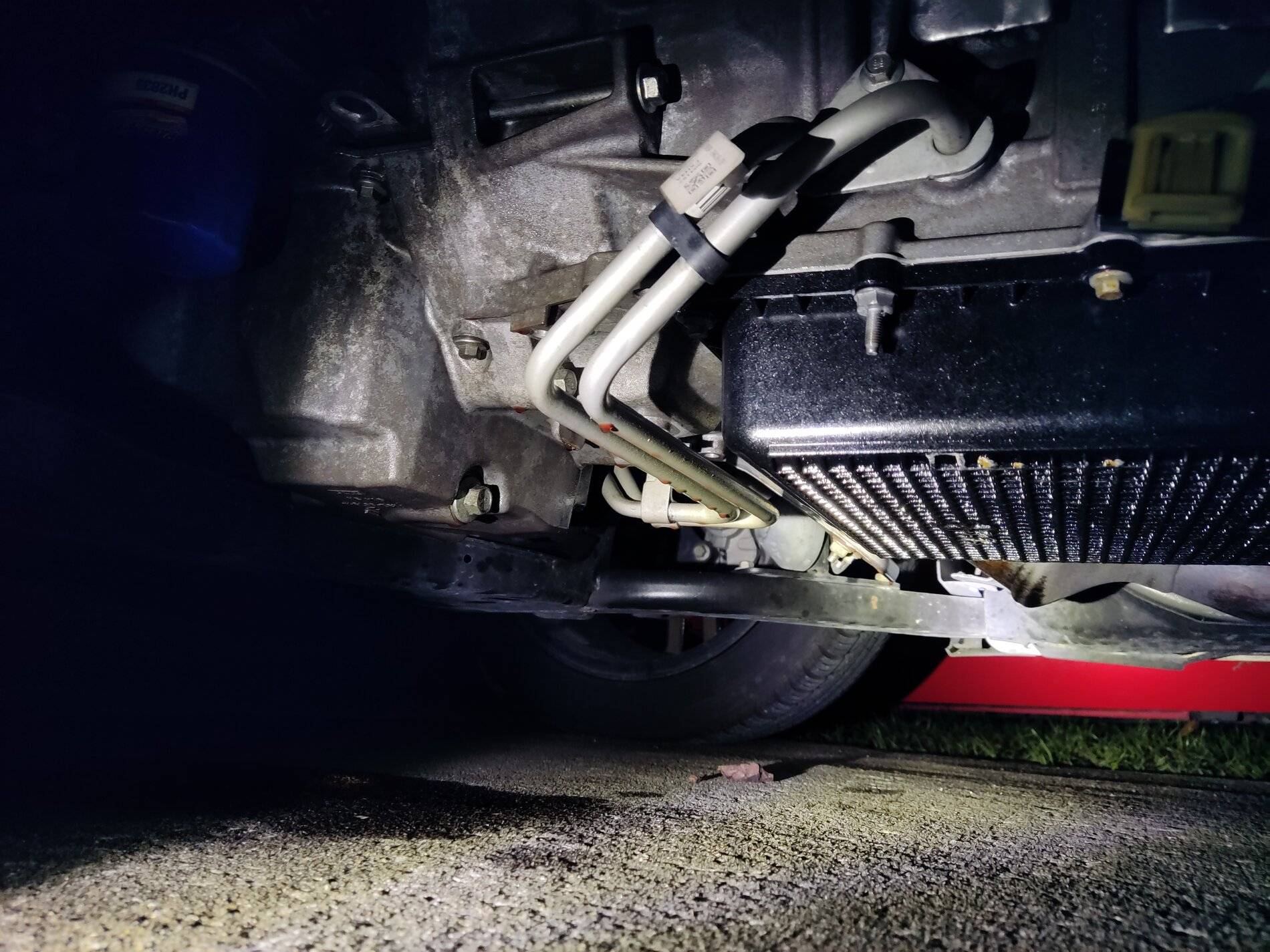

Its leaking to the left of the 2 lines right at a seal.

Hello; I see the two lines in the picture. Might be as simple as replacing an O ring or some sort of such gasket, but I have not actually done any such work on one of these transmissions. So there may be more to it. Best to wait for someone who has some hands on experience.
Looks like the two tubes ought to be the lines that run to the trans oil cooler. A discharge and a return line. Also looks like there is only one bolt holding a bracket which secures these lines.
I hesitate to suggest that you try to tighten that bolt. Snap that off and your troubles will be much worse. I have not worked on that particular sort of way to attach a transmission line, so just do not know.
Check with Ford to see if you are covered before doing any such work.

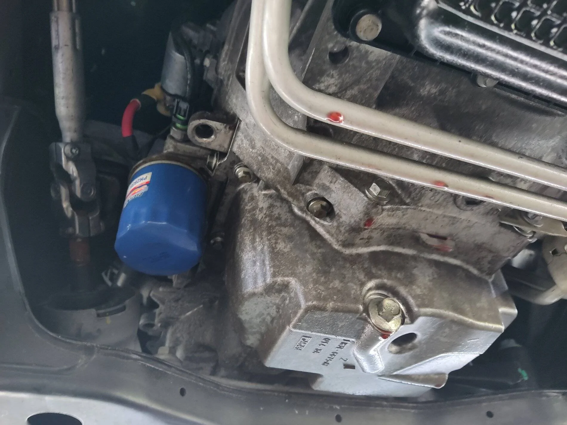

from color can anyone say is that tranny fluid? Its main drip is right at that lip above the lowest bolt in center.
