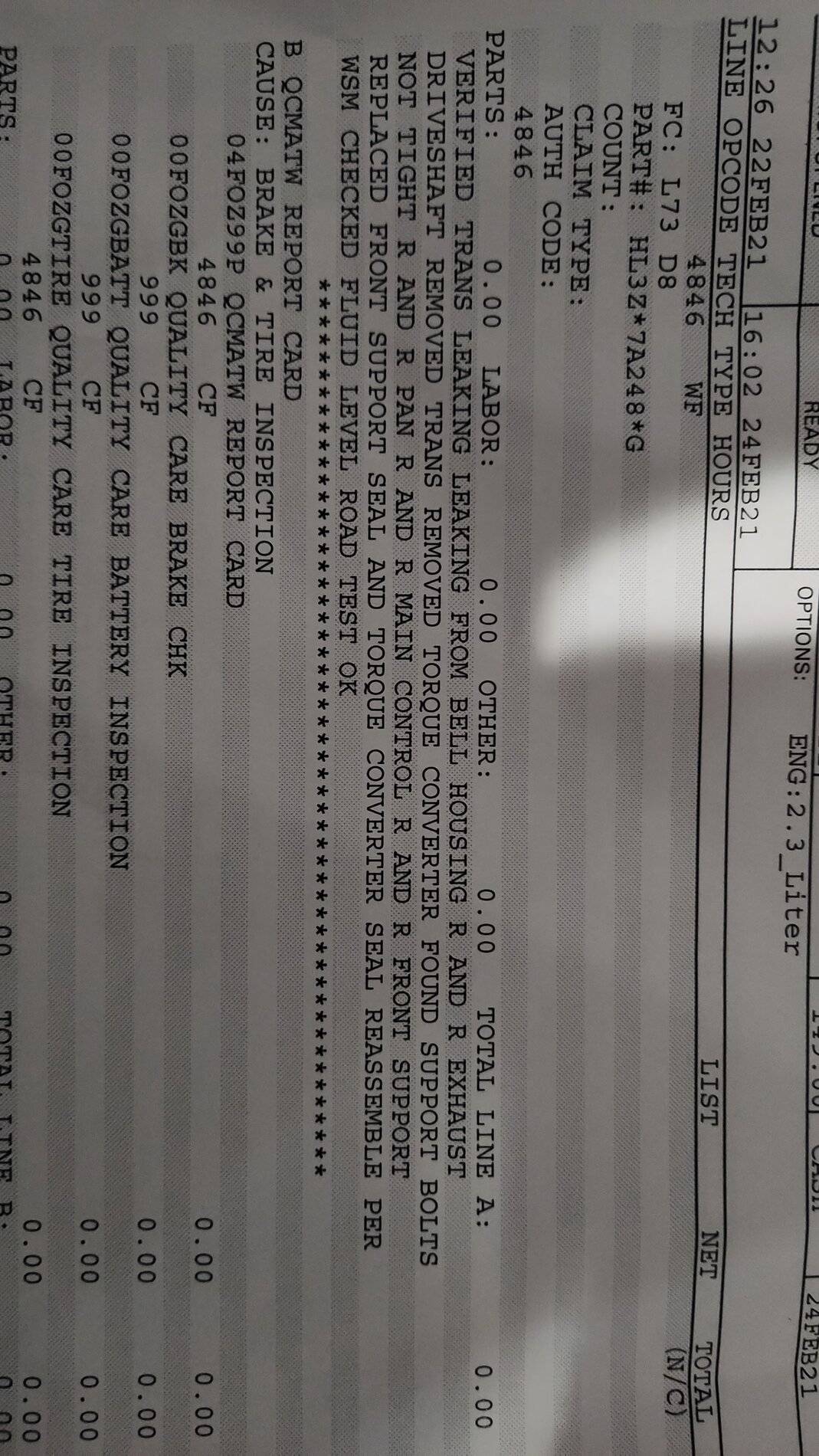

Hello; I could not make out the repair sheet you posted. It was sideways on my screen and some was cut off. Have a look to see what parts were replaced. This might tell you how far they went into the transmission.
