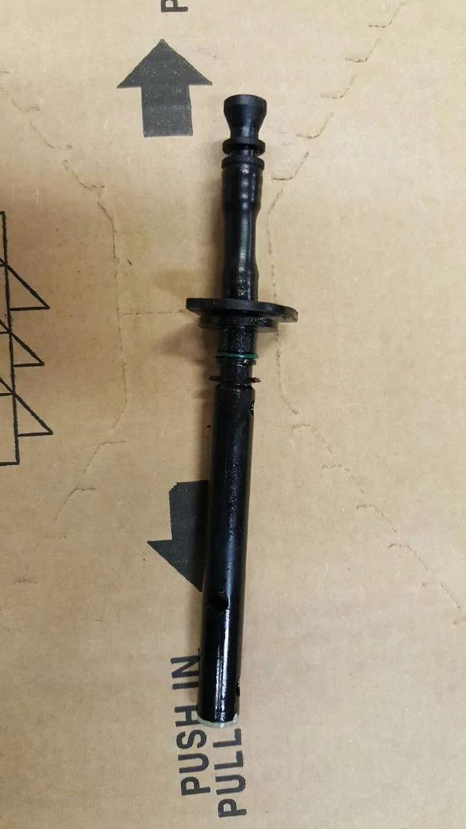

The dealer said it appears the vent tube was having a problem closing, so they order and installed a new part. The install was supposedly easy, but they had to drop the transmission for access. It's all done and waiting for me to pick up when I get back in town.
Here's a pic of the vent tube. I asked for them to hold it, but they said they have to turn it back in since this was warranty work.
