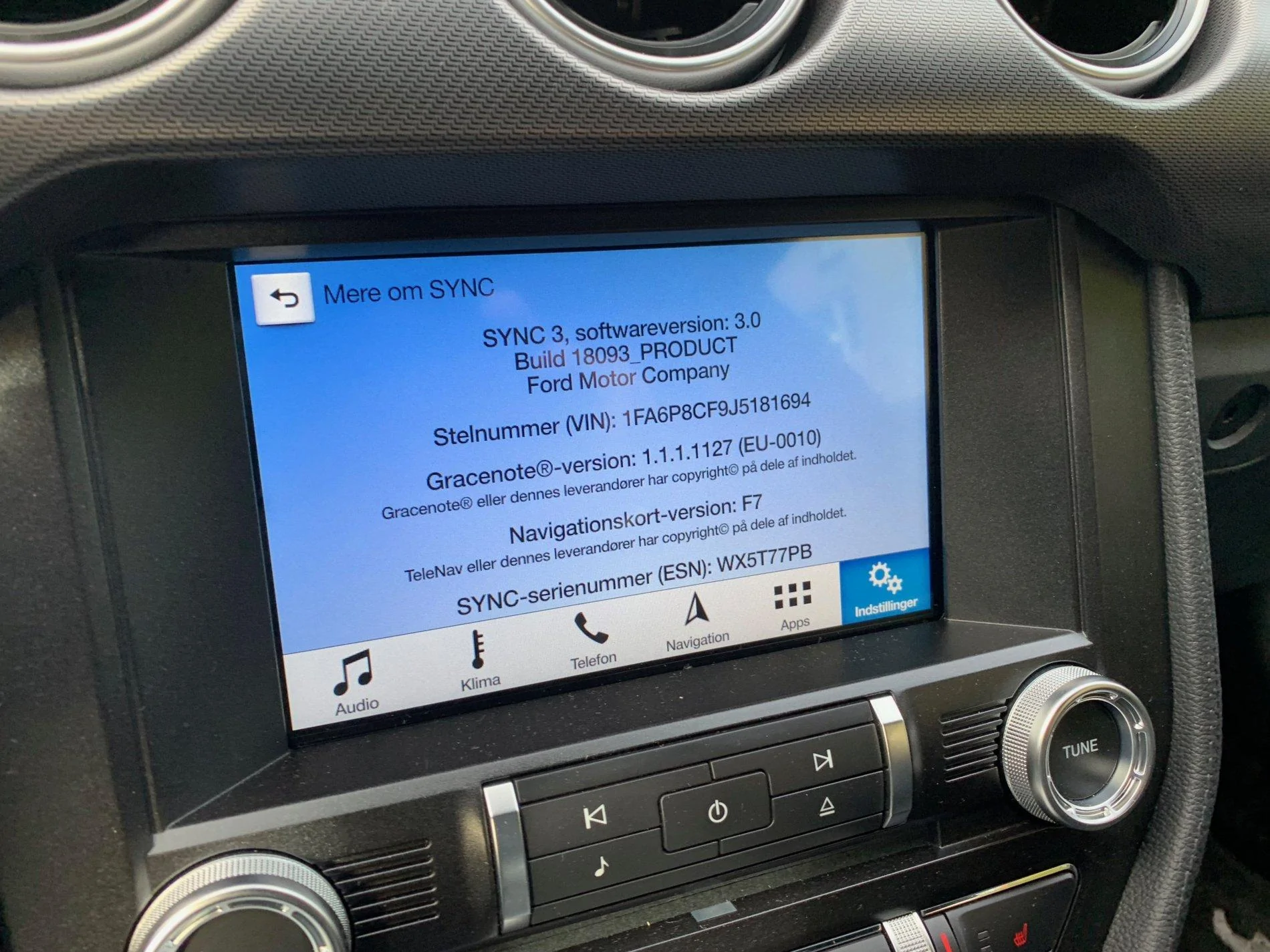

Updated my Sync today, took around 18 minutes again. Website now saying my maps are up to date. View attachment 355714
When I check my VIN, it says that I have the latest software, but my version is still 3.0 (18093), is this correct, because I can see that others have version 3.3
My map is F8
My Vin is 1FA6P8CF9J5181694
Sincerely
Carsten Larsen
My map is F8
Sincerely
Carsten Larsen
Hi Carsten,
MY18+ cars have v3.3. Our older ones have v3.0. Also, it appears that your maps are F7.

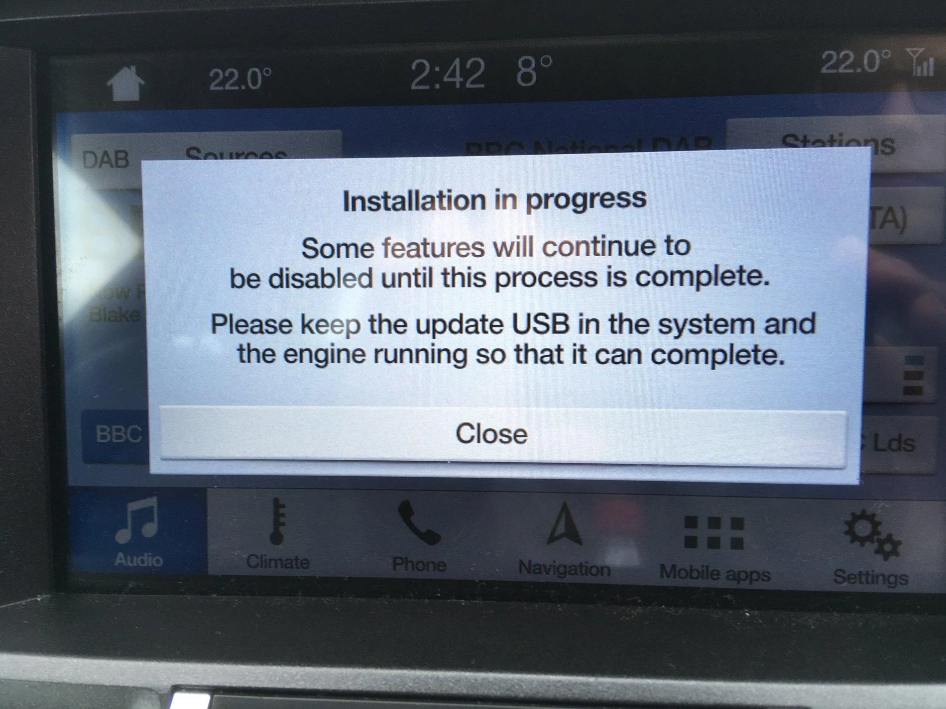

Does anyone else STILL get this message occasionally after start up AFTER a successful update AND when there isn't even anything plugged in to either of the USB ports?
blackboxdata
Jun 28, 2018
Denmark
2018 Ford Mustang GT
I Get this every day
Very annoying

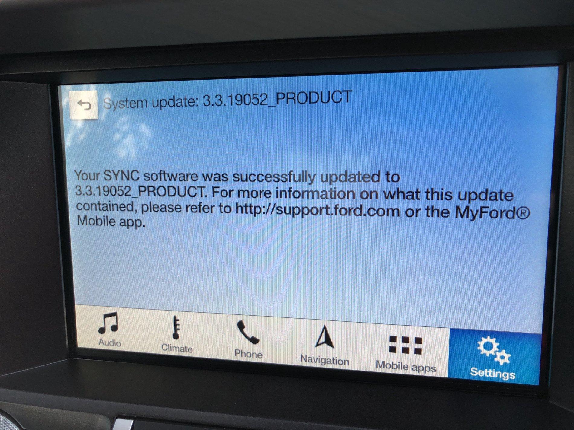

I hope all this effort is worth it!
It just takes too long to update sync and the map updates so I can’t be arsed to do it unless the updated version of sync is way different. Anyone know what the sync updates contain?
marks
Jun 26, 2014
108
2,698
536
Essex
2017 Mustang GT Race Red Manual
Think it's just the map updates, although did an update last year which helped with stability. Somewhat pointless upgrading to latest version for Ford maps if use Google maps or Waze for directions
