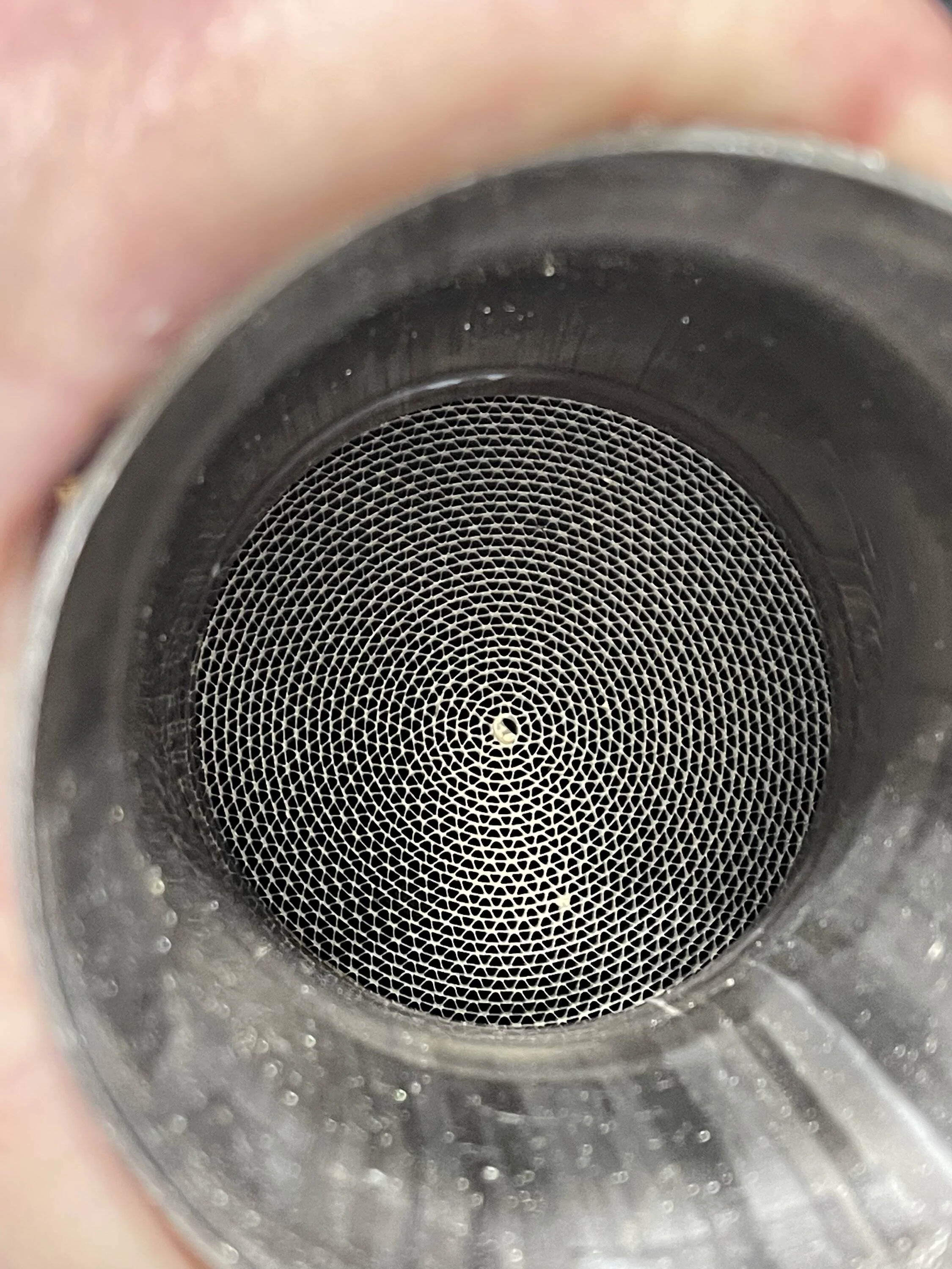

Just got my kooks long tube headers with green cats anyone have experience with this ? CEL or cats failure?

I've had mine on for about 3 weeks. No CEL or issues so far.

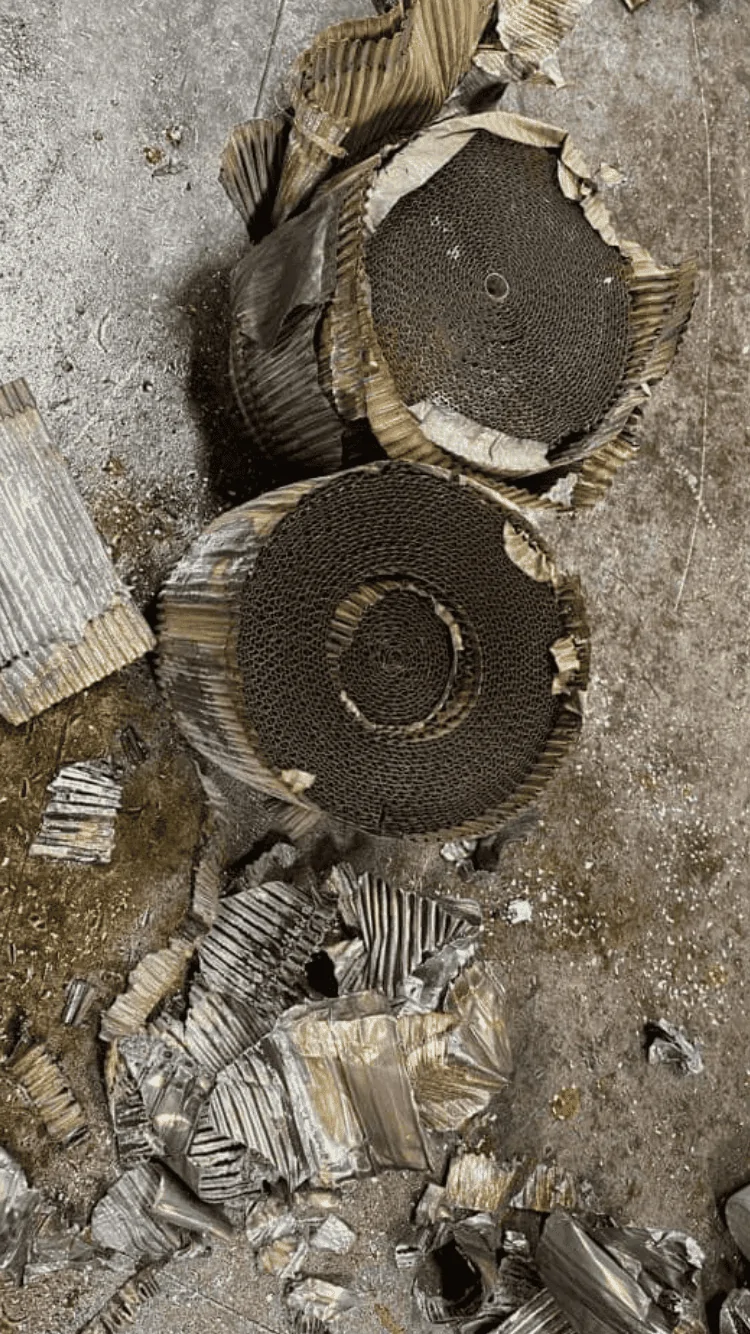

My "green" cats blew apart in 5000 miles. Yes, CEL comes on eventually in MOST cases.

I’ve researched and tested the issue more than any sane person should. My conclusion, right or wrong, is that stock cats that use ceramic substrate usually fail due to thermal shock. Many aftermarket FI tunes run lean with low timing at wot and low rpm, which is a recipe for thermal shock. Add to that, cool-down periods before dyno pulls and drag runs and you made it worse. Every failed stock cat I’ve seen has a cracked monolith, which is evidence of uneven heating not overtemp. Conversely, the metal substrate aftermarket cats fail from high sustained temps or inadequate mechanical attachment of the spiral. I believe these CAN be pretty good but not all are. Even with the best attachment they still can’t sustain the temps as well as ceramic. The yield strength of 304 goes down to basically nothing at 16-1700 deg f.

I believe the HJS Tri-wound cats are still the best in the industry but as Mike points out, supercharged temperatures are destructive.
