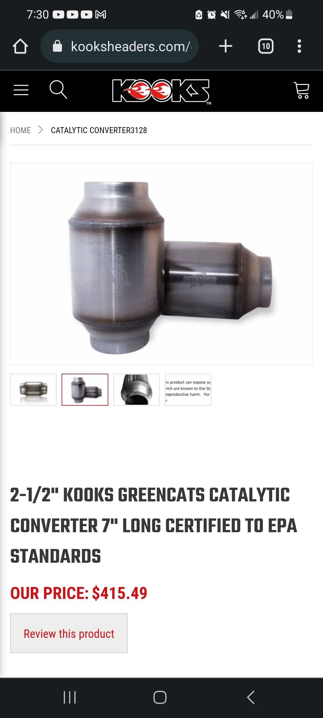

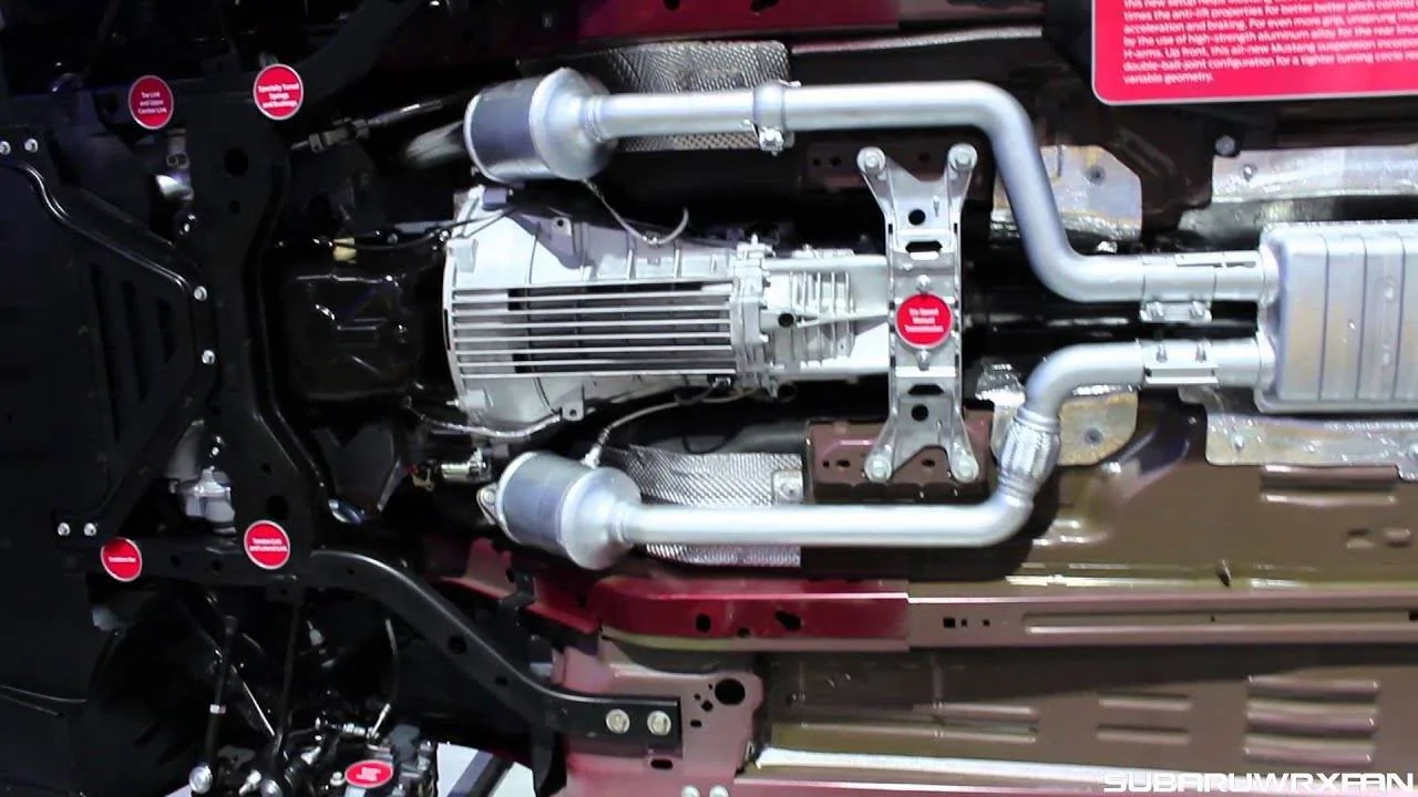

Hey Guys, I have a 2017 Stage 3 Roush and i think one of the cats might be going out. From what i have read, the stock cats dont like boost or horsepower above 600whp. I live in an emissions state and I'm wondering if 2.5" Kooks Green Cats can be used with the stock headers. I'm guessing they will have to be welded in but can that be done without removing the headers? I've only been under my car for general maintenance and to install an upgraded heat exchanger but from pictures it looks like the passenger side header has a flange to bolt to but the drivers side doesnt or is there a flange higher up? Trying to avoid the cost of aftermarket headers and install. Thanks in advance for the help. Pictures attached for reference.

Yeah that's a ridiculous price. I didn't price it out. Though it was in the high 600s
At first glance it is until I realized the lower price is for Naturally Aspirated and as soon as you choose the boosted option, the price triples.
Yeah that's highway robbery. I'm sure the kooks green cats would he an East weld in, or the ones LTH sells which I believe are also the ones that make the kooks ones

It's actually really easy to pull the driver's side stock header/cat assembly. You get the front 3 bolts from the top and remaining 5 from the bottom. Unhook the steering column (1 torx bolt), the exhaust ball-joint, then it comes right out. You just have to get the car high enough to get the whole thing out. Once it's out, you can weld in a cat of your choice.
That said, many (including myself) install a flange on the driver's side manifold. The Gen1 and 5.2's have this flange already, but I believe they are oriented differently from each other. In other words, you can't just install a Gen1 manifold with a GT500 cat. Also, the 5.2 headers won't bolt to Coyote heads. You could install a Gen1 header or add a flange to your stock header, then make a catted mid-pipe to connect to the rest of the exhaust if you want.
