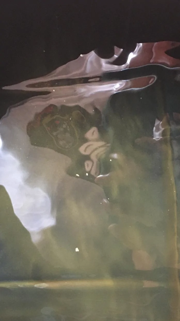

Here's a little bit better pic of some metal shavings that came out. These came out of the oil filter.

That noise is rod bearing knock, but I'd say you got lucky as in your video with some revs the knock softens and gets quieter which means you still have oil pressure.
If you'd spun a bearing completely it would be stuck on the crank and you'd have no oil pressure. STOP RUNNING THE CAR!
You could get very lucky and all you will need is now bearing shells and sump gasket. If the case I'd advice coated shells and uprated ARP bolts if your considering revving to 7k and over whilst boosted.
It has either being caused by the oil pump not supplying enough oil due to OPG failure or the RPM was too high, engine too hot and as such oil viscosity too thin causing the shells to wear which is what your seeing in the oil with the silver/copper glittery metal flakes.
Hopefully you caused no damage to the crank and a new set of shells and some labour will see you back on the road. I'd also be uprading the oil to a decent 5W-30.
Best of luck with it! :)
