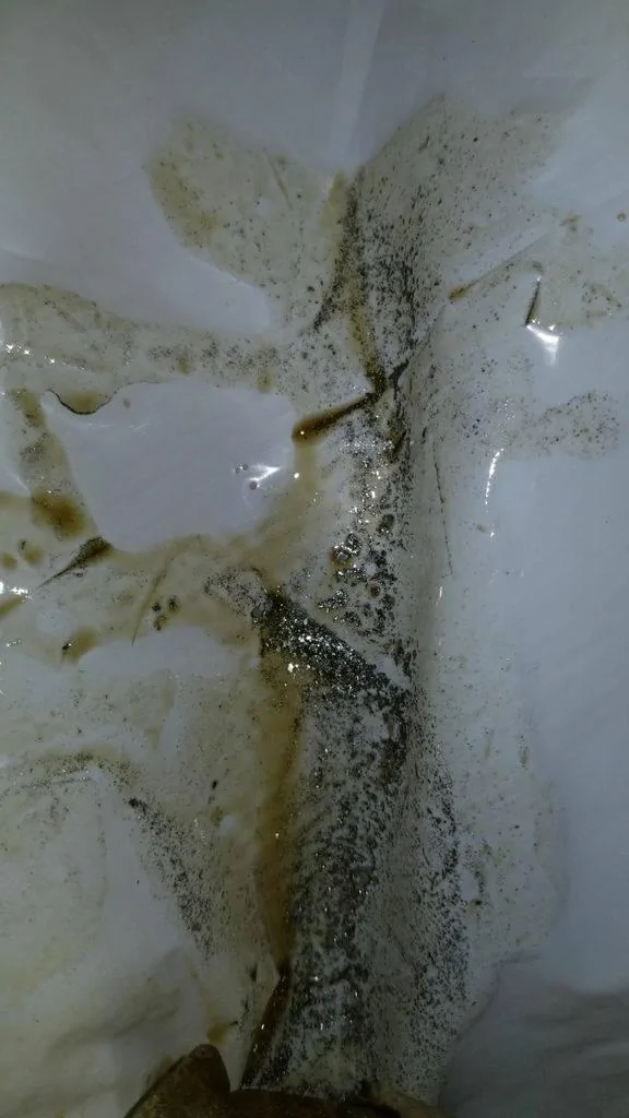

so I opened my oil filter and found this :(
Now that I found the issue. I will be looking at my options for built long blocks. :cheers:
If you have any suggestions on long blocks let me know!
Thank you!
