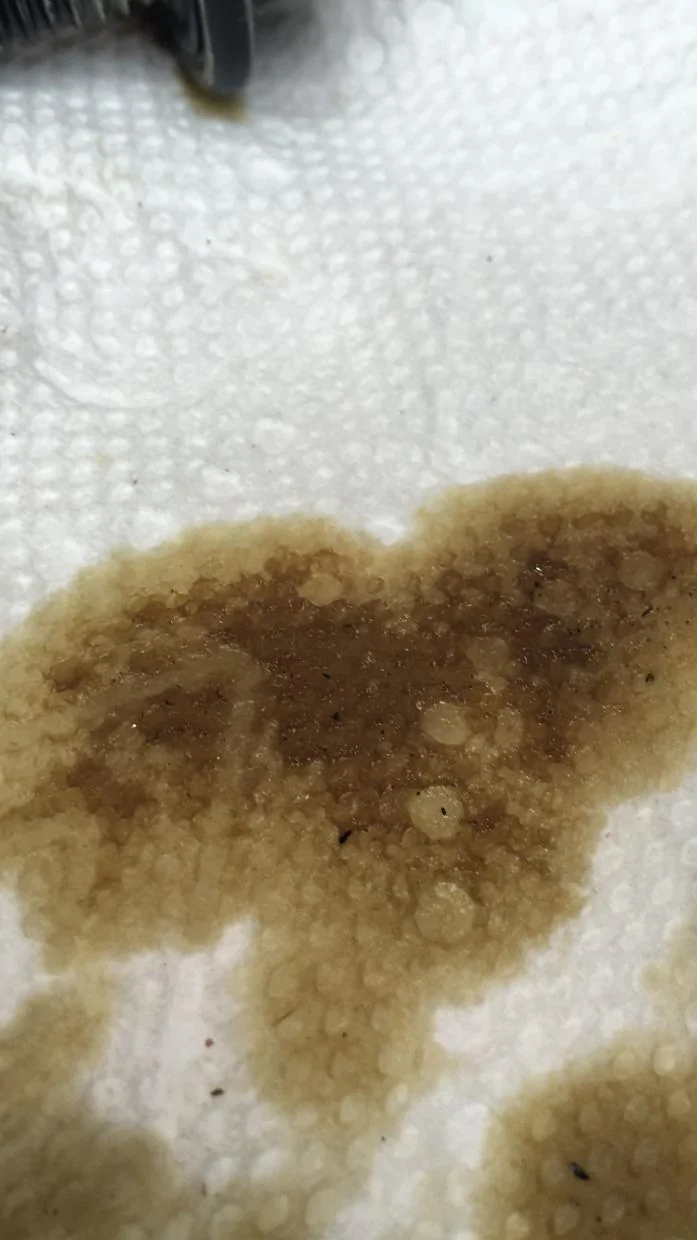

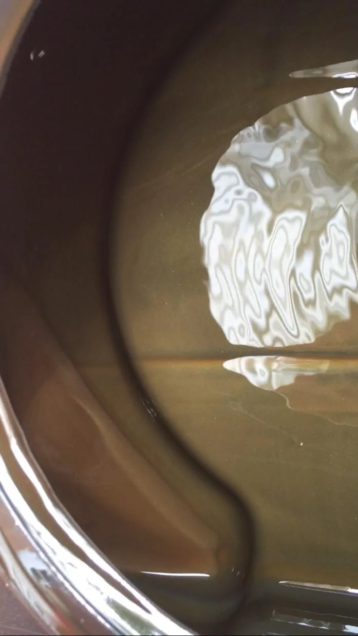

Just drained the oil, next two pics is what came out

Can see some silver mixed in with the black. Not sure if all the black was paint off the plug, or bearing shavings, but the silver flakes stand out in person

My money is on the bearing. I'd send a sample of the oil off just because I'd want to know more about it.
