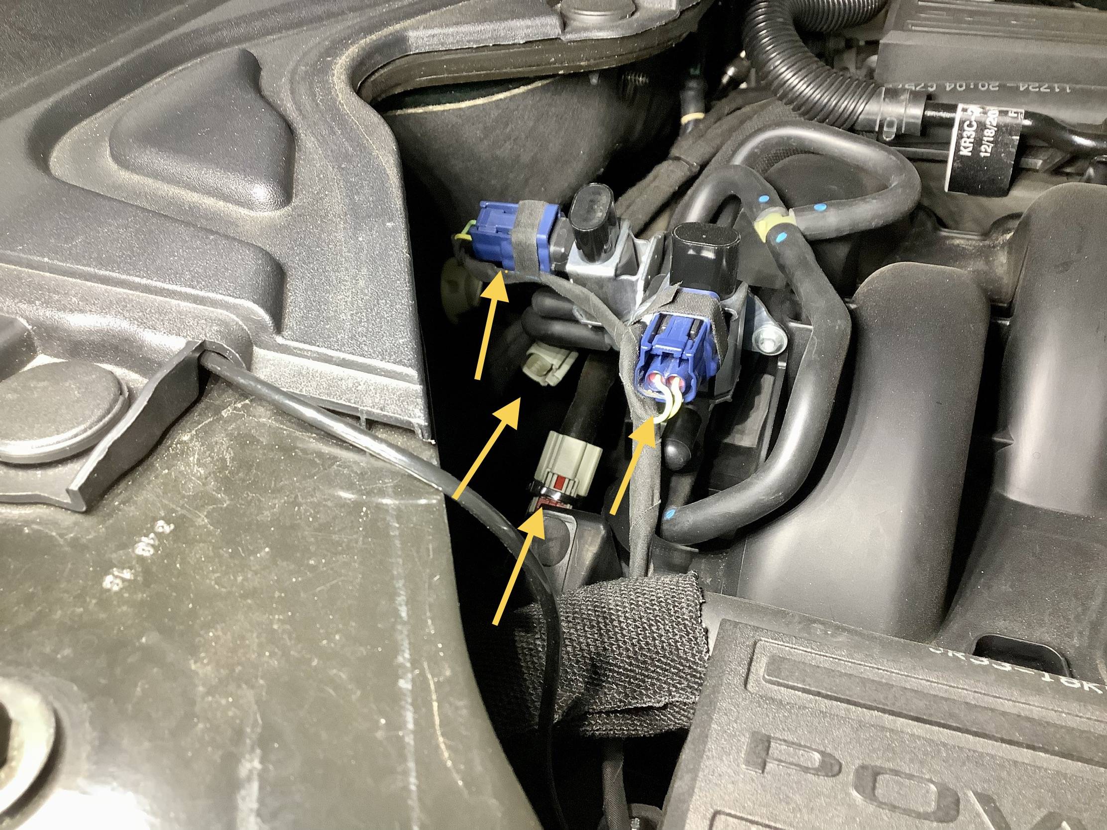

Are your IMRCs locked out? If so, did you secure the connectors to the main wiring harness with zip ties to keep them from rattling around and being detected by the knock sensors? I kept the brackets for the two blue connectors and just plugged them back up on mine to prevent rattling. The two off-white ones I zip tied.
Yes im IMRC locked out. I will double check with my shop on this. thanks !
