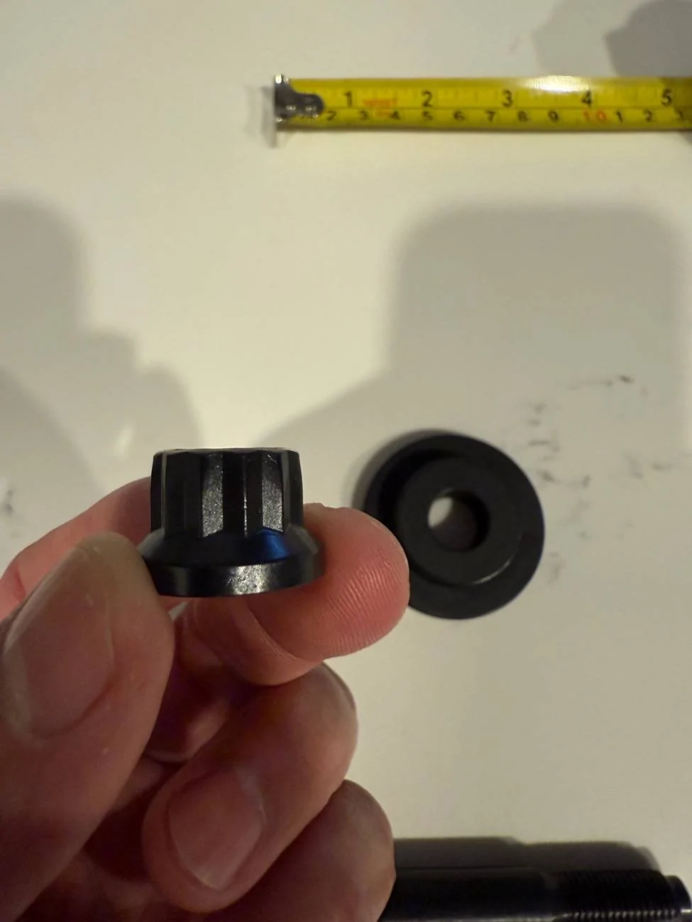

Honestly, the FFRE kit looks identical except for the washer. The washer in the Kinetik kit was significantly smaller than stock. Soo much so, I was paranoid and triple checked to ensure the washer dia was big enough to sit outside the face of the pulley. It does, but it does not fill the wear pattern of the stock washer. That washer in the FFRE looks mucho better and wider. The stud and 12 pt nut look the same.
@NGOT8R Can you take a stand alone pic of that washer out of the bag for us? Thanks.
I agree and wrote Kinetic an email years ago outline the washer is too small. I used the washer that comes with the ARP crank BOLT kit, perfect.
Yes, give me just a bit and I’ll post closeup pics of all parts.

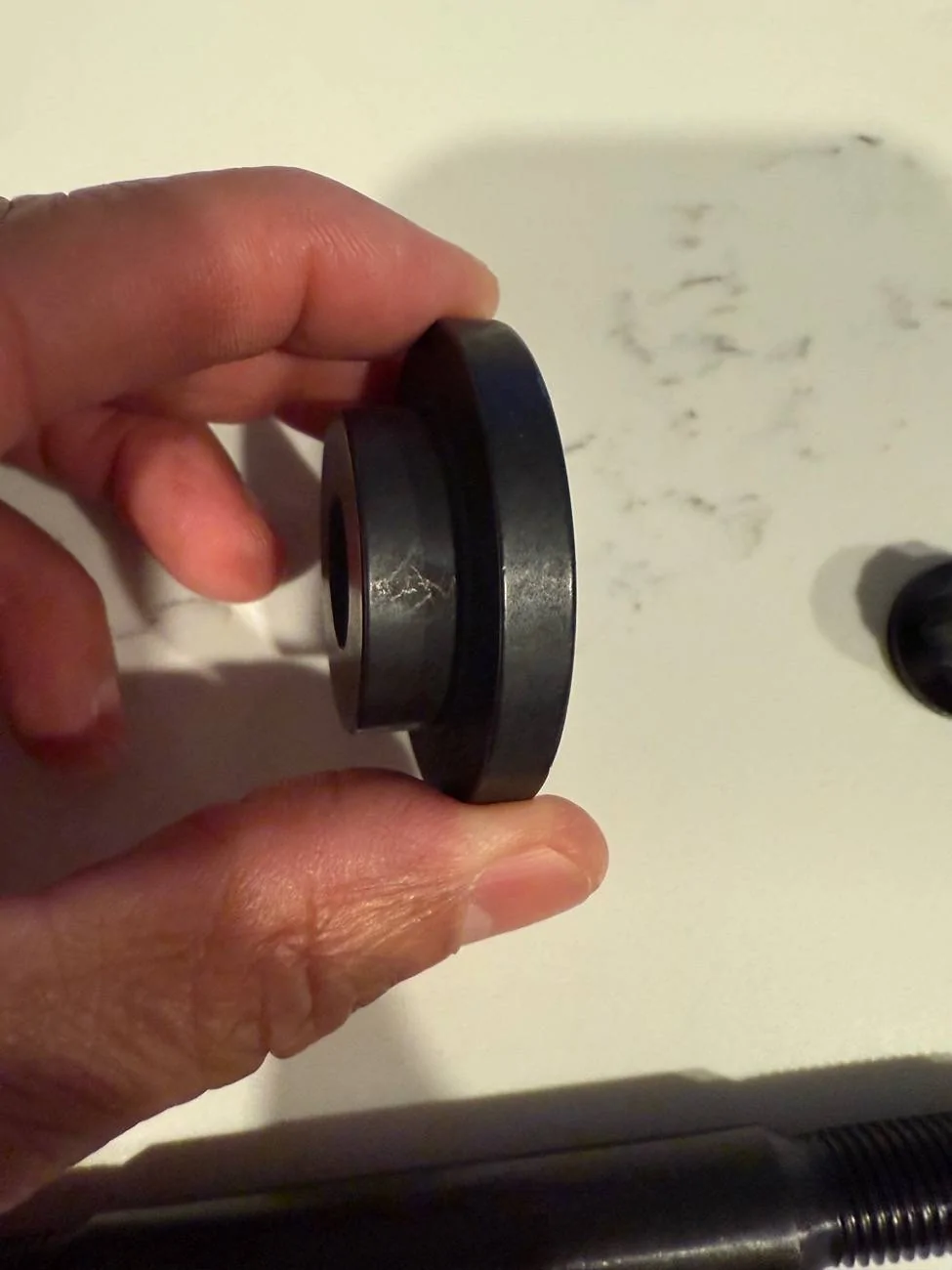

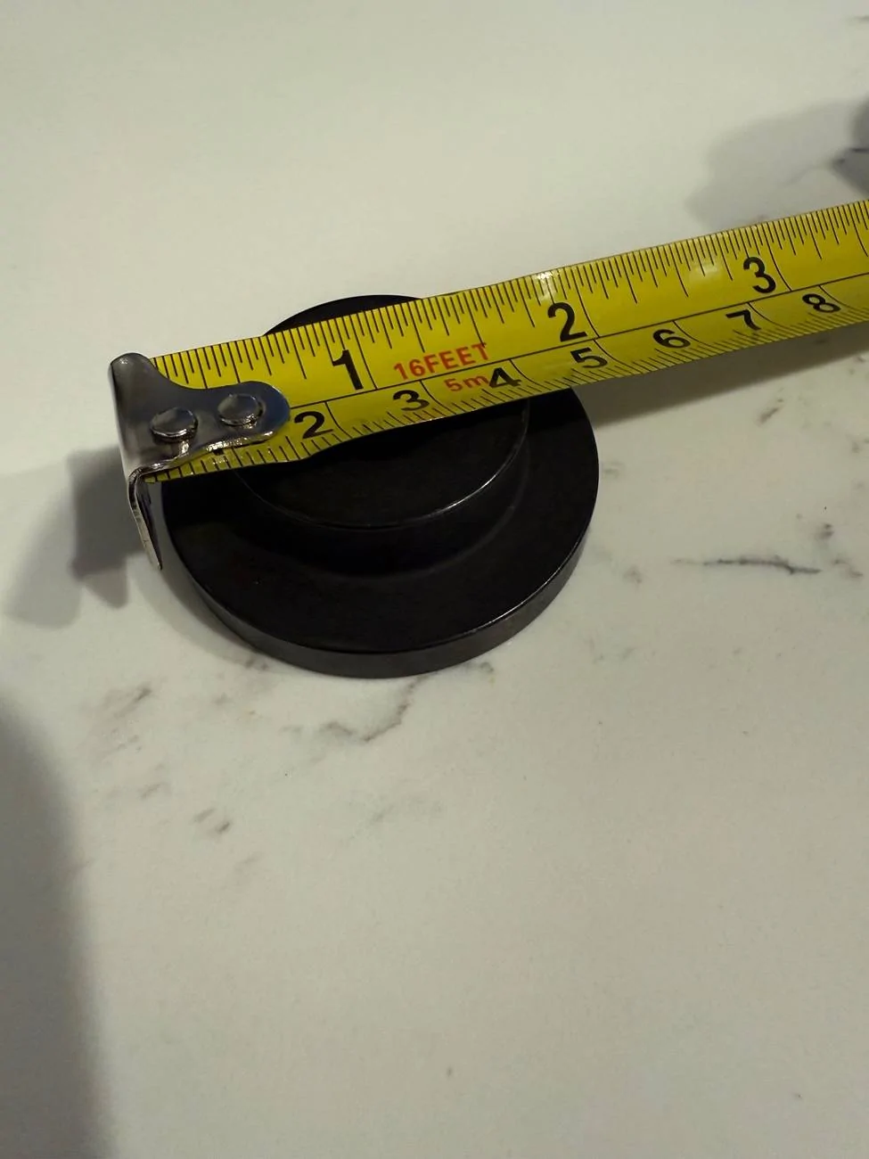

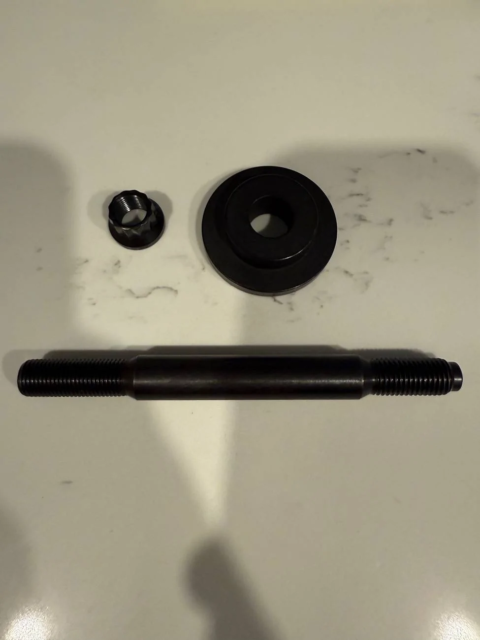

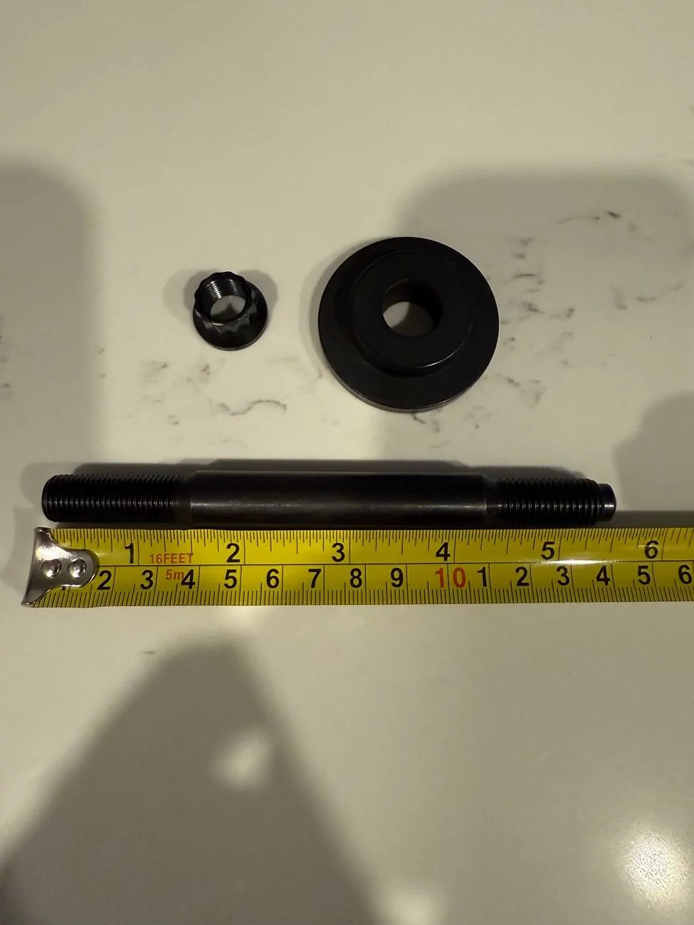

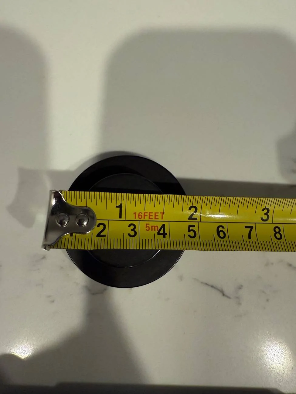

Yup, completely different washer. I like it. Same dia as stock washer. Great, now I don’t like the small washer that came with this kit. Guess I’ll put the stock washer back on. Started to do that anyways.
So the FFRE instructions don’t specify, but the pic on the website shows the raised portion on that washer as going inwards towards the engine. Cool design idea.
Yup, it sinks into the center of the balancer and keeps it centered.
