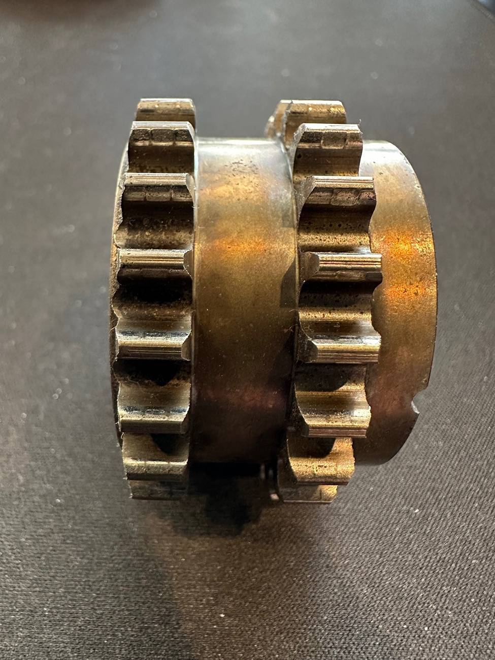

I ran across this pic of a damaged crank sprocket and wanted to see what others thought could be the cause of this. I’ll take a guess and say it was tensioner related (too much slack in the primary chains and as a result, the chain kept slapping against the sprocket teeth).

That is supposed to be a billet CS, although the poster didn’t mention which brand it is.

Looks like perfectly normal link plate chain wear patterns.
The sprocket radius is tight, I’d expect those depressions.
Did the person who posted that picture mention total miles in service ?
No, only that it came off of a car that was road raced.
Looks like a Boundary sprocket. I believe they are the only ones that feature what they call a "burst ring" around the center of the sprocket.
I think there is a misconception that the billet aftermarket sprockets/ OPG's are harder than the stock stuff. In fact, the metal is softer than the stock powdered metal material, but many times stronger. The idea is that the softer metal wont shatter but instead is slightly flexible and can endure the shock and vibration that was breaking the OEM parts. I wouldn't expect the aftermarket options to last as long as the OEM parts in high mileage use.

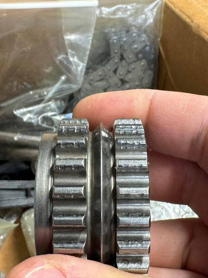

20k miles on my stock CS. Not the best pic, but if you zoom in you can see some very small impressions. Don't mind the dust, it's been sitting on the shelf for a few years. :)
There is quite the difference in manufacturing variances seen in those (2) images. Considering the bottom one is a stock crank sprocket from an S550, how is it that the aftermarket “unknown” is THAT much different and even still works properly as far as depth, chain contact location and teeth spacing?
Is that 1st image really a direct swap/replacement crank sprocket for a S550 Coyote??
If I had pulled that sprocket (first image) out of its box and laid it side by side with a stock sprocket, there’s no way in hell I would have even considered using it.
Even the spacing between the teeth are not the same or even close to the stock pattern…
Plus, look at the difference in the height of the teeth from stock to that aftermarket POS sprocket - would you trust that POS in YOUR engine? The chain barely has anything to grab on that aftermarket POS…. LMFAO…
Are we certain that first image is something that should be used on a S550 Coyote???
