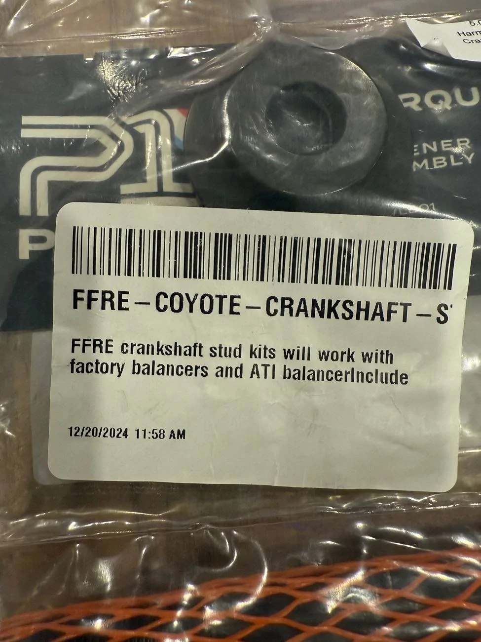

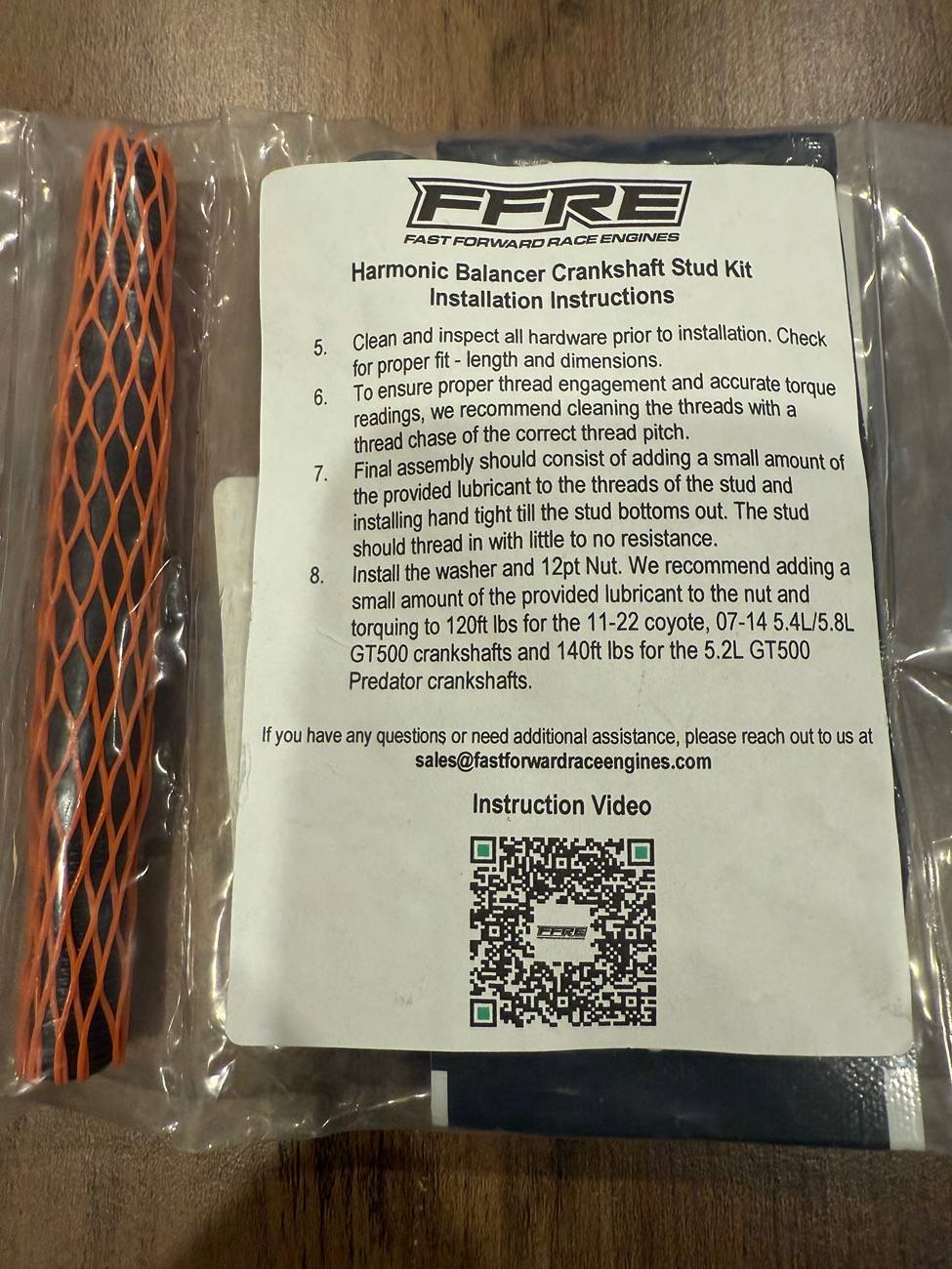

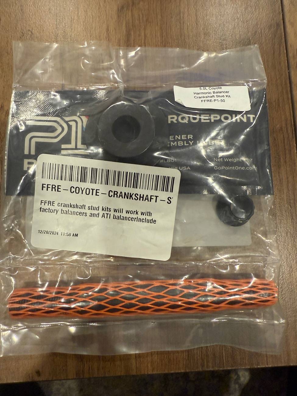

I have my FFRE stud kit on standby to be installed along with a new balancer when I tear into the front of the motor. It arrived packaged nicely with instructions right on the bag.

Are these made to the same spec as Kinetic?

Honestly, the FFRE kit looks identical except for the washer. The washer in the Kinetik kit was significantly smaller than stock. Soo much so, I was paranoid and triple checked to ensure the washer dia was big enough to sit outside the face of the pulley. It does, but it does not fill the wear pattern of the stock washer. That washer in the FFRE looks mucho better and wider. The stud and 12 pt nut look the same.
@NGOT8R Can you take a stand alone pic of that washer out of the bag for us? Thanks.
