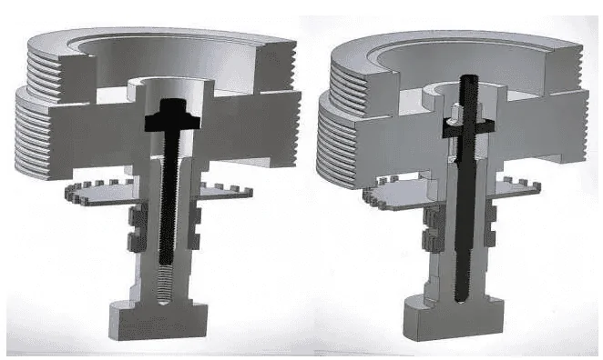

I have read that a possible cause of crank snout failure is bottoming out the crank pulley bolt during install. (Aside from aftermarket dampener and/or a bad crank)
Since the crank saver bolt is longer and designed to fill the void that Ford left in the crank, wouldn't this crank saver bolt run the risk of bottoming out in that cavity or putting extra strain on the nose? Especially, since a person may need to deburr that cavity?
I know the homebrew method for improving other ford cranks is drilling out the cavity to the main bearing to anchor the bolt/stud. The crank saver obviously doesn't replicate this.
Also, while the aftermarket bolts are stronger, it seems the failures are in the crank nose itself. So while the bolt may survive, I'm not sure I see how it would make the crank nose less likely to fail.
So is there any real benefit to the crank saver? Or the ARP bolt? When compared to a new ORM crank pulley bolt.

1- the OEM bolt does not bottom out in the crank.
2- By shoring up the void in the crank, the lateral loads on the snout are much more evenly distributed than the OEM bolt, so it is less likely to break ( I assume you are talking about a supercharger install, and the extra strain it places on the crank)
3- Use a Griptec pulley on the supercharger so that you dont have to put unecessary tension on the belt to prevent slipage. This also makes the 10 rib setups unecessary for most applications
4- avoid any supercharger kit that uses an extended harmonic balancer/crank pulley setup. Seems to me that most of the failures on here are using something like this, and the additional leverage on the snout along with all the additional vibration and extra force that it takes to drive the supercharger are what snap them.
Apex torque also makes a crank stud kit, but it doesn't fill the void like the Kinetic offering does. Still better than a bolt though
The directions state to Finger Tight Only. The bolt does not assert pressure on the crank inside thread of the snout.
As stated the stock bolt does not bottom out. The kinetic unit is a stud. Thicker and is of a harder material. Therefore torque applied will be higher than oem. Failure of snout typically occurs when applied pressure of balancer hub/crank sprocket/crank snout shoulder is lost or reduced. The above stack adds strength to the snout itself, when properly torqued. The kinetic stud applies more pressure to the stack than an oem bolt.
