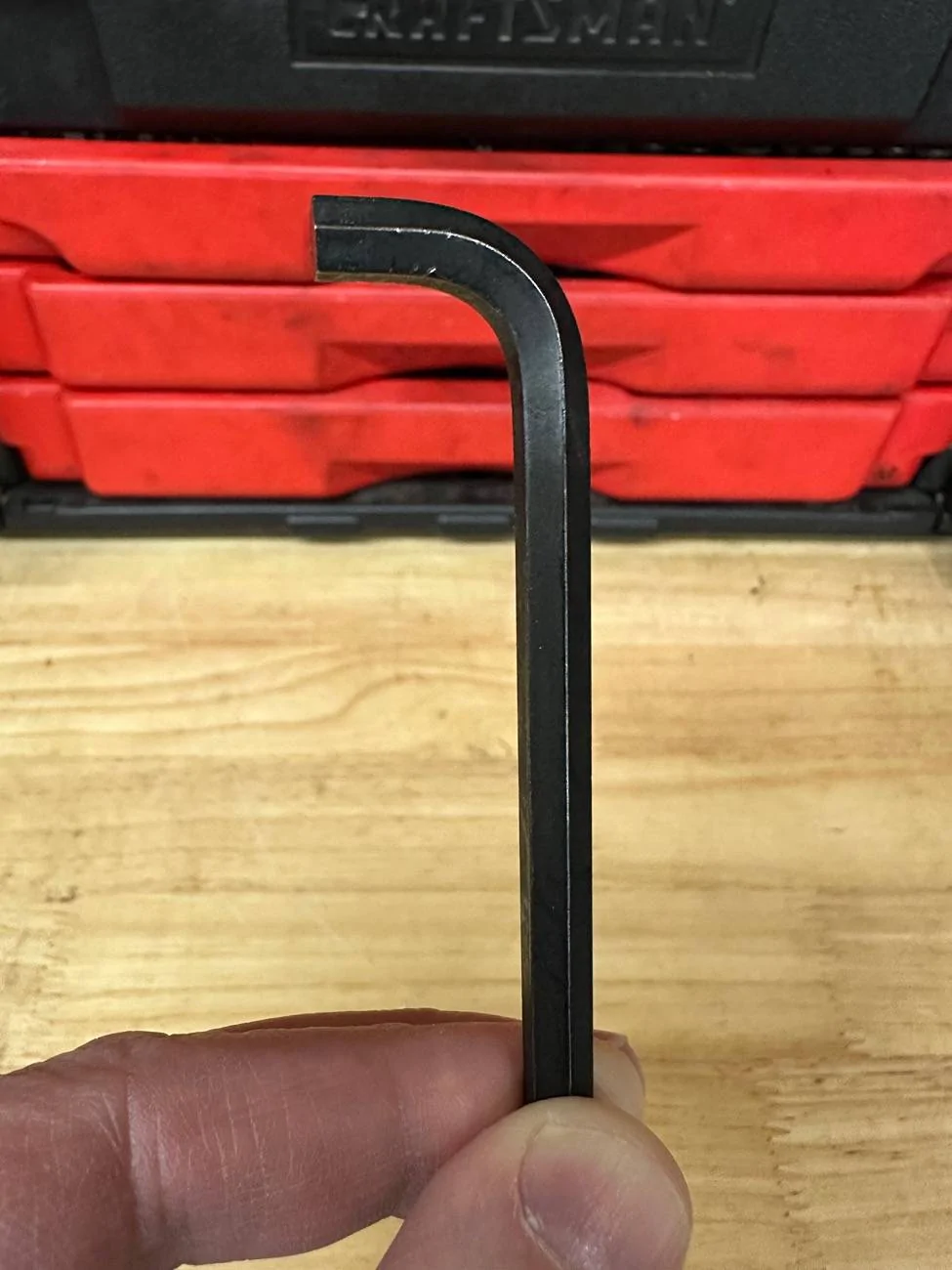

But, I think you have to remove your front Sway Bar which is the only reason I didn't install one.

You do not. I’m not going to say it’s fun working around it, but it does fit with it still on.
Correct! Pain in the balls working around it, but it’s doable. I ground down an Allen wrench in order to get some of the bolts tight.

And… as bad as it is at stock motor height, it becomes almost impossible to remove/install when you lower the motor 1+”
Do you have a picture of your ground down allen?
Here you go! I just ground down the short side and was able to access the bolts near the sway bar without a problem.
That's awesome! I appreciate it!
