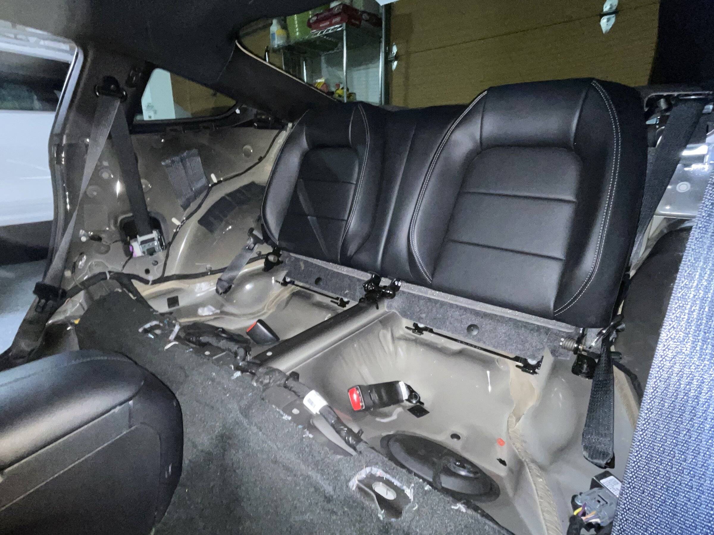

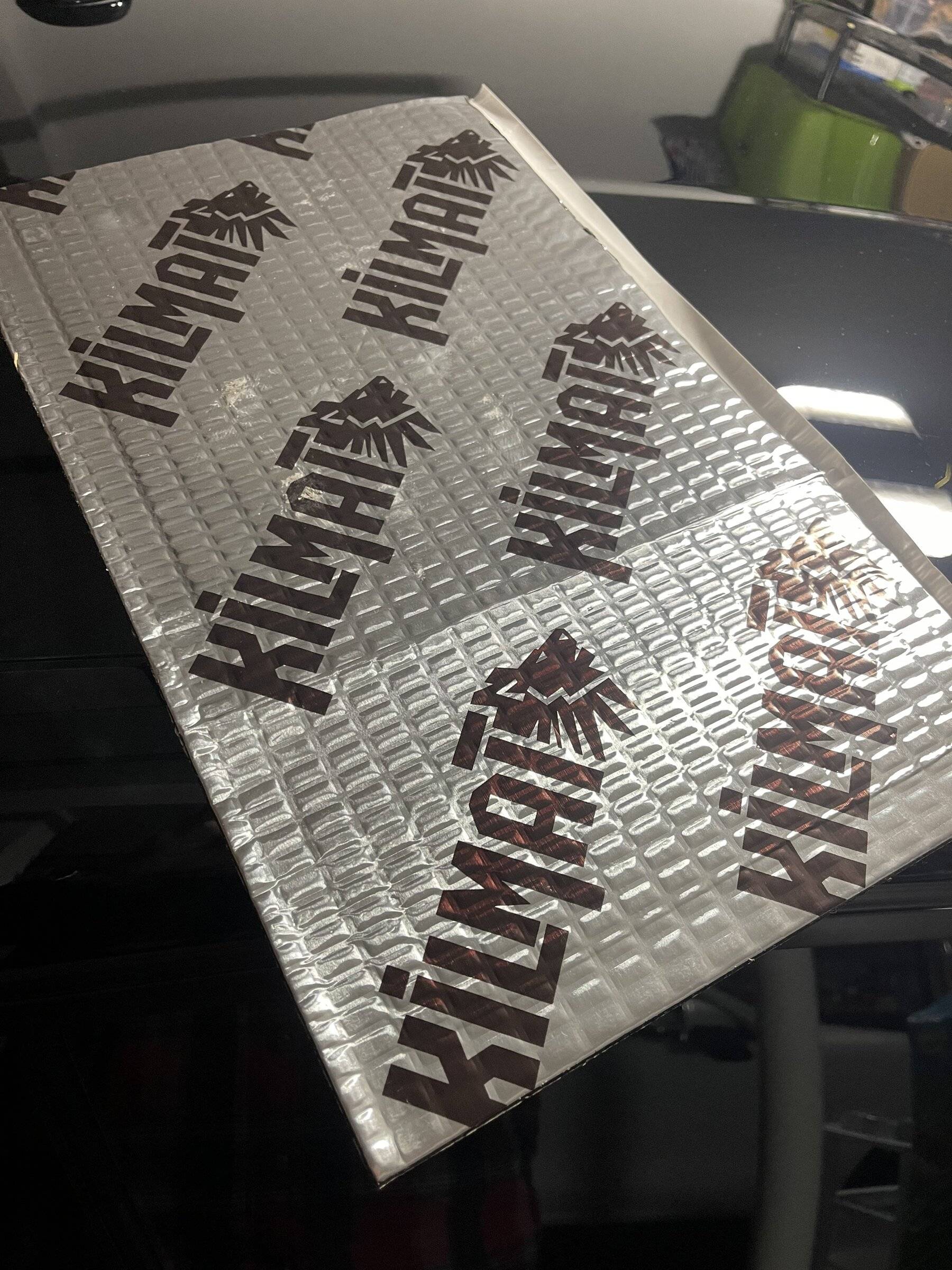

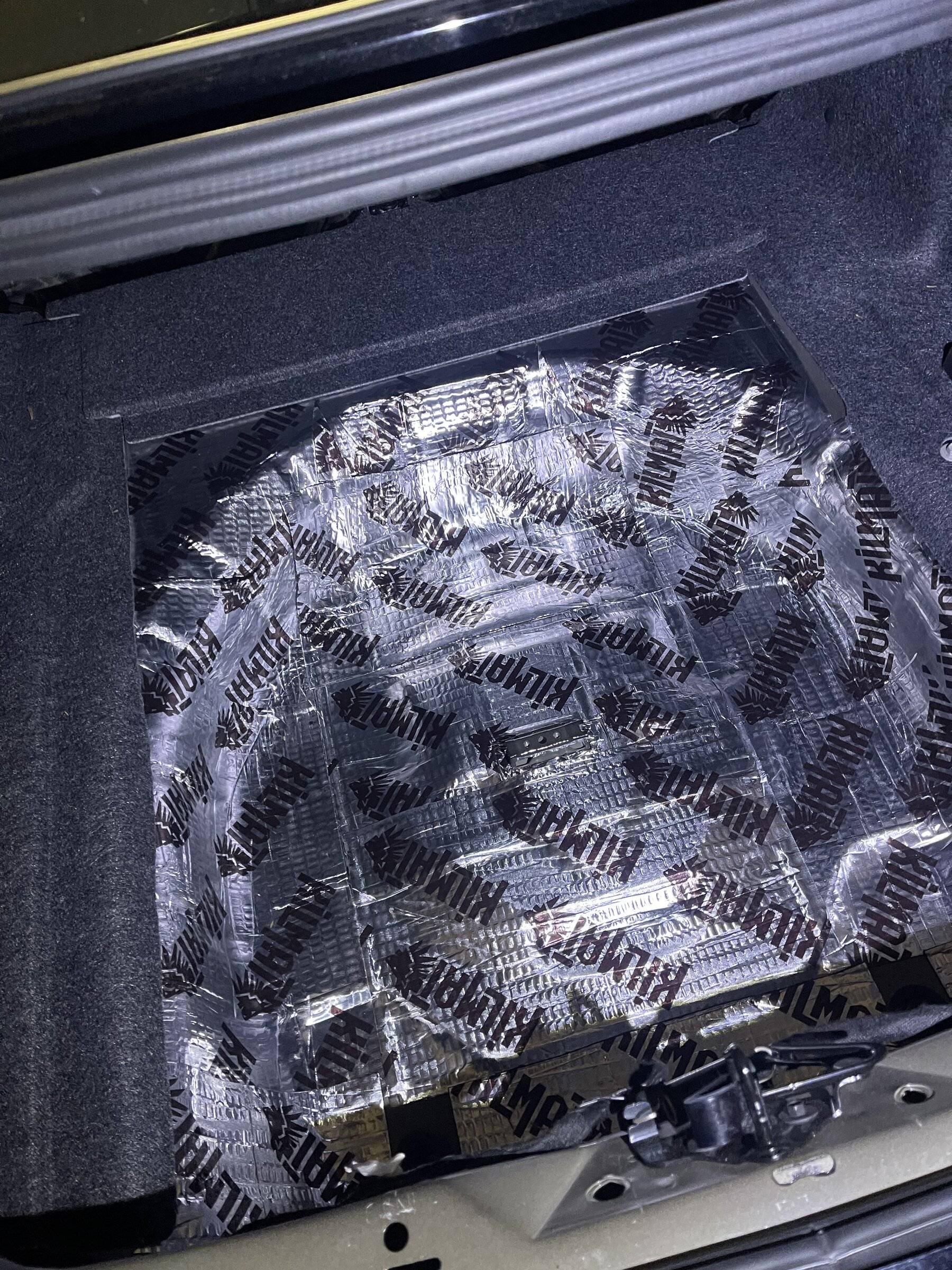

Decide to try sound deadening project using 100 mil Kilmat. I am not sure I have the resolve to do the entire car or even 100% coverage on every panel. I read that you will notice a difference with even about 70% coverage. As a test, I’m starting with some key areas under the rear seats, the rear wheel arches and the spare tire well. Just these few areas took 3.5 hrs. I could see this easily as a 15+ hr project if you did the entire car. If I feel the results were worth the effort, I plan on moving onto the front doors, rear speaker shelf and trunk…..or possibly the entire rear end from the front seats back if I feel really motivated. I don’t think I’m going to tackle the front since I don’t want to take out the front seats and center console. The Kilmat was extremely easy to work with since it comes in small sheets and I had no issue cutting with a utility knife. There is almost no sound insulation on this car whatsoever except for a few pieces of styrofoam. Finished at 2 am last night and the roads have been icy around me so I haven’t had time to test drive. Results to be posted once the weather clears up. I also have a foam sound deadening mat I bought from a forum member a few years ago. If anyone has successfully sound deadened their car, any tips tricks or key areas to focus on appreciated.
ps Does anyone know what those 2 really rubber circles under the rear seat are for?

The rubber things are access to fuel tank, I believe.

I just did the trunk lid as well. I was a little skeptical but I feel a lot of the rattles are gone with just the three areas I hit. I am definitely going to try full coverage on the doors. I will hit the roof IF for some reason I need more.

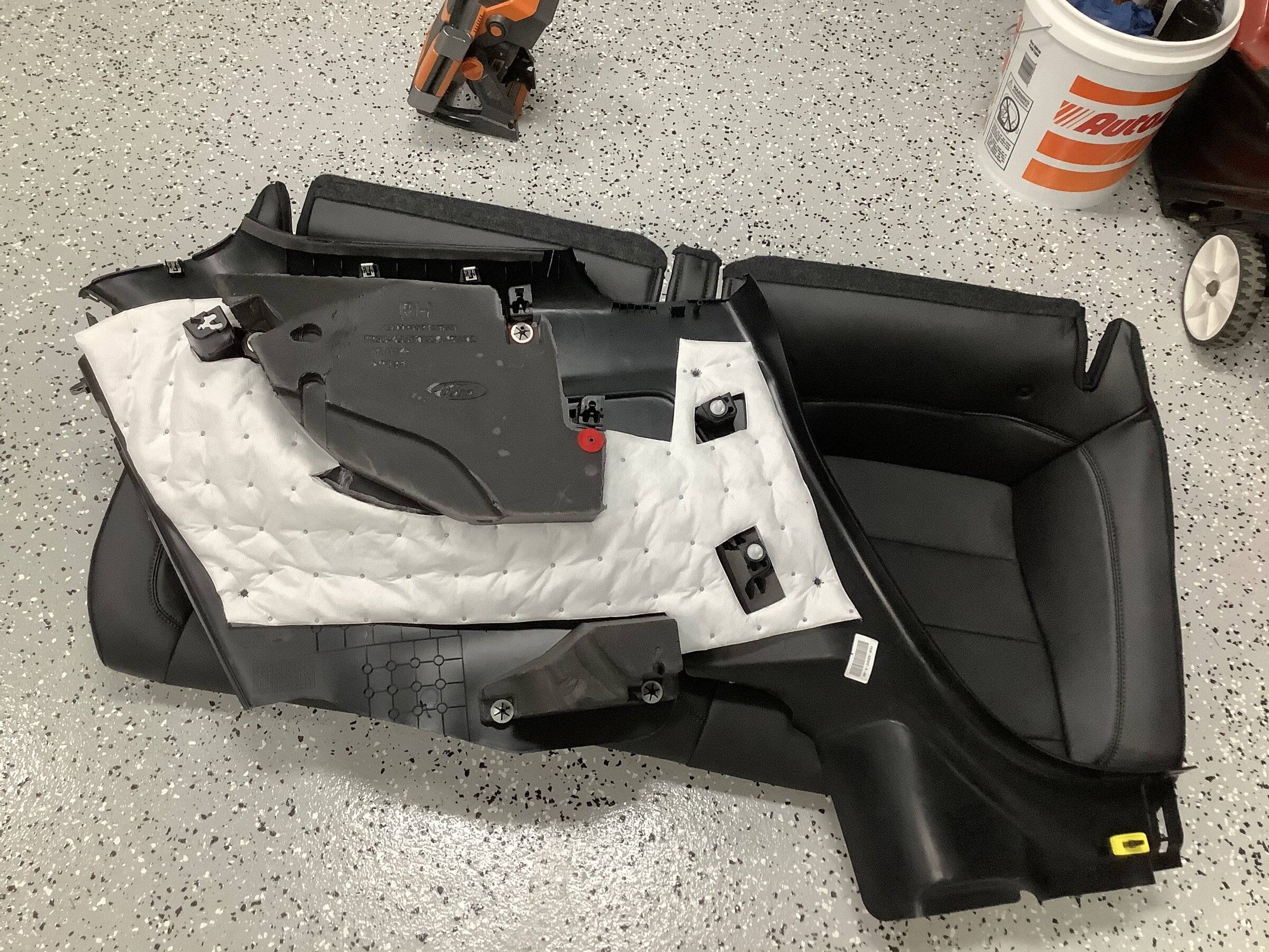

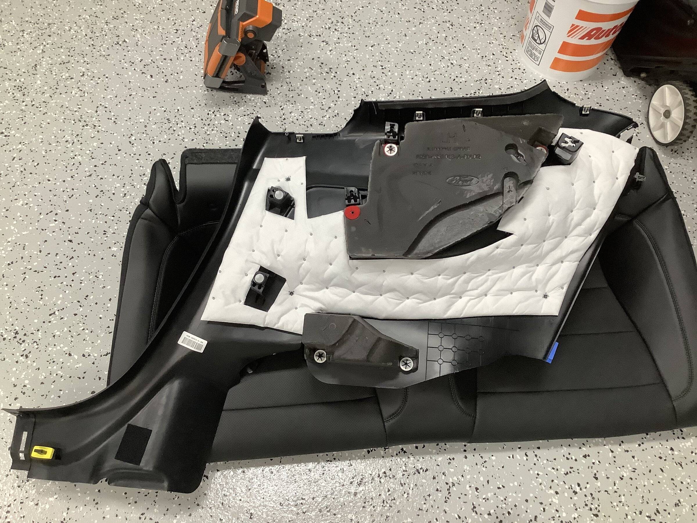

Not hard at all. Just go slow. The hardest part is fitting yourself in the back seat to do it. The rear seat bottom cushions are held by just two tabs. Once you remove the seat belt cover, the panel comes up with a gentle tug all around. The panel by the rear side windows are sharp -make sure you don’t yank it and scatch your pillars. The bottom of the panel is connected to the door sill trim. Make sure you release the clip as well.
NGOT8R
Jul 19, 2020
154
9,353
7,854
Adrian
2019 Bullitt
Here are a couple of pics of the backside of the rear trim panel for reference.
