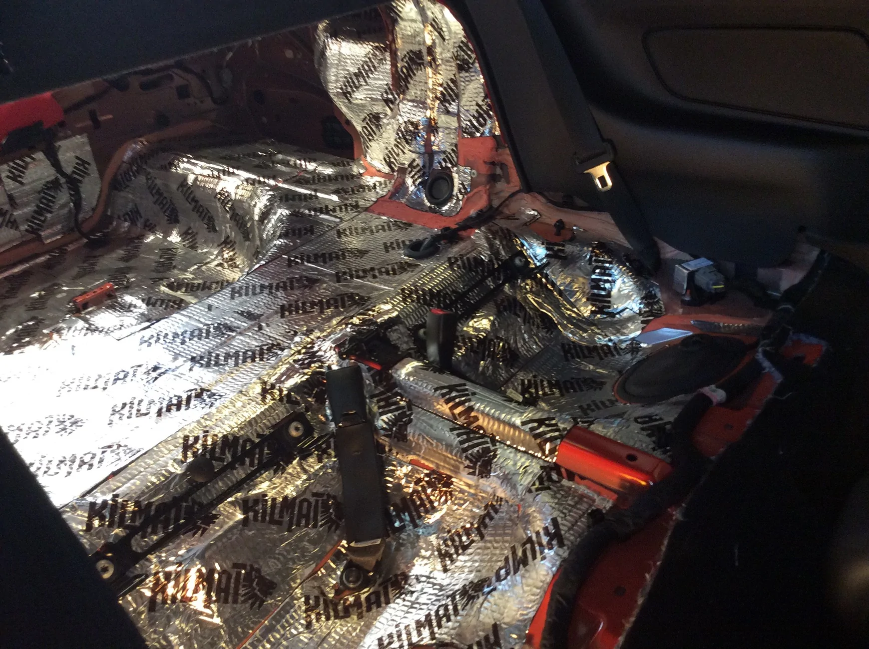

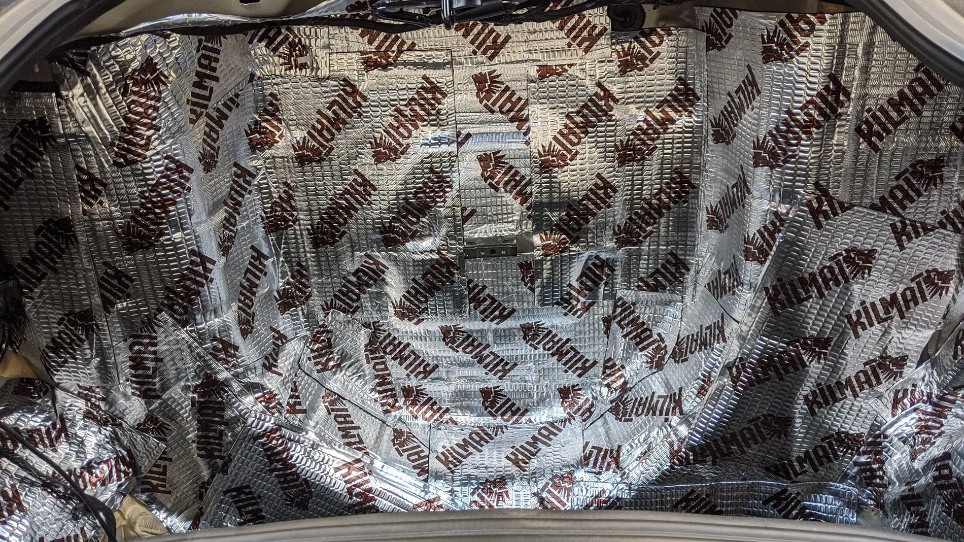

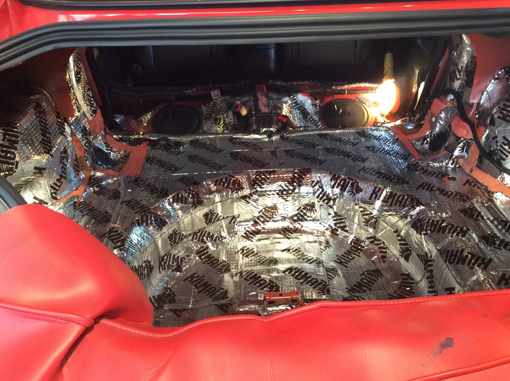

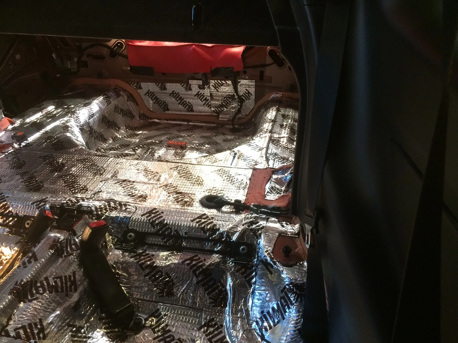

I did this in my 2017, but not under the car. Instead, removed all of the trunk liners, and the back seat and covered basically all the sheet metal from the back seat rearward. Definitely made a difference. Most of the noise you hear in the car is from the exhaust, and the rear tires. These were during the process, but ended up removing the plastic trim next to the rear seats as well to cover the wheel arches too.
That looks like a good way to go. Might pull the seats console and carpet and do the whole thing

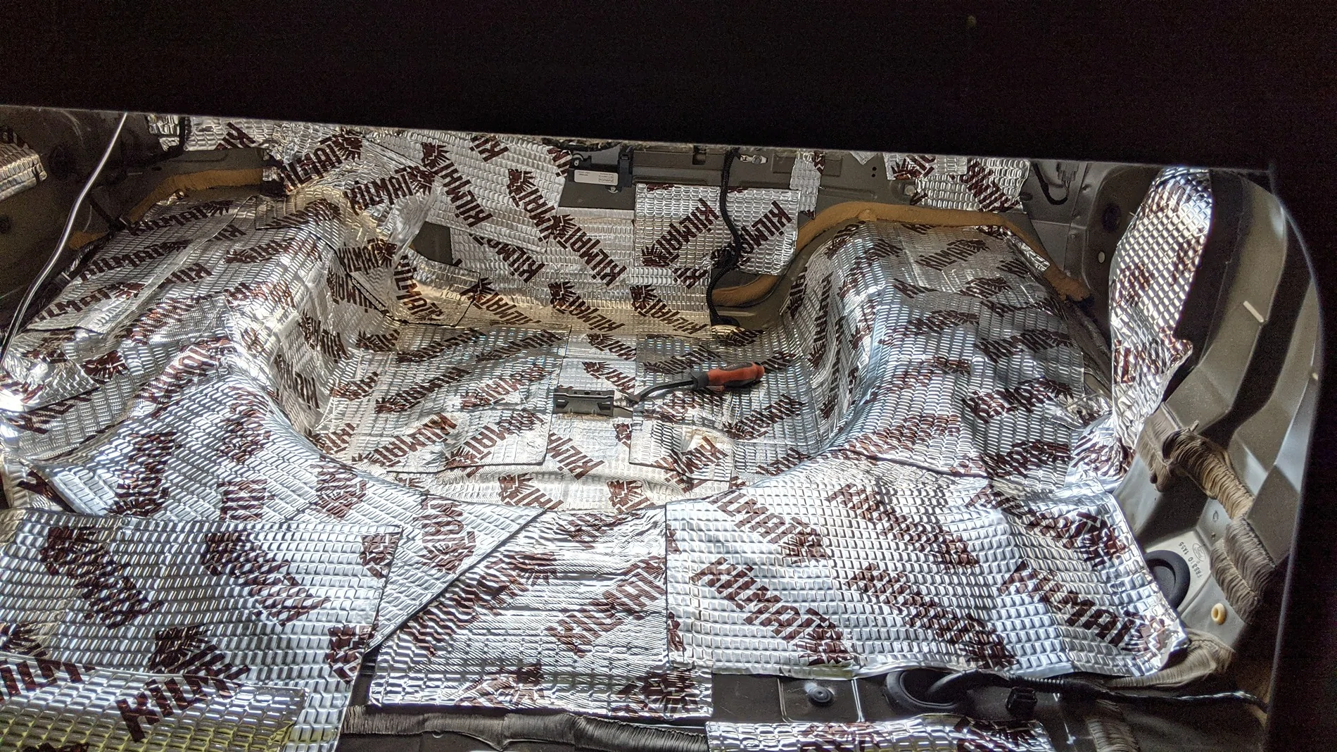

Did this a few years ago to my 15, still good.
