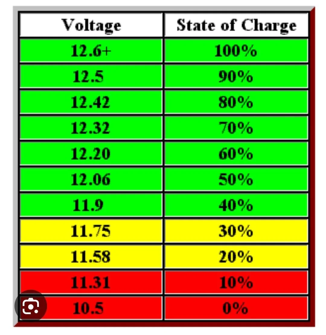

Also, 13.2V is probably what is known as a surface charge. That's kind of a false reading that usually happens immediately after charging. The best way to check a battery's health is a load test. Most auto parts stores will load test them for free. I will attach a chart that will give you a rough idea of a lead/acid battery's state of charge. Be sure to measure voltage after removing the surface charge.
