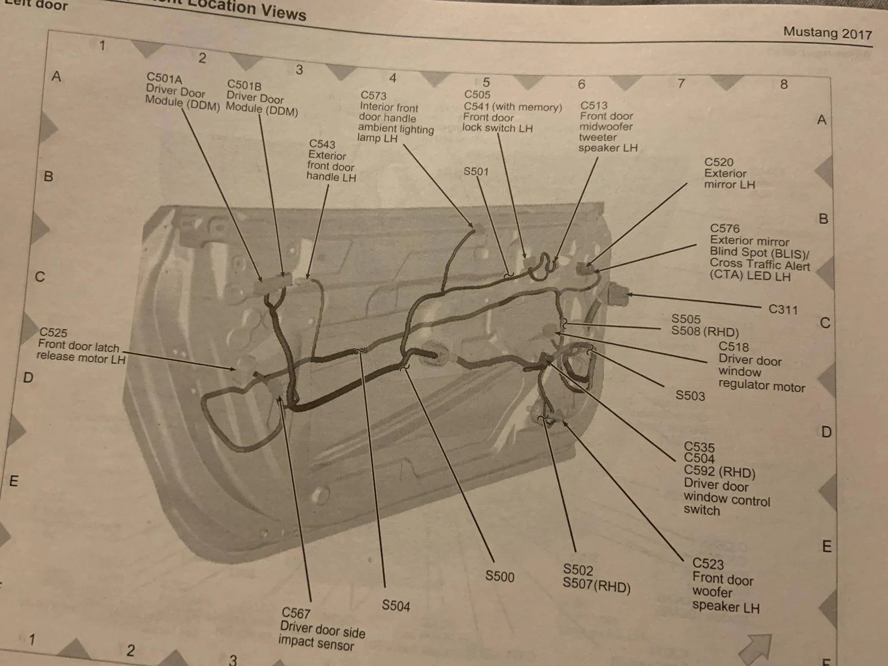

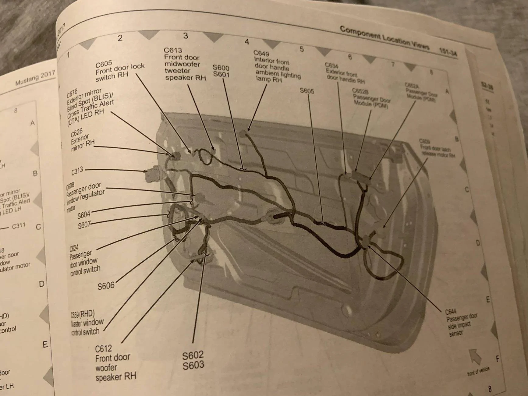

Attached are diagrams, highlighting on a 2017, where the fob antennas are. These are more for orientation, before removing the panel/s. Maybe focussing on one sensor and its interaction will help isolate the root cause.

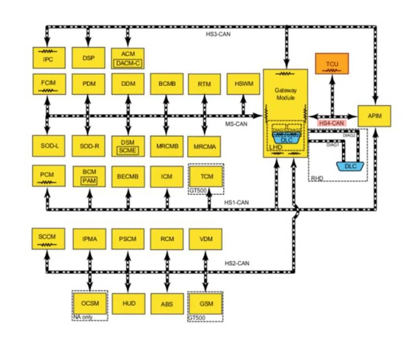

BCMB - Body Control Module-B (in the trunk)
DDM - Driver Door Module (Keyless Entry)
RTM - Radio/Remote Transceiver Module (keyless entry, TPMS, remote start)
In the last diagram, see the GateWay Module (GWM). Look at the network segment to the left. Everything associated with this issue is on that segment.
I'm not saying wiring is the problem, but it does go back to a systemic failure. I highlighted the special "dealer add-on" above. Could also be a failing GWM. Could be a loose connector in the area of the OBD/GWM.

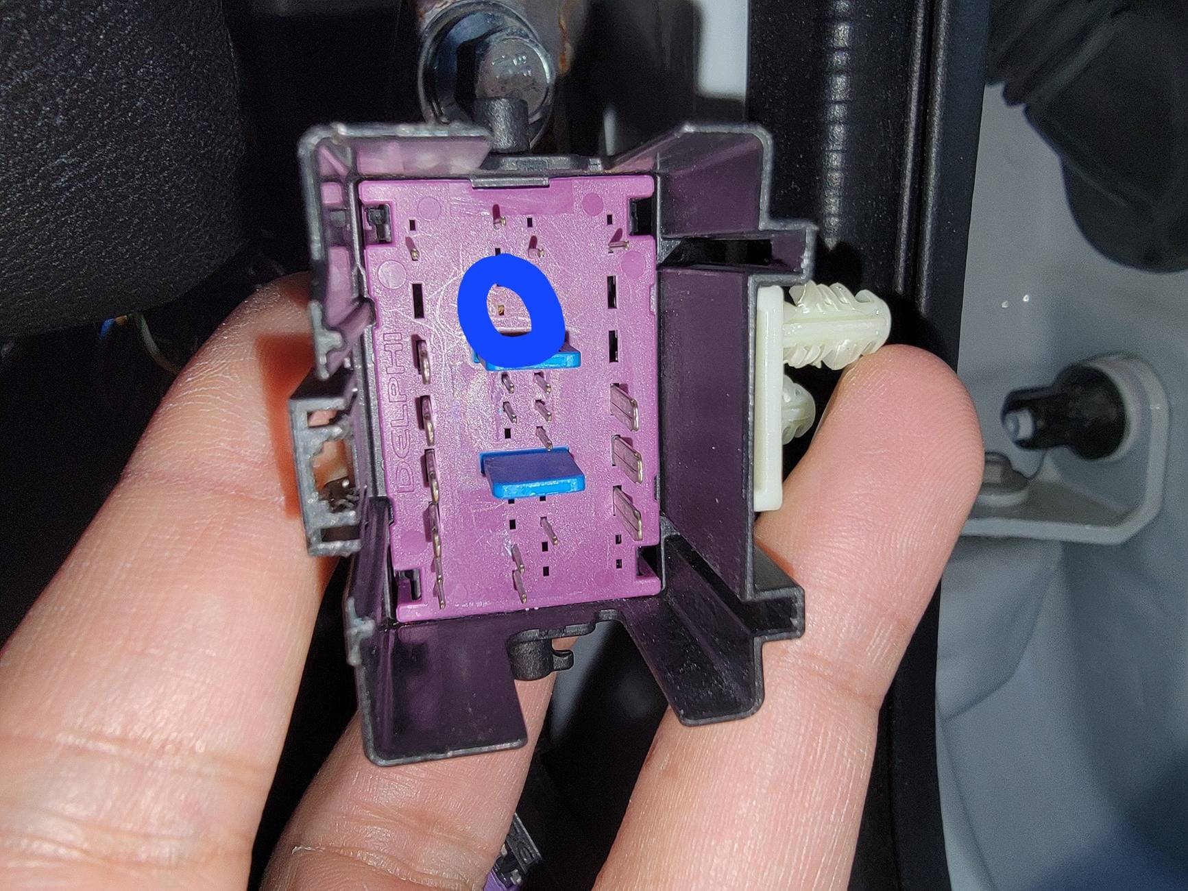

Hopefully help someone else who might go through the same thing. The problem ended up being a broken pin inside the wiring plug that is just after the BCM, connecting the wires to the back. The antenna power is actually only 2A to run the relay inside of it, which is a very thin wire. That wires pin somehow came off in the plug.

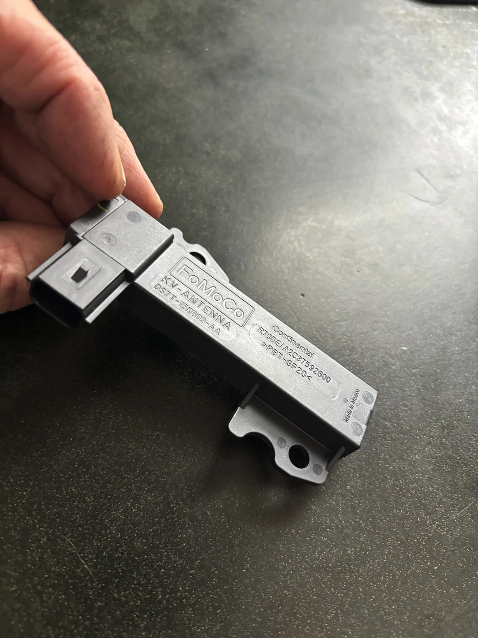

In case anyone needs to see what the FOB antenna looks like (Under cupholder) from my 2022 GT
