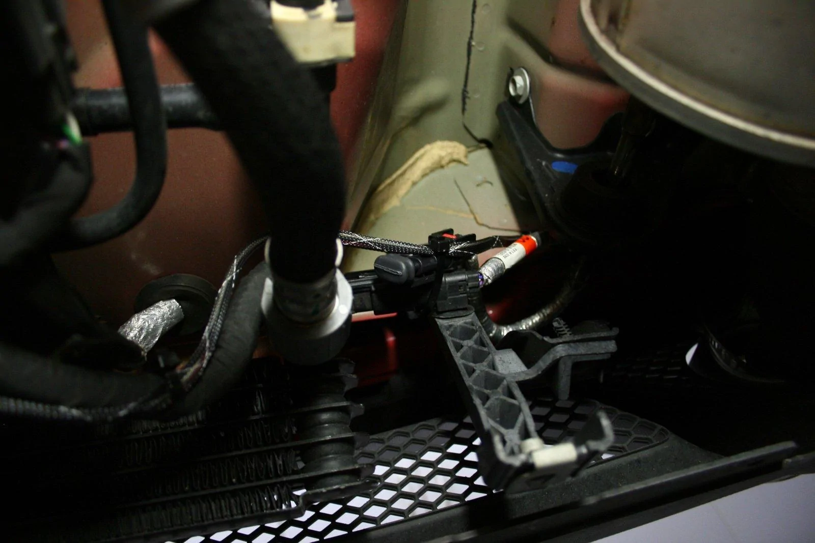

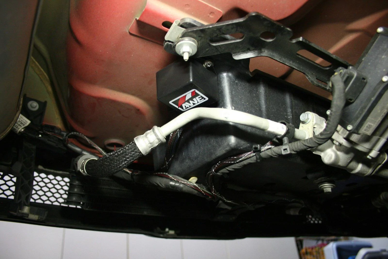

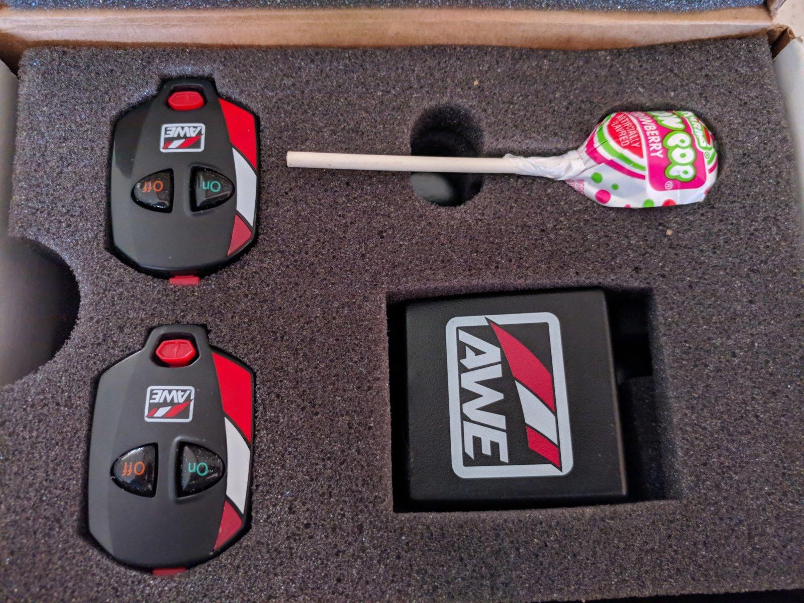

I installed the AWE SwitchPatch Remote on my car yesterday to give better control over my exhaust modes. I was going back and forth between this and the GrimmSpeed exhaust mode defeat modules but ultimately chose to spend the extra money and get the AWE remote since it give the flexibility of opening/closing the exhaust at the touch of a button. I didn't want to keep having to go under the car to plug/unplug anything.
The packaging of the module gave me a little chuckle when I found the Blow Pop in there :crackup:

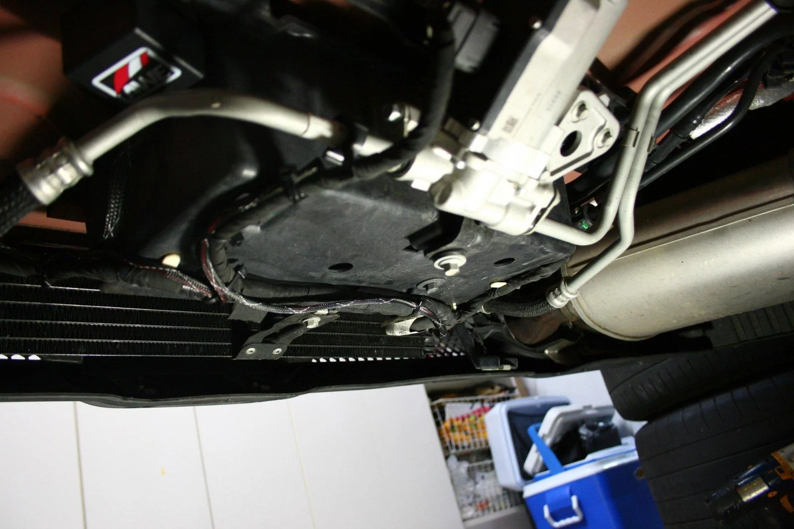

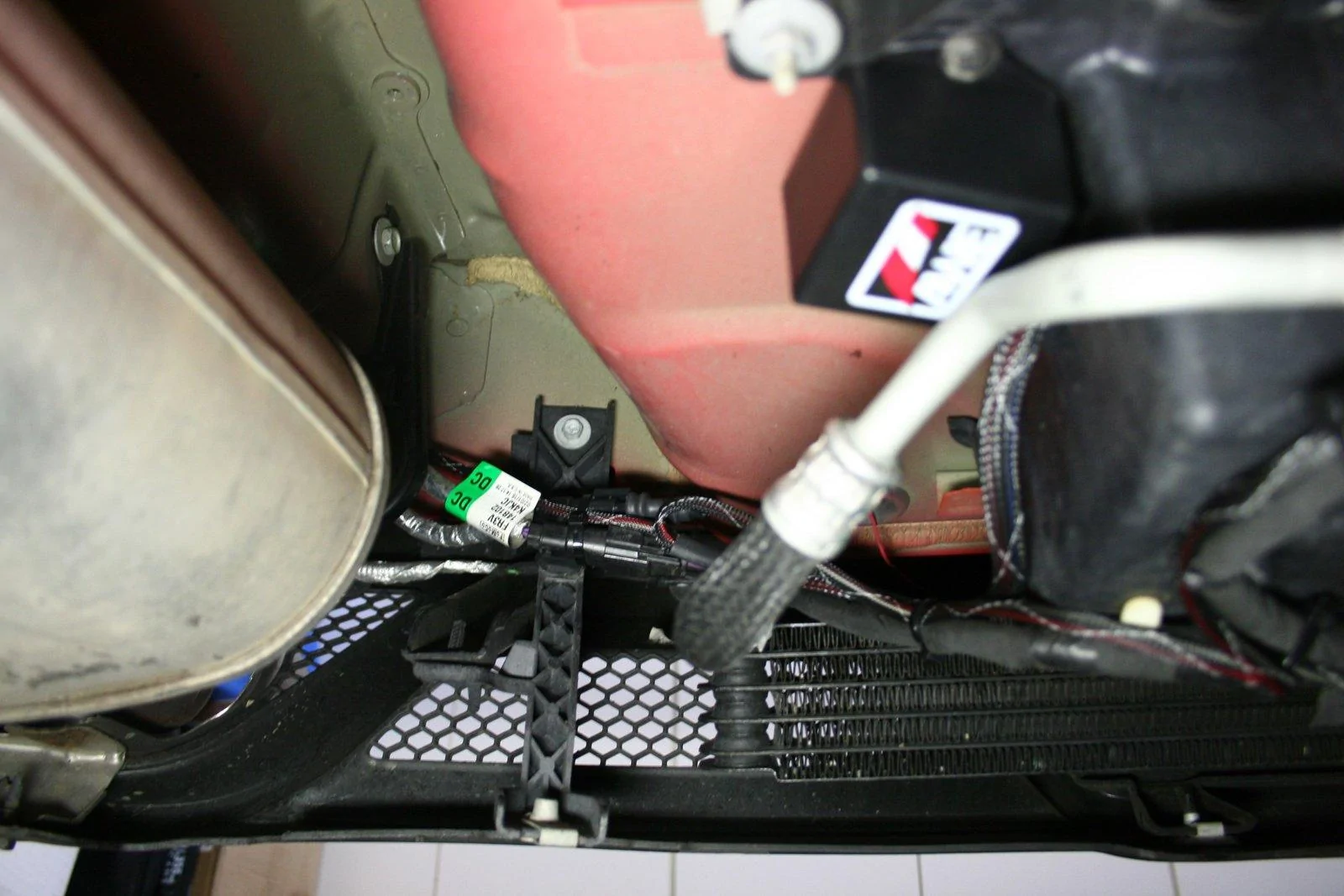

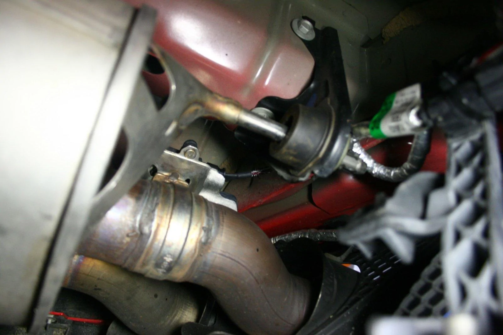

The installation was straight forward and relatively easy. First you have to remove the rear undertray/diffuser which doesn't take too long. 4 bolts and a few body clips and the whole thing comes right off. The part that was a real pain in the ass was trying to unplug the exhaust acuators. They are located on top of the muffler so you can't see the plug and it's hard to reach. You have to push open a locking clip, then push down a tab and pull the plug. Hard to do when you can't see it but once the first one is done, the second is slightly easier. I used a mirror and a small curved pick to see what I was doing. After plugging everything in, and tidying all the wires up, just put the undertray back together and you're set!
I had a few reasons behind installing this. The main reason was so I can keep the exhaust closed while going WOT so I can pass sound at Laguna Seca. Since you all know the flaps open regardless of drive mode, you have to lift while going past the sound booth to keep your sound below the dB limit. With the AWE remote, there's no need to do that anymore.
This will also allow me keep the exhaust open when I go into 6th gear even when I'm in Sport or Track mode so that's a nice plus! Oh, and it makes cold starts a little better because I don't have to open the exhaust back up every time I start it.
