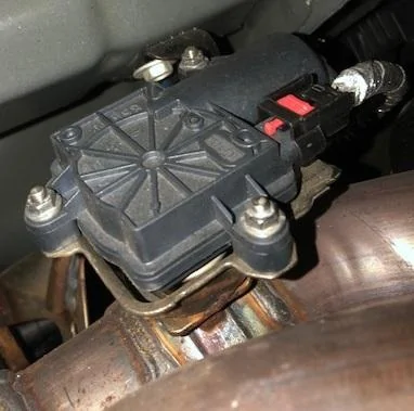

Hopefully the image below will help. it is the connector at the top the actuator. You cannot get your head up there to see it so you need to remove it by feel. I fumbled around for 15 minutes trying to get it disconnected until I snapped a pic and saw what it looked like. It was easy after that. Good luck.

A clip. and two bolts? Is that accurate? The clip provides power and ecu can read the AWE device from the connection. The two bolts are just to keep it in place?

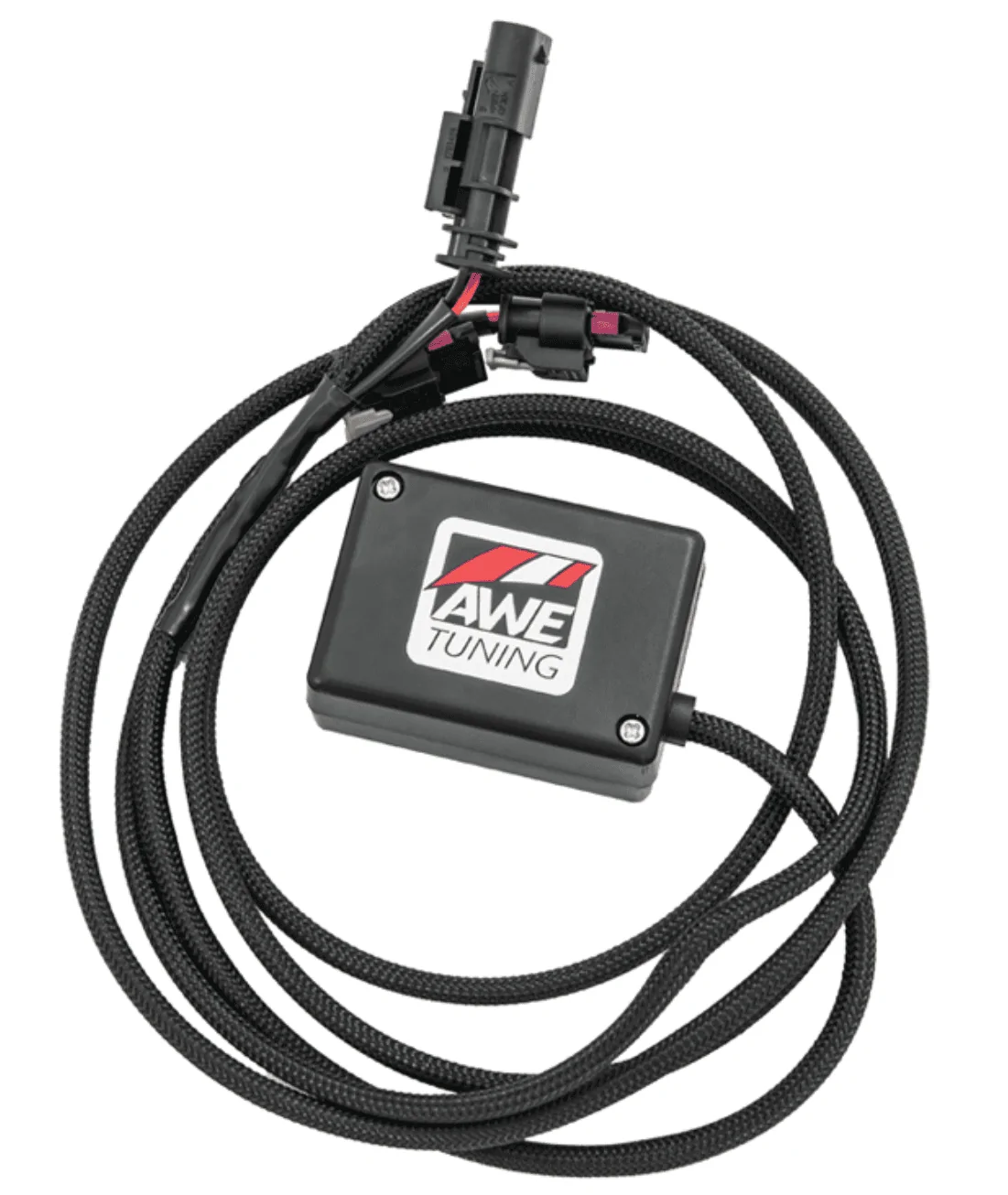

You don't remove or add any bolts. Only need to remove the black and red connector in @nordique14 pic. There's one on each muffler. The AWE kit gets plugged into the actuator and you get 2 other plugs that plug into the part of the harness going to the car's ECU. Those plugs are only meant to "trick" the ECU into thinking it's still plugged into the actuator so you don't get any CELs. The AWE kit doesn't talk to the ECU at all. The remotes only "talk" to the exhaust actuators. The car's ECU thinks nothing has changed and it can't tell whether or not the valves are open or closed. It thinks it's still controlling the valves even though it's not actually doing anything.
Hopefully that makes sense.

It does make sense. Is that why I read someone just zip tied the awe module onto that area? I would have thought it would have replaced the black device which I now assume is the actuator .

If you look at the AWE unit, it is just a black box with connectors. Just unplug the connectors from the top of a actuator (red tabs in my previous pic) and plug in the AWE connectors (purple connectors in the pic below). The other big black connector in the pic below is where you plug one of the connectors (red tab) that was removed from the top of the actuator. Then zip tie the black box somewhere out of the way. I am probably making it sound harder than it is. The tricky part is getting the red tab to release from the connector on the top of actuator as you cannot actually see it and must do it by feel. Once you do that, the rest is simple. On the easy-to-install scale, this is single wrench. You will probably spend more time figuring out a good place in the car for your remote.

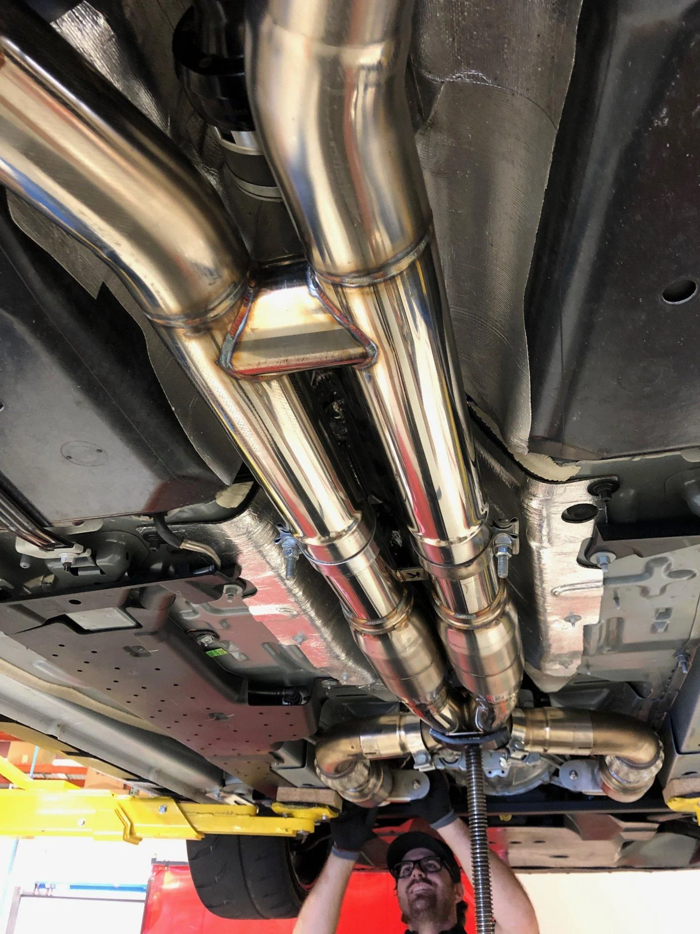

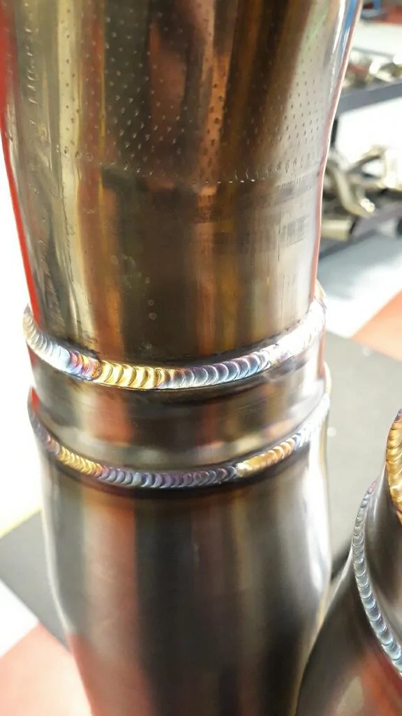

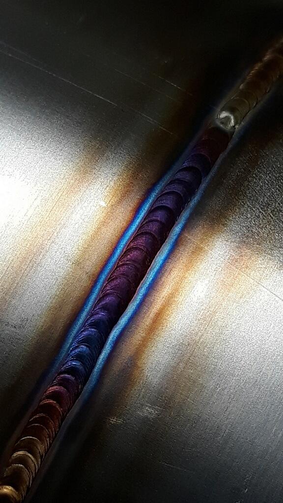

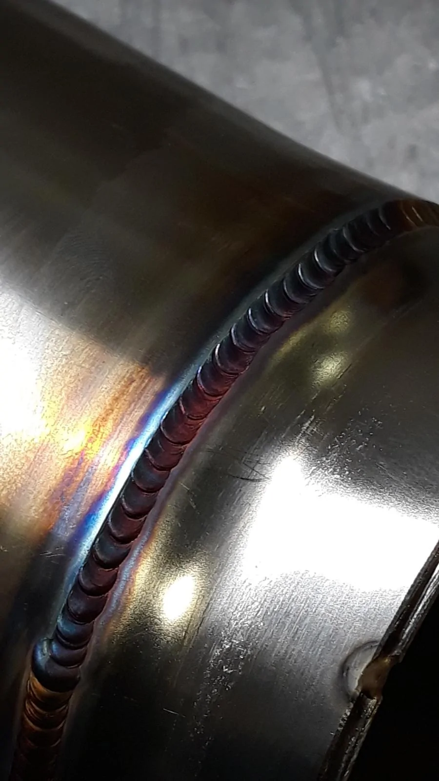

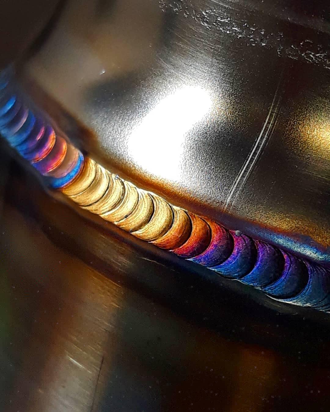

Here how the custom fab Kooks exhaust turned out. The sound is VERY good now. Low, deep and only about 15-20% louder than my factory R exhaust was. interesting that they fabricated a broader X pipe AND an H pipe at the back. Enjoy.

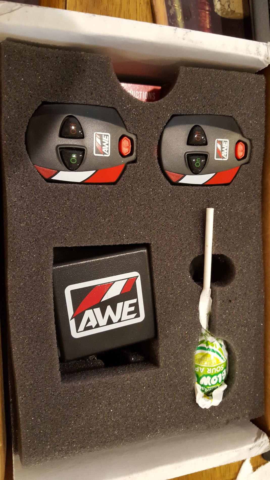

I just installed the AWE switchpatch remote to be able to control my R's valves (need to keep them shut at a local track, want them open in 6th on the highway and at startup)... https://www.awe-tuning.com/switchpath-exhaust-remote
Install was ok, i used a small flathead screwdriver to push that red tab outward, then long needle nose pliers to help pull the wires gently while pushing the tab down once the red lock tab was pushed out. I had a mirror extension to see what was going on, but it's a blind job by feel with a lot of scrapes on my arms...
Testing it out, the valves still auto close when I press the clutch in to start the car :(. The remote works as it should, open/close on command, and the car systems no longer can change the valves, with the annoying exception that upon startup the valves still close. I can press clutch in, hear valves close (they don't flutter open/close like before, just go straight closed now) then hit the remote button to open it and then start the car to have a 100% open valve startup and not have to toggle further buttons, BUT I didn' think I had to hit open on the remote every single time I start or before I start the car, that they would just stay open always until I press the remote close button???
Need to do a road test tomorrow, see if they stay shut in quite WOT (to keep my local track with a noise ordinance happy) and if 6th gear will stay open for me. If these things work, I'll probalby still keep this, but not thrilled the valves are auto closing on startup...
