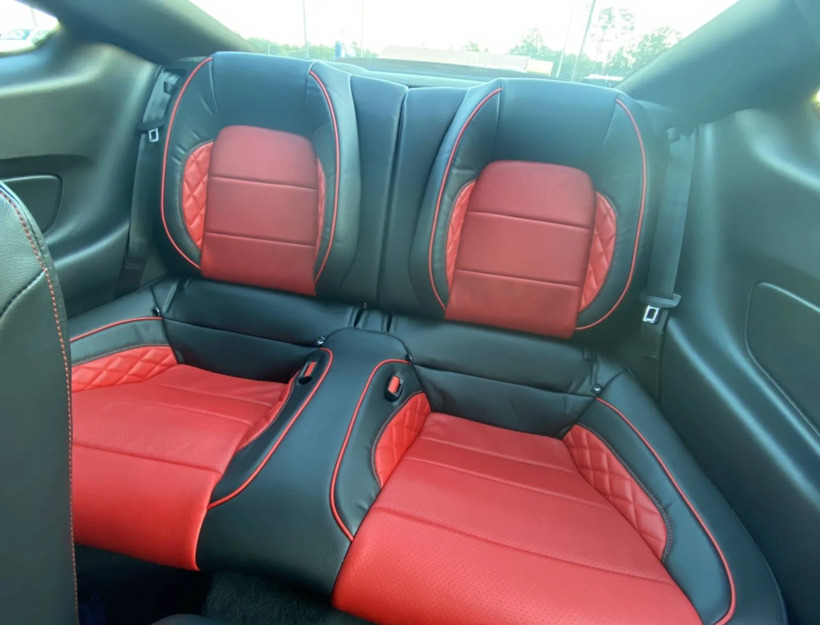

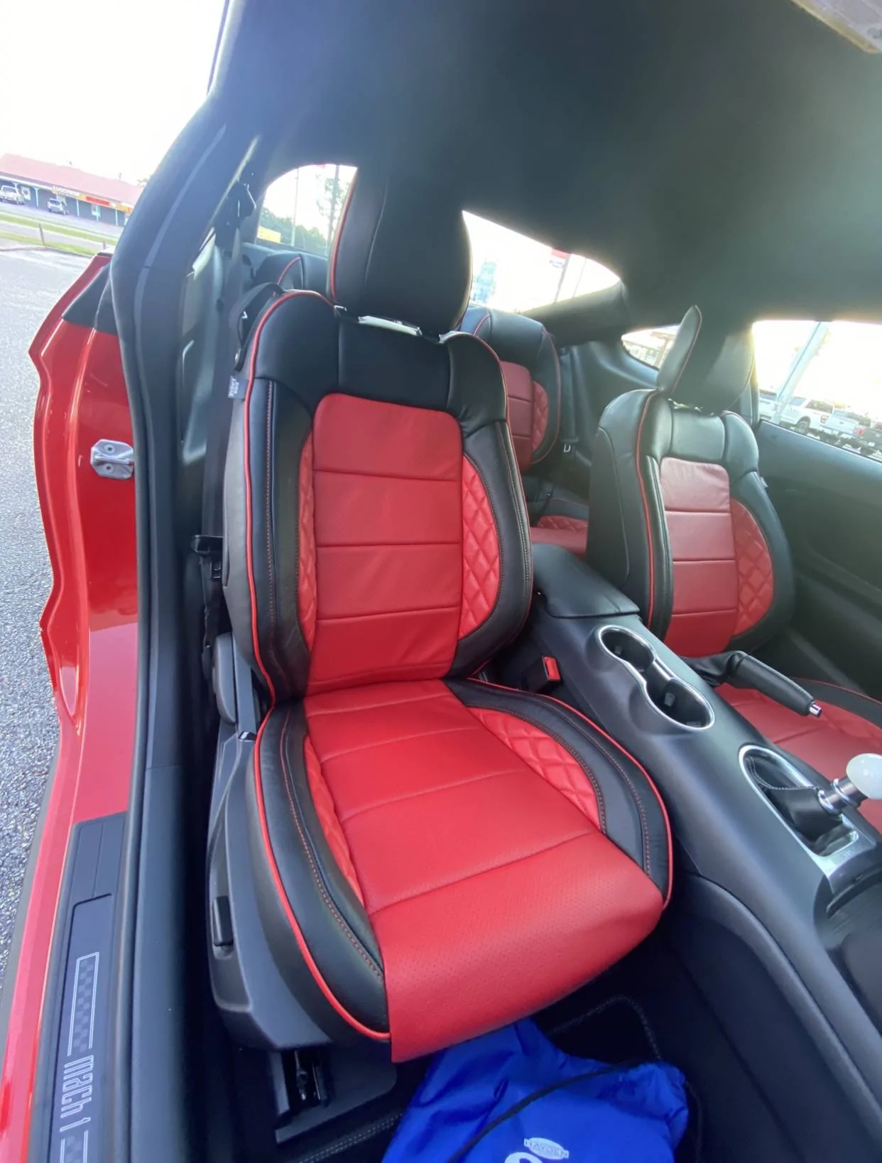

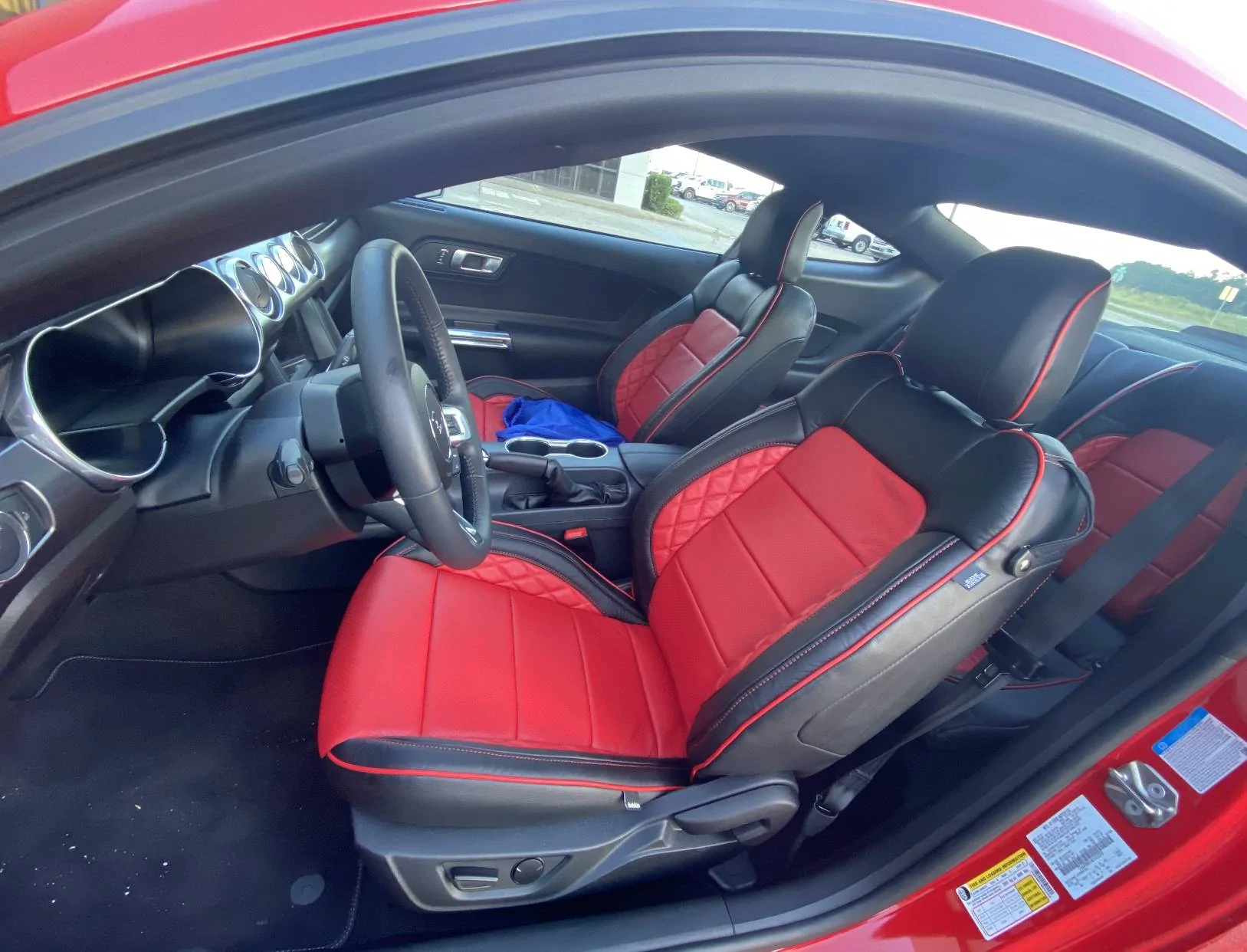

I had Katzkin covers installed on my GT500 Recaro seats. Had a local vendor do the work. The online configurator leaves a lot to be desired. If you work with a vendor they can give you way more options as far as stitching designs and panel colors.

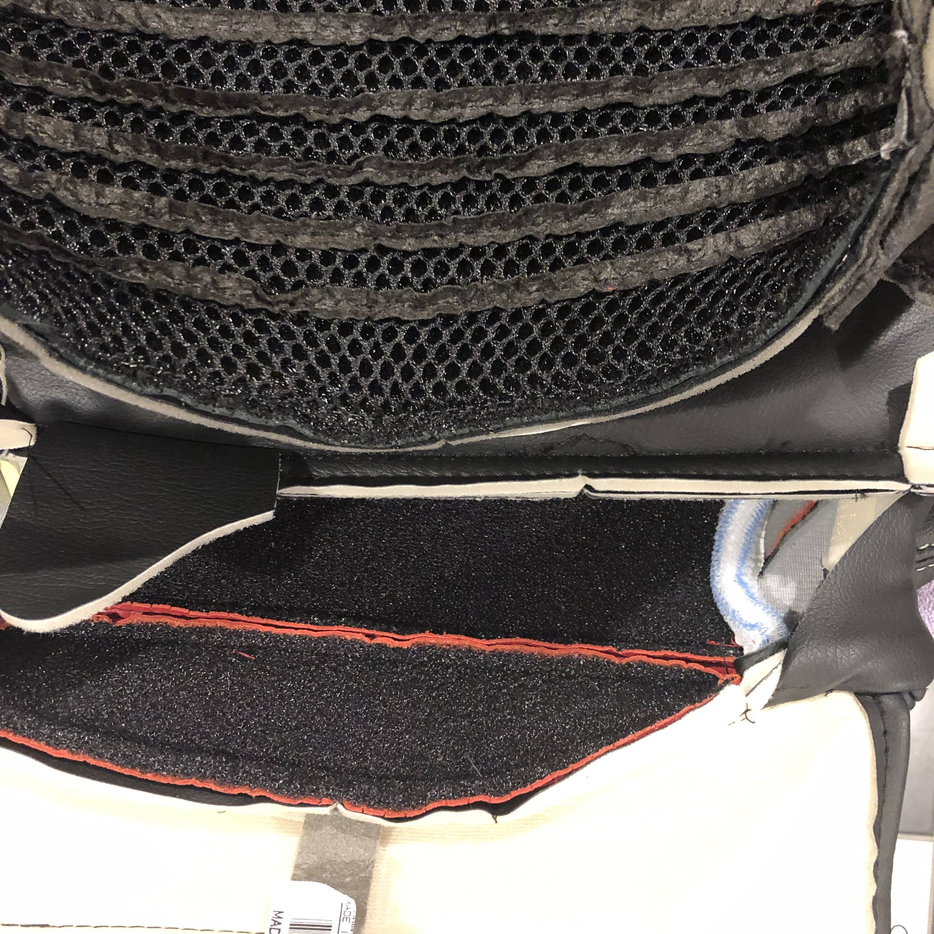

Finally getting around to installing the covers and running into some issues.
Here’s a pic of the stock front seat back inner foam on top of the Katzkin foam. The stock material is like an open mesh for the cooling function but the Katzkin is just plain foam.
Also, there are no holes in the front seat backs for the two headrest posts, the magnetic button for the seat belt strap, or the handle in the back of the seat back that allows the rear passenger to release the seat back forward so they can exit the back seat.
At a dead stop with stock covers removed, awaiting instruction from the seller.

Sorry man that sucks. Are you sure you even got the right covers? Too many omissions to even believe it was a mistake. Maybe the foam as they didn’t realize you had heated/cooled seats but the rest have been standard on the S550 since day one.

So the seller confirms that even though it looks different, this is indeed Katzkin’s cooling-compatible foam. He also confirms that yes, you have to use the stock seats to makes templates out of paper and painter’s tape and cut all your own holes in the Katzkins. Sigh… the job just got a lot harder and introduced a lot of room for error. I did find a YouTube from LMR that shows how they did it, that will help a lot.

Also, just noticed that the backs of the stock front covers are perforated to allow airflow into the little fan in the back of the seat, but the new covers are not perforated, wonder how air is supposed to get in there now.

If I did it, it's not that difficult. Just make SMALL holes and cuts. For the headrests make two small slits in an x pattern. No need to actually remove any leather.

Not sure about the foam, but regarding the missing holes for the magnetic button, release handle and headrest, this install video from Leatherseats.com shows how their installer cuts these with the cover installed on the seat back. Thought you might find it helpful.
