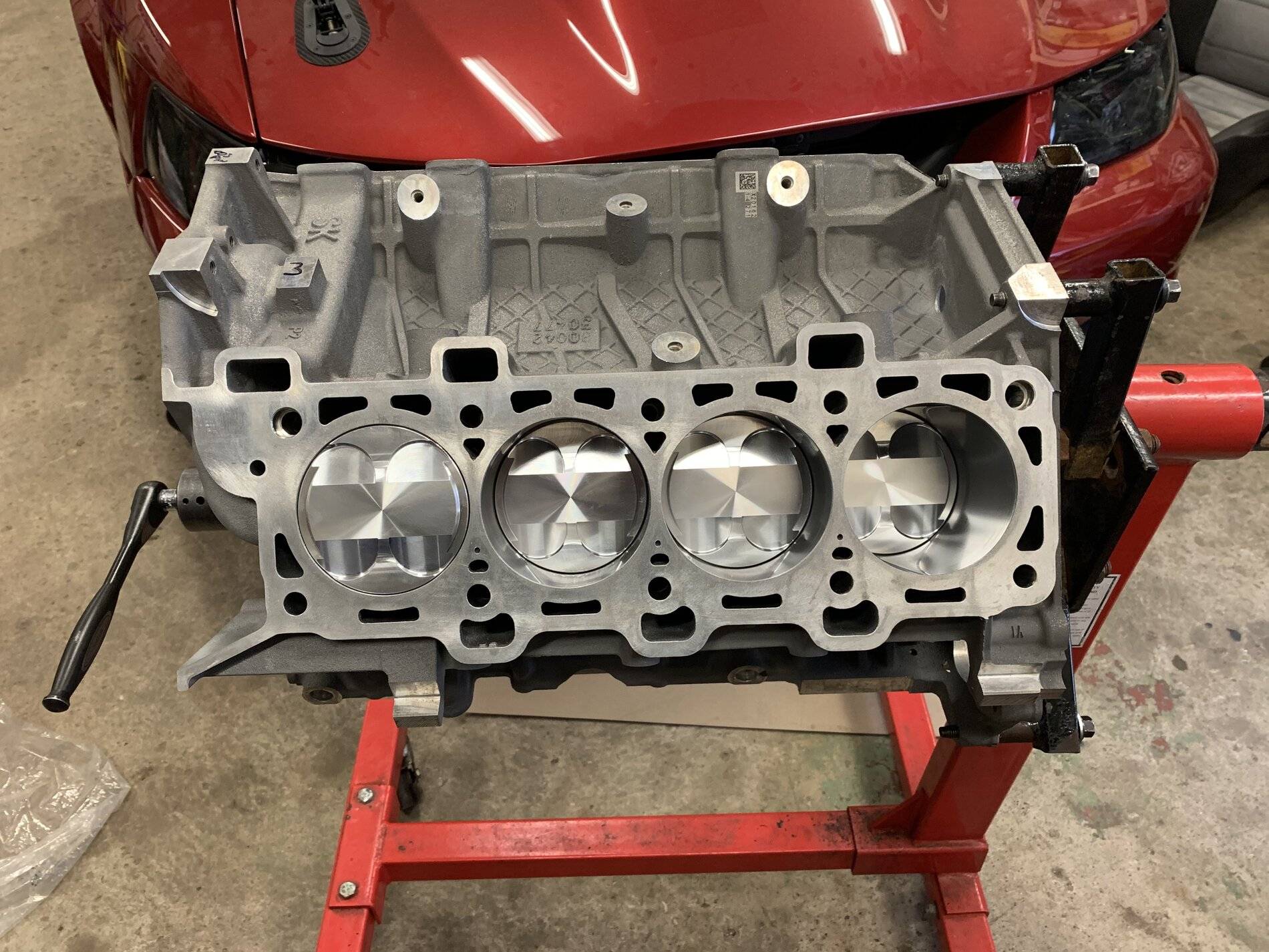

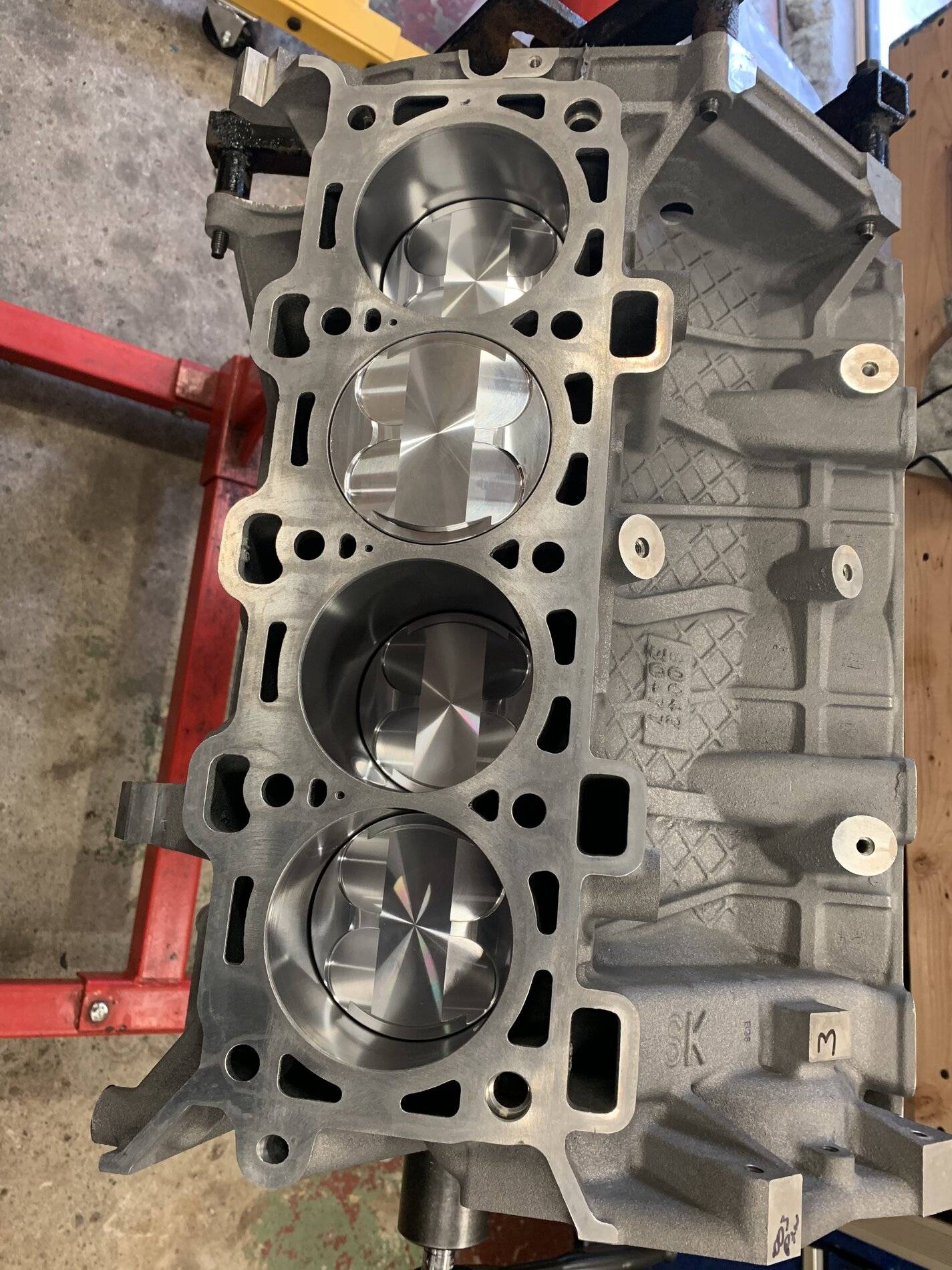

Haha...yeah, it's out in my shed double bagged until I can get it to the fabricator for mock up then machined and built.
Plan is a 65 Falcon Drag Week turbo build. I know I'm in the wrong forum for that type of car, but this is the only site where there is any decent tech on 5.2L Coyotes.

FYI, that is a voodoo block not a Predator block. Voodoo has oil squirters fed from mains, as you can clearly see in your pics. Predator has valley fed squirters and milled areas on block interior for larger rod big ends/bolts.
Other than that, same block.

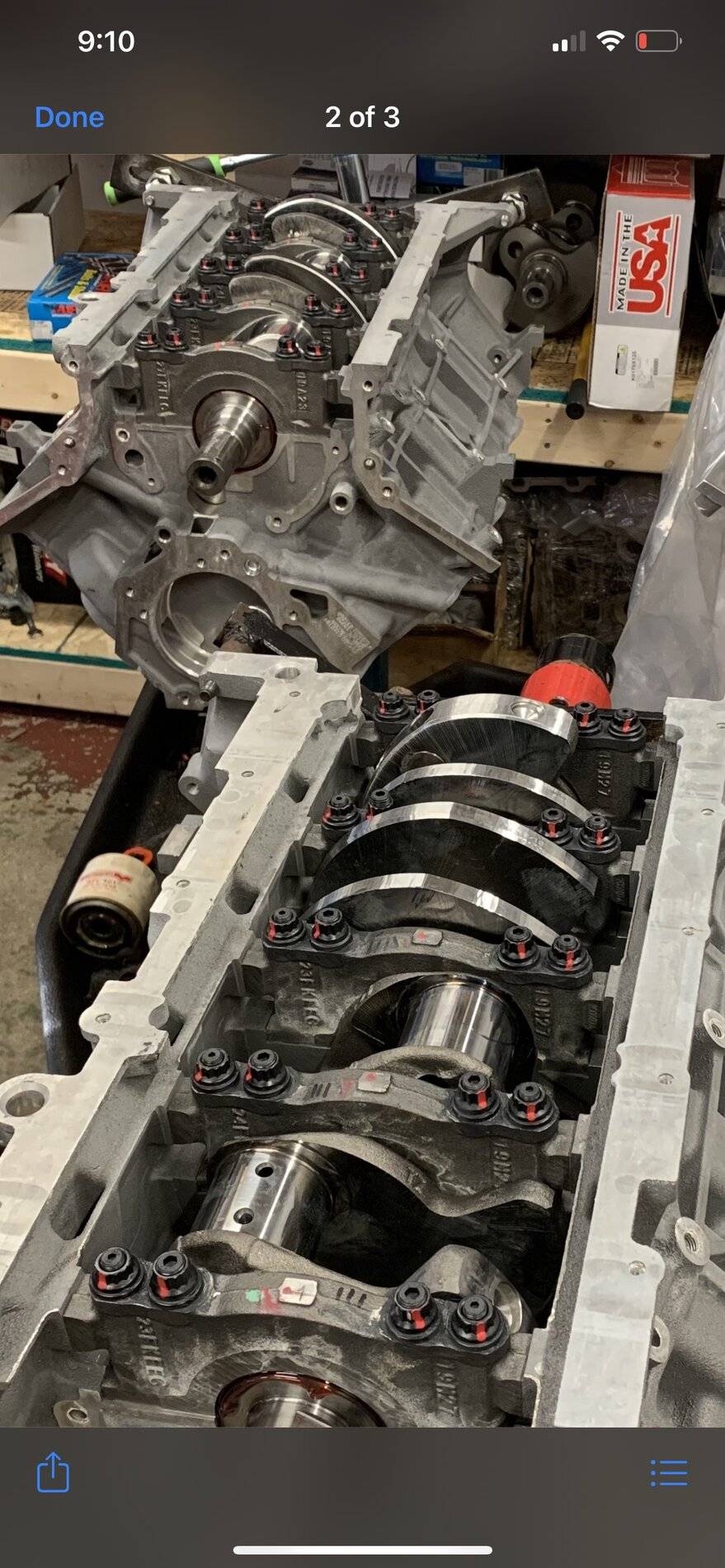

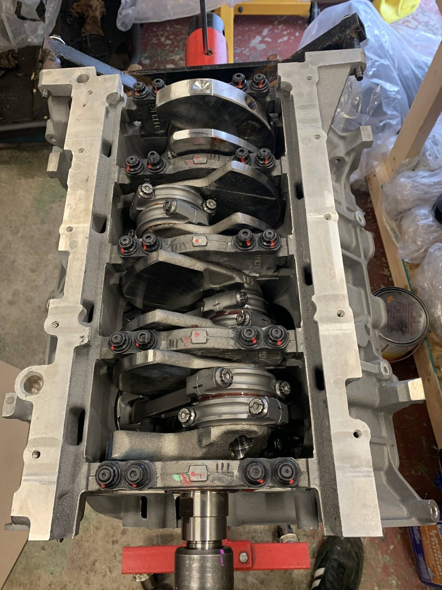

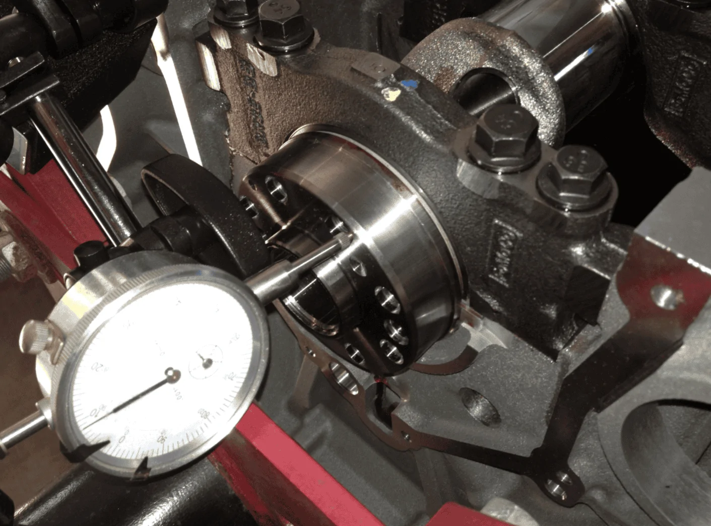

Here are 2 short blocks being built with the Voodoo block .
Front block has Boss crank and the one in the rear has Voodoo crank .
I cant tell the difference from the pics but maybe the resident experts can .
regarding cost ... let’s just say including labor the 5.2 /Gen 3 long block is going to cost much less than the Ford performance Gen 3 alluminator and have much much better internals (Wiseco rods /JE pistons ).
I also have another long block build more similar to the alluminator (same block/pistons but H tuff rods instead ) that is even less since the coyote block can be had for $800 ..

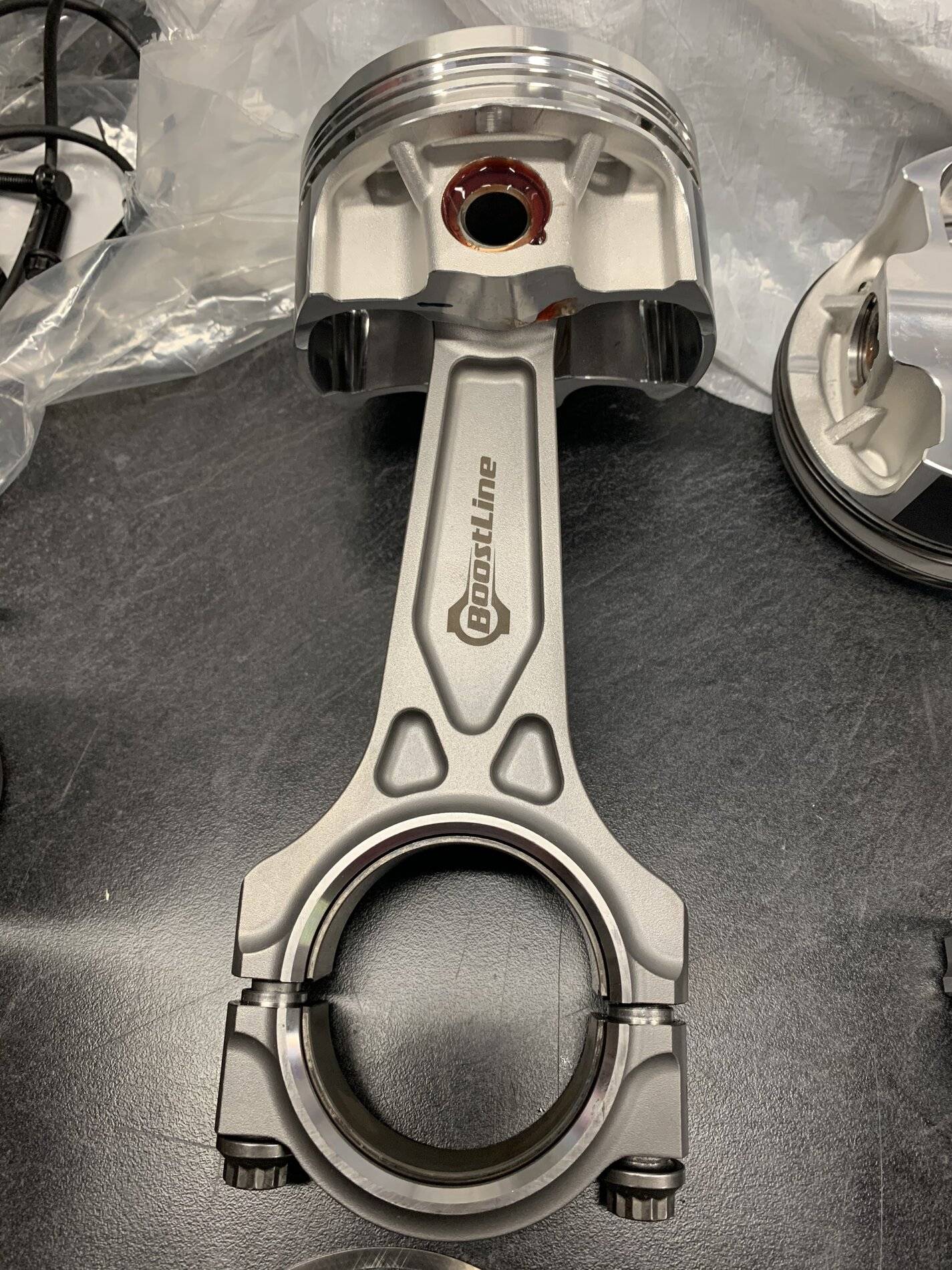

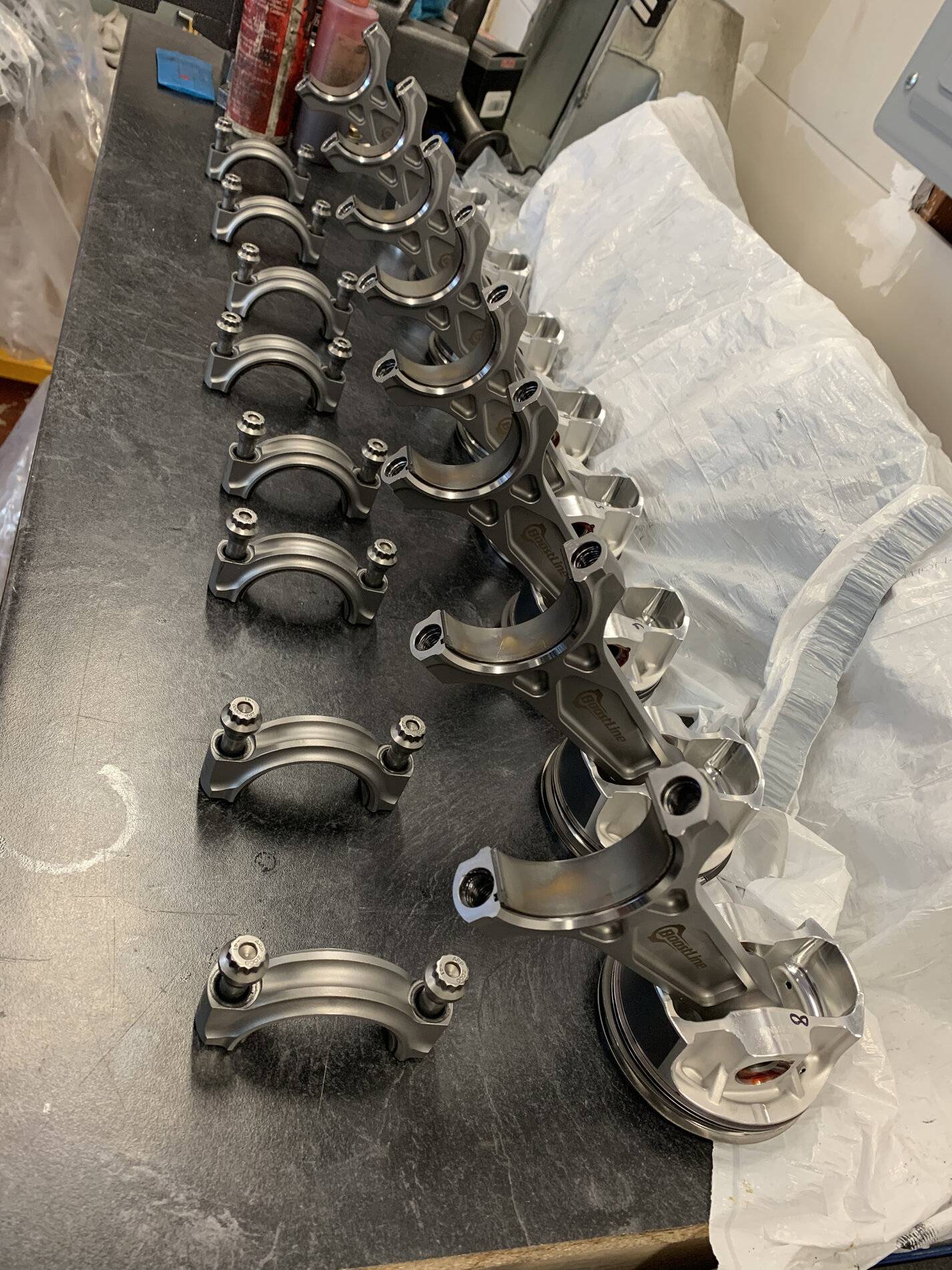

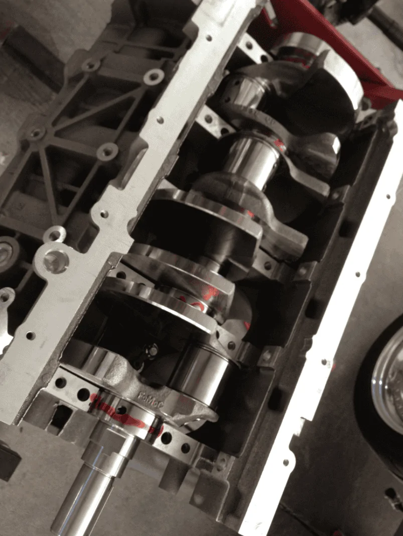

Some more engine porn . LoL
5.2 cross plane SB is done . Crank is double keyed .
Builder will complete long block with Gen 3 heads /stock cams /upgraded springs /Head studs .
