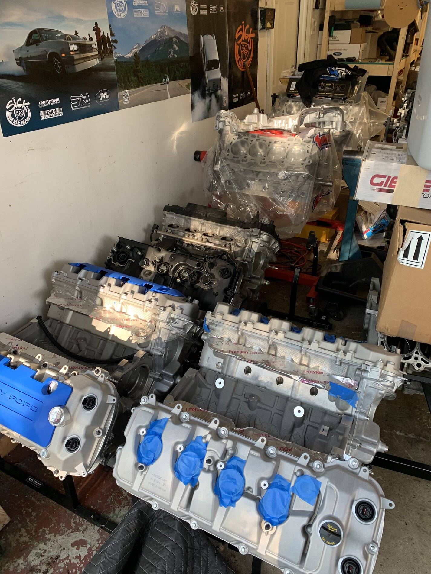

lawdhavemercy, how many motors do you have?

Lawd .. I think I may have a problem !
its become a bit of an obsession but I decided I was going to keep at least a spare long block for each car . I have 2 15’s (each one has a built motor in it now ), an 18(still stock motor ) and a GT 350 (also built motor and it gets two spares ... because it’s special🤩).
More recently I picked up a couple of fox body rollers to swap so each one will get an engine (and a spare ) .
I am little obsessed with “5.2”s so both 15’s currently have one (and a 5.2 spare).
The fox bodies will get their own “5.2 “ and spare .... one may get a Gen 3 (with 10r80 ) and the other a Gen 2 (6r80 or TH400)
The 18 has a “spare “ built 5.0 (but I may end up using one of the 5.2’s. so she does not feel left out lol) .
Not sure what I will do the stock long block in the 18 now but it will probably get built at some point if I don’t sell it.
I will also end up with another stock Gen 3 SB - I bought the long block cheap to build but ended up getting a new SB to use with the heads .
not sure what I will do with it either- may sell or build it too .I have a “spare “ set of Gen 2 heads I may throw on it for a “Frankenstein “ build .
Yeah ... I know thats a lot of engines but I know I will never end up being down for the season if I lose a motor .
best case scenario I never use them , and if I sell the cars I can offer them as “warranty “ ...... or start my one retail engine shop ... no waiting in builds !

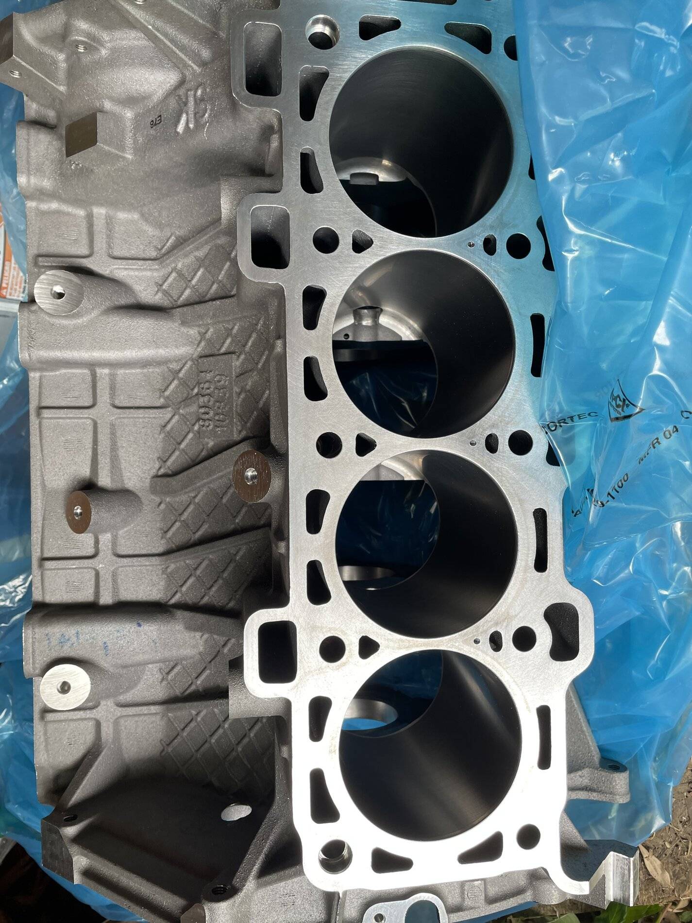

5.2 Voodoo block
Voodoo heads
GT 500 spec cams
5.0 crank
Cobra Jet Intake
Perfect for any S550.
Depends on the year. Gen3s will have issues with heads. Also, the predator cams use a different reluctor wheel so they may not work with earlier ECUs.

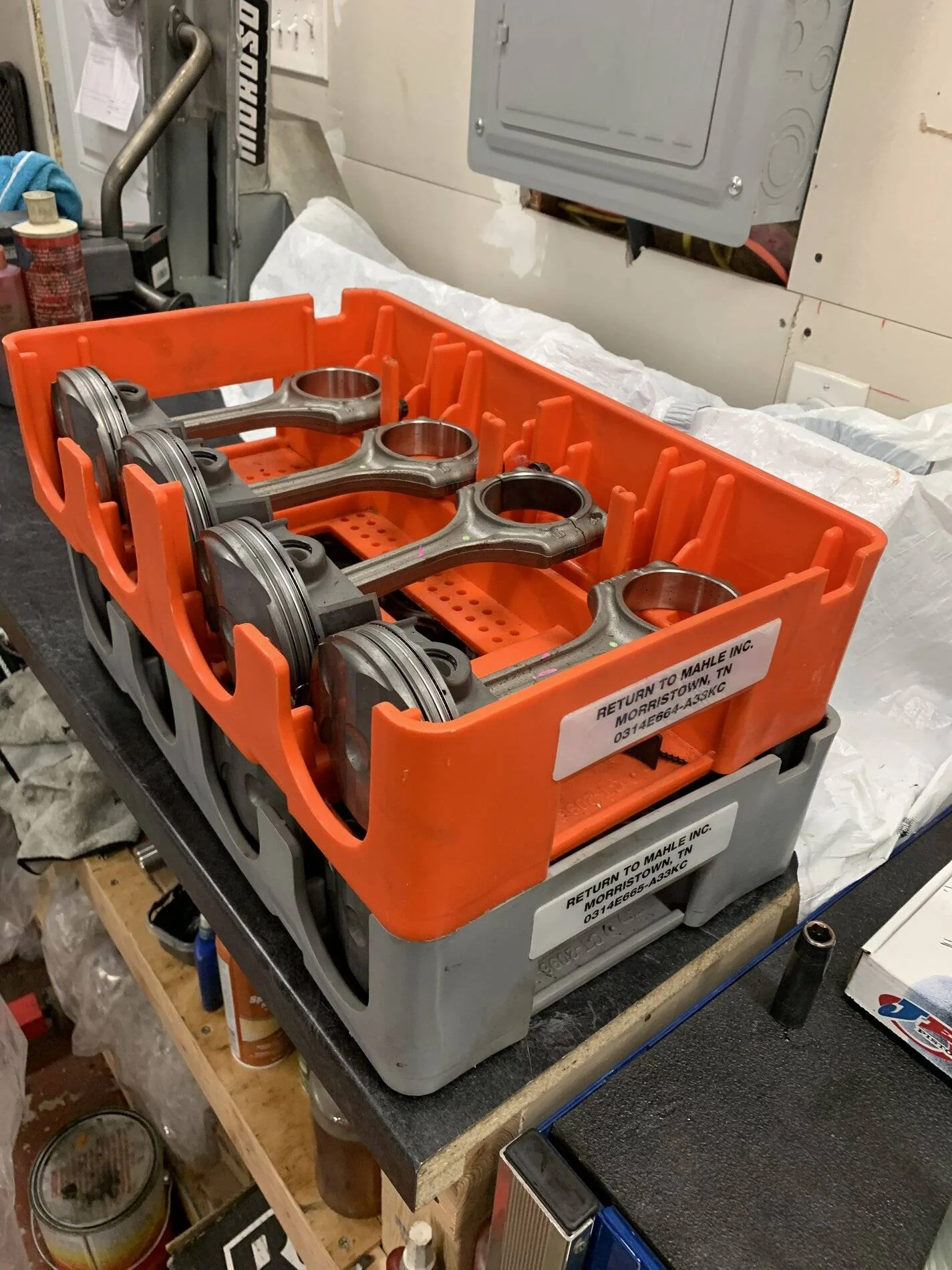

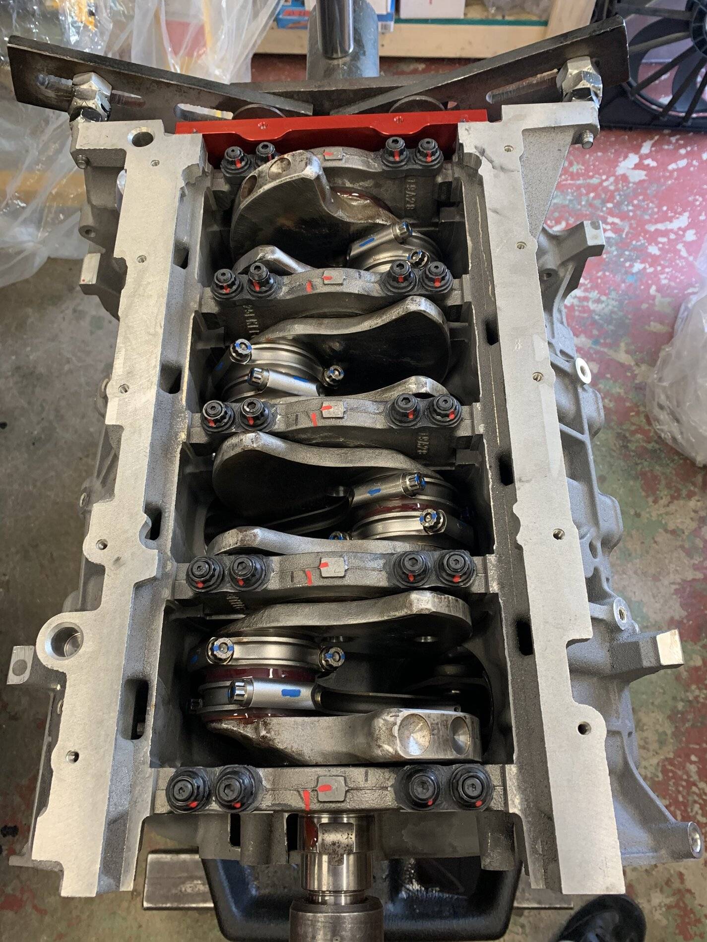

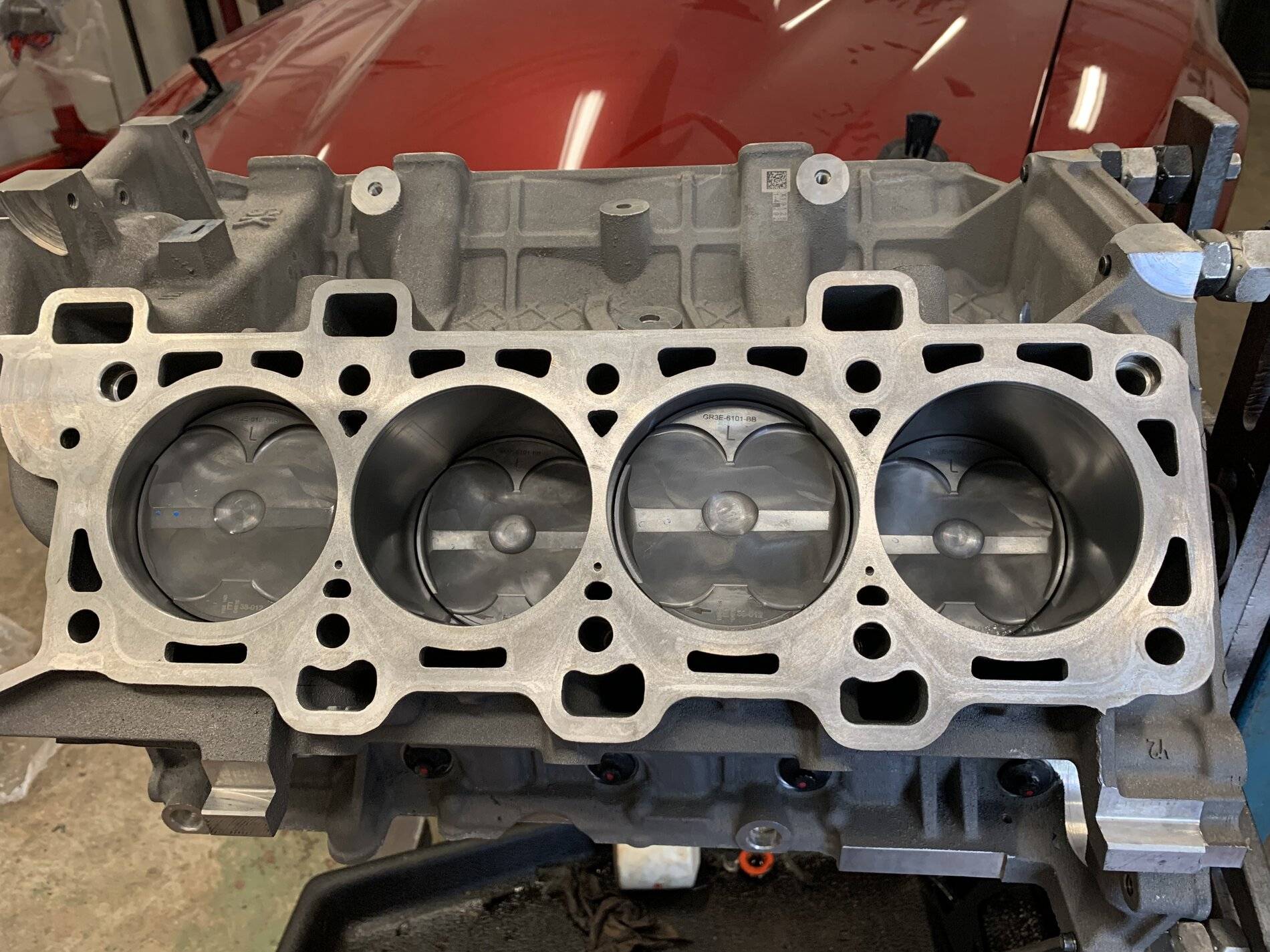

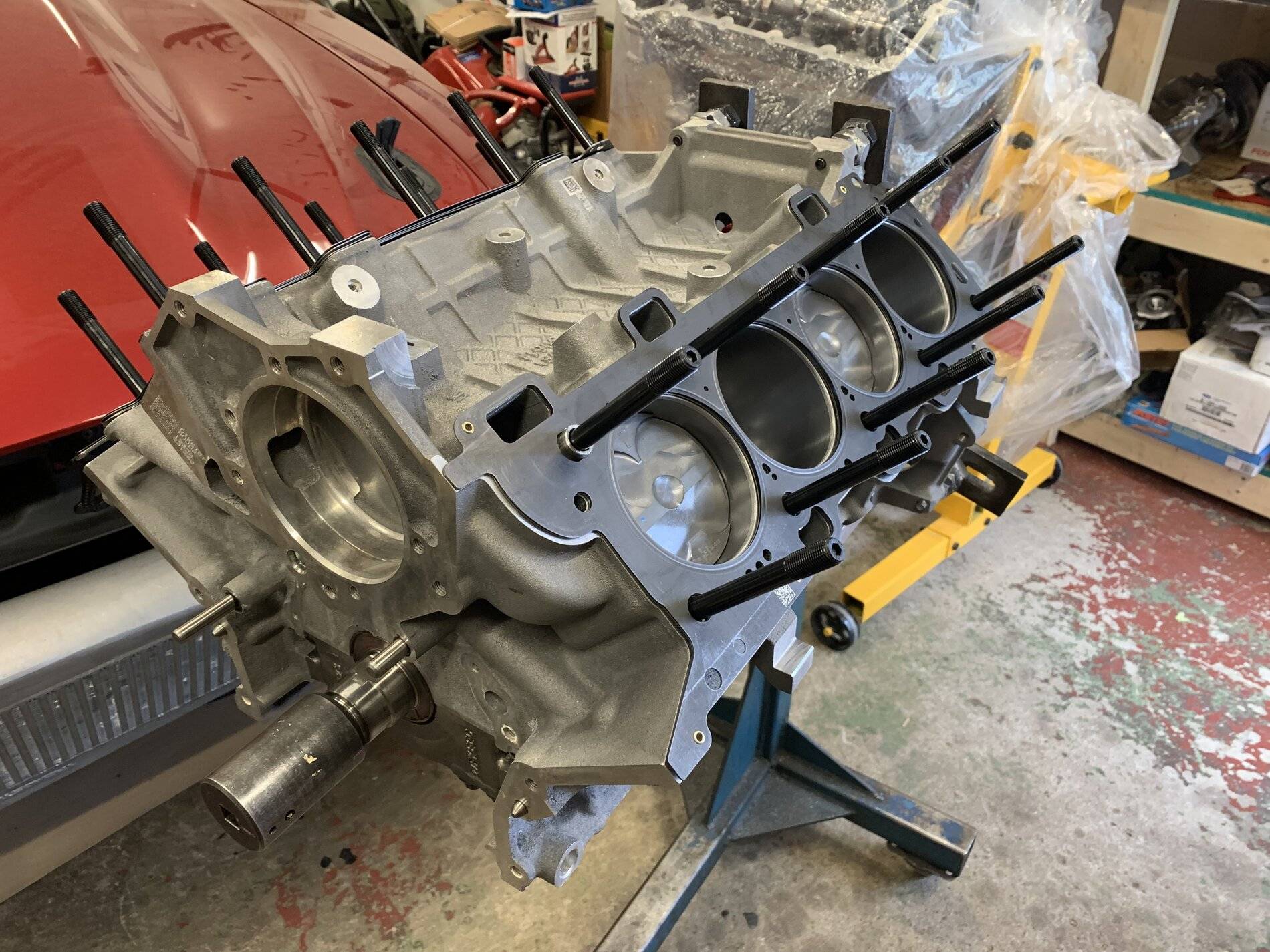

“Gen 2” Voodoo short block(flat plane ) is done and starting on long block assembly . Mahle pistons (stock voodoo) and Manley H rods . GT500 head gaskets and ARP head studs (long 12 mm).

Nice. Line honed for the main studs?

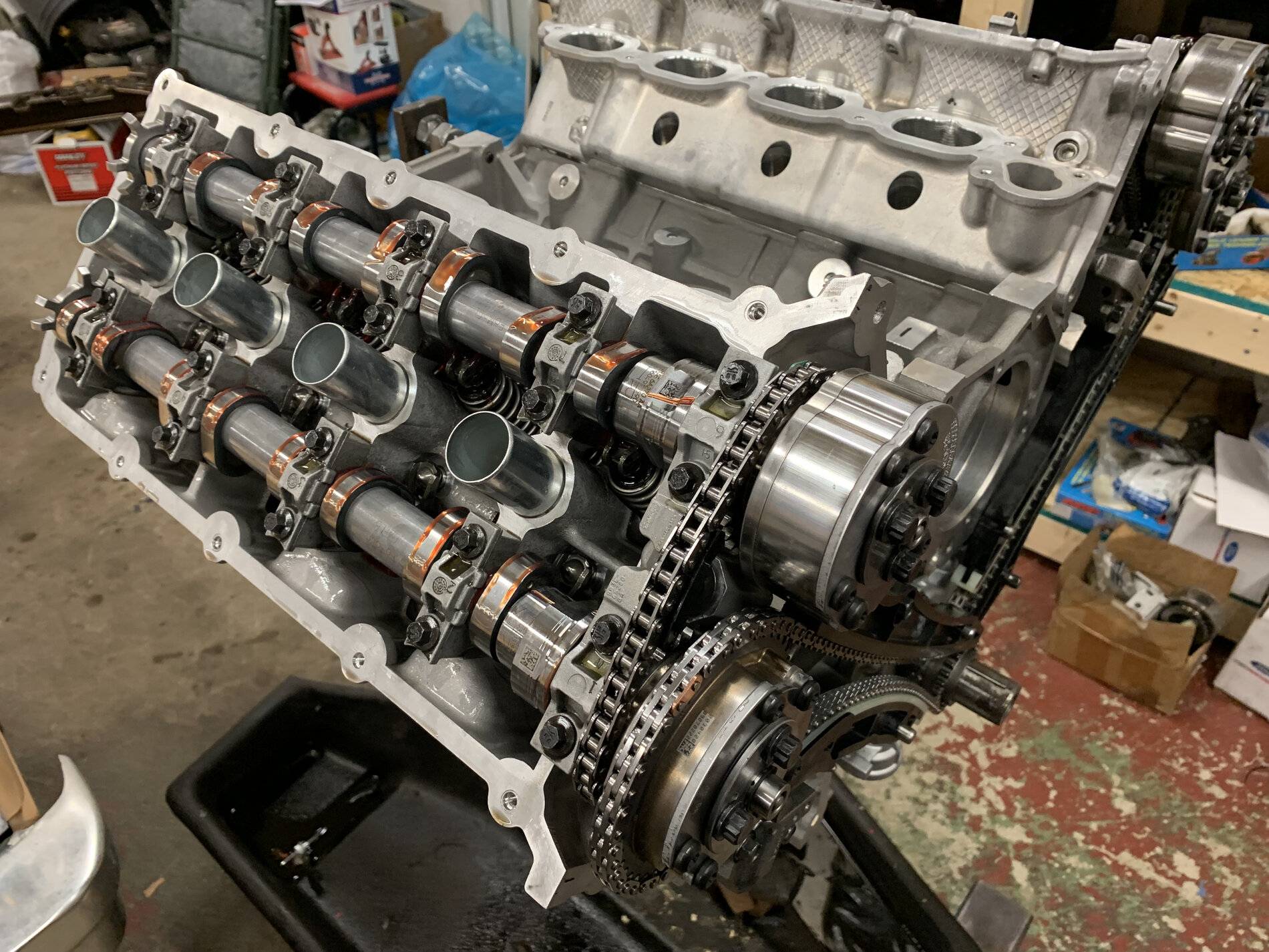

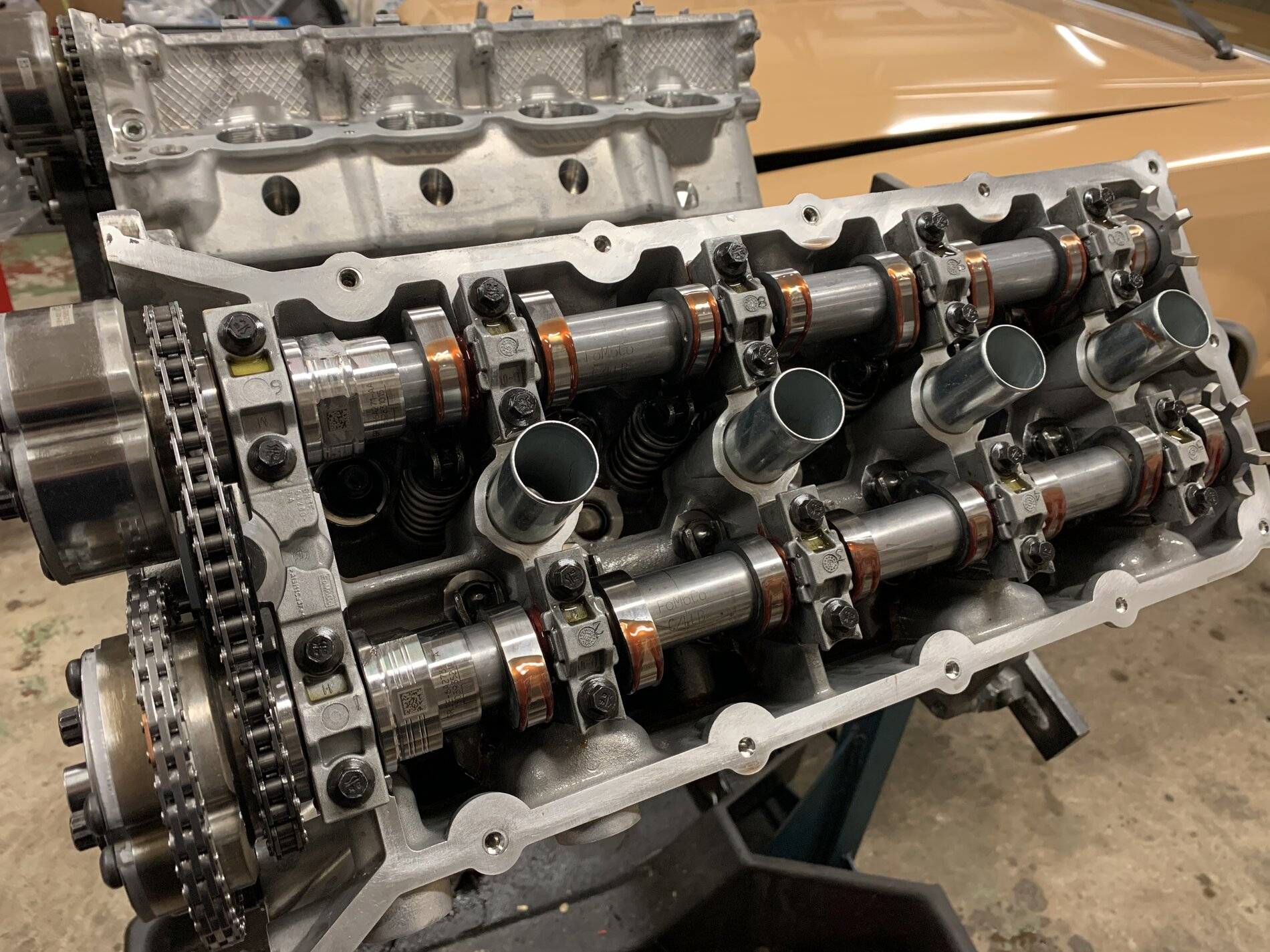

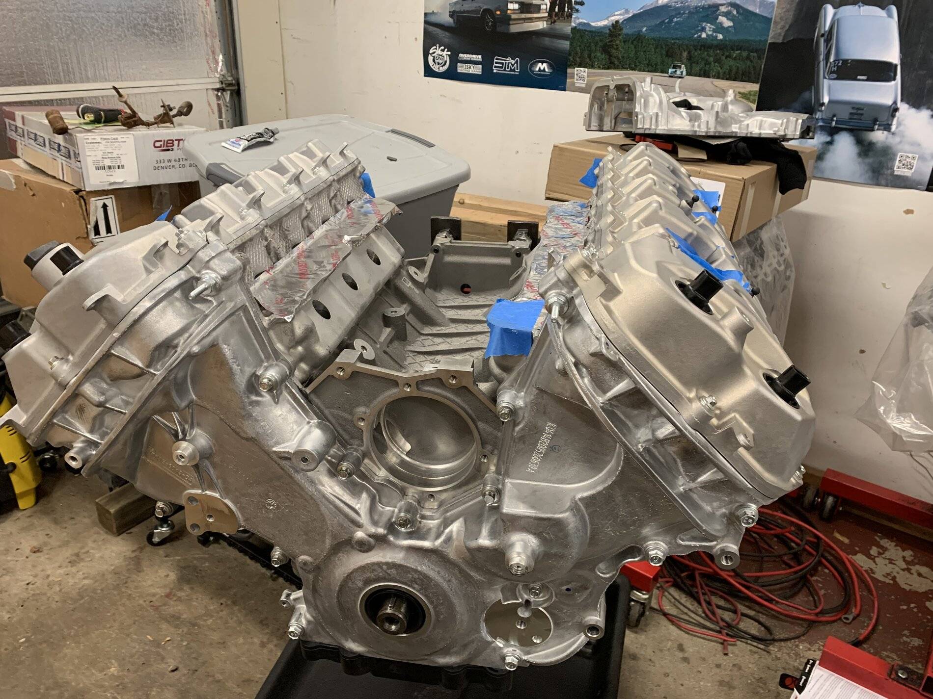

“Gen 2” Voodoo long block (thanks to Fonzie ) .. just needs front covers/cam covers -will be using the GT 500 .
i am loving the “Gen 1” he built in the car now .
I do have the car listed for sale .
I will offer the buyer the option to also buy this engine or the original long block rebuilt/sleeved and just refreshed by RPG . Heck they can have both for the right price .lol
if I keep the the car then i will hand on to both engines as my “warranty “
If I sell the car I would like to keep at least one of them for a potential Fox body swap .
