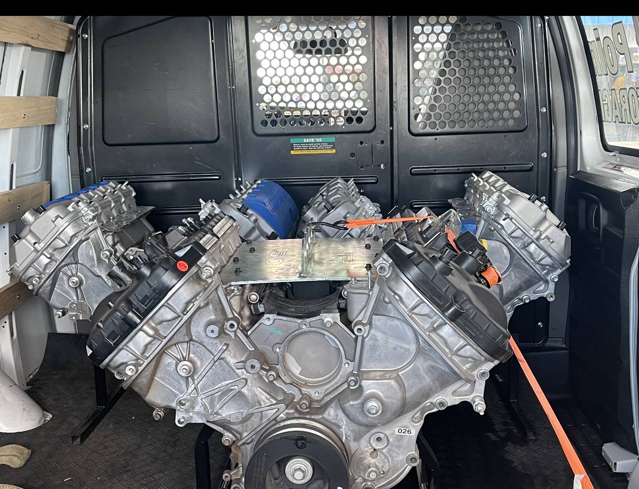

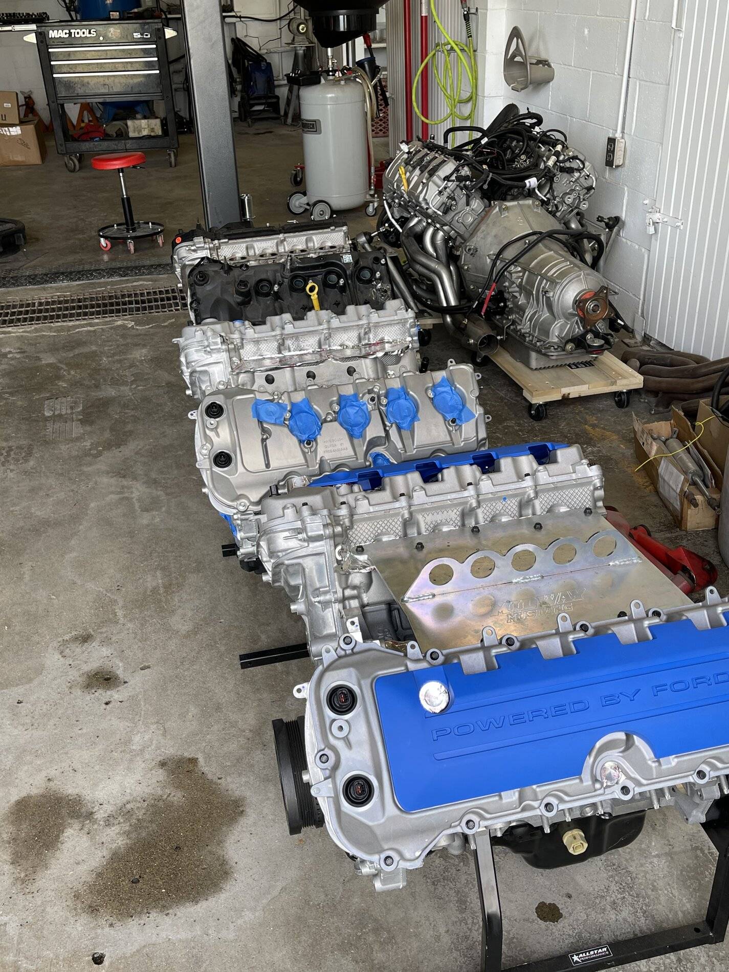

picked up my stash .
Also have a complete swap already to be dropped in ..

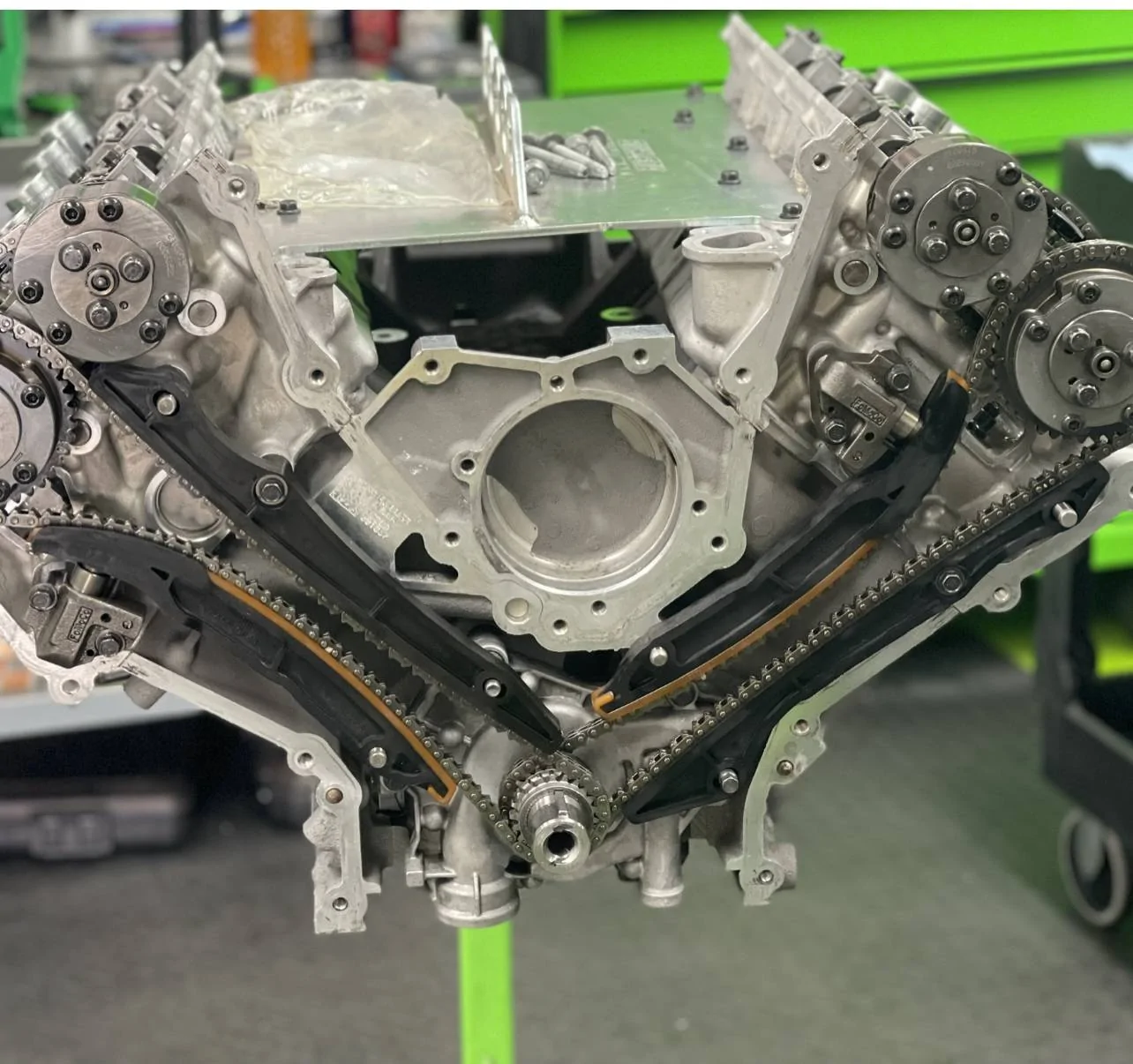

”Frankenstein “ build : stock Gen 3 SB/Gen 2 heads/Boss cams and Gen 1 timing with PBH control pack/ Built 6r80/R4200 . First of a few swaps ... finding Looking for good homes for all these engines .
Pretty sure a Voodoo’ is going to end up paired with a TH400 in a fox body some point down the road .
I am thinking of going back to NA in my GT 350 with the original motor I just received back from RPG (sleeved/new pistons /Oliver rods ) and transplanting the current power train (Fonzie built Voodoo/2.9 Whipple) in to one of my planned swaps .

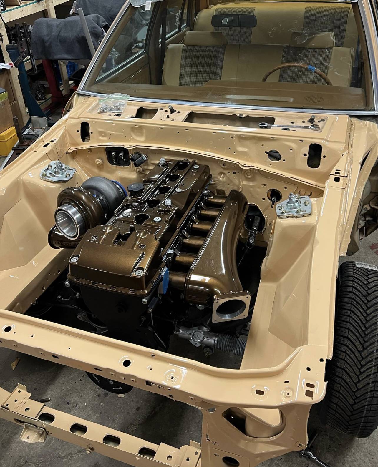

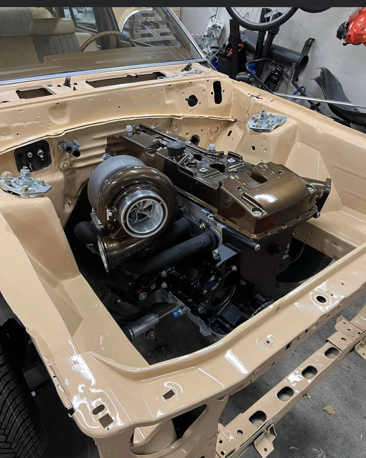

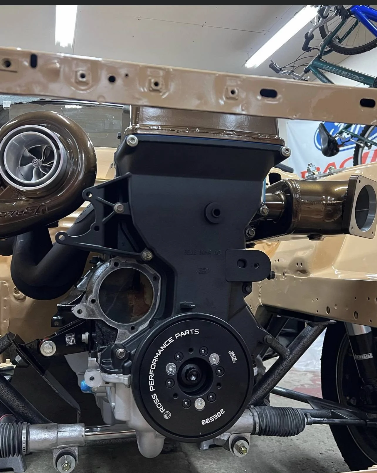

What's the plan for the wonderful Fairmont wagon in the background?
That’s Fonzie’s .
I know he has big plans . Ordered an engine from Australia . Cant remember what it’s called again but I am sure the resident engine experts will know .

Barra? That would be an interesting swap into that for sure.
I've wanted a pristine Fairmont wagon for ages to build a sleeper. That one is even the perfect color.
yes that’s it .

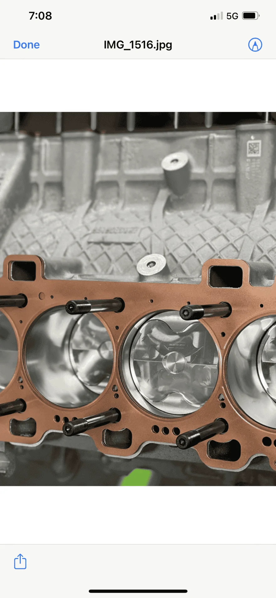

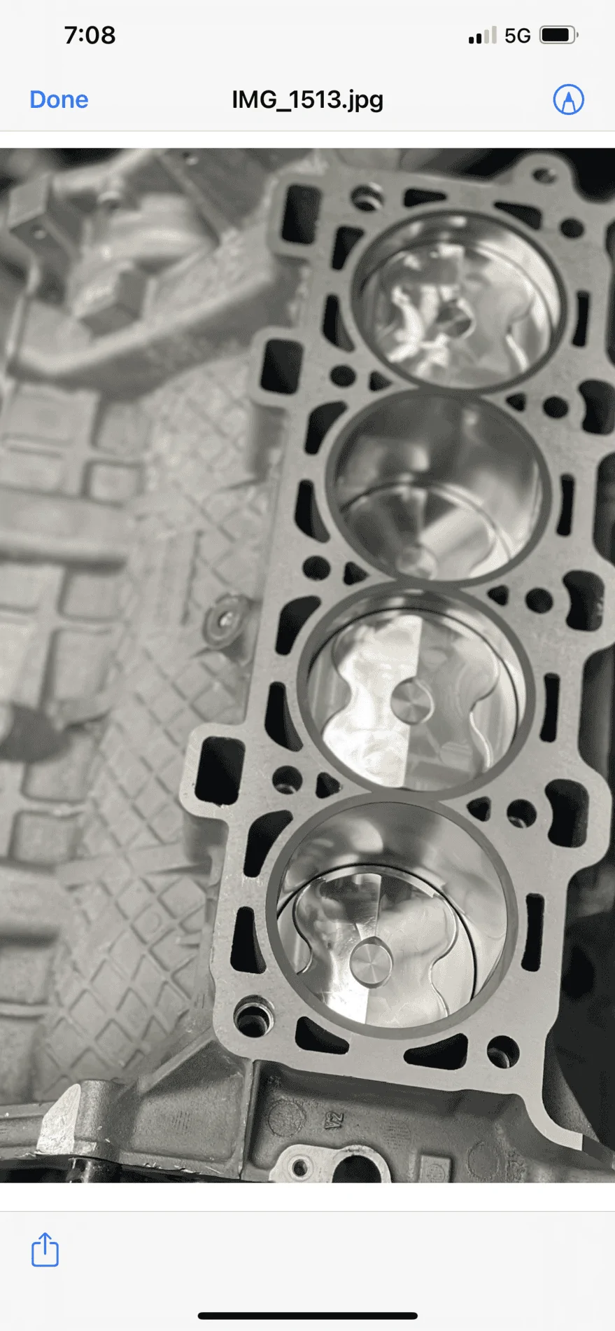

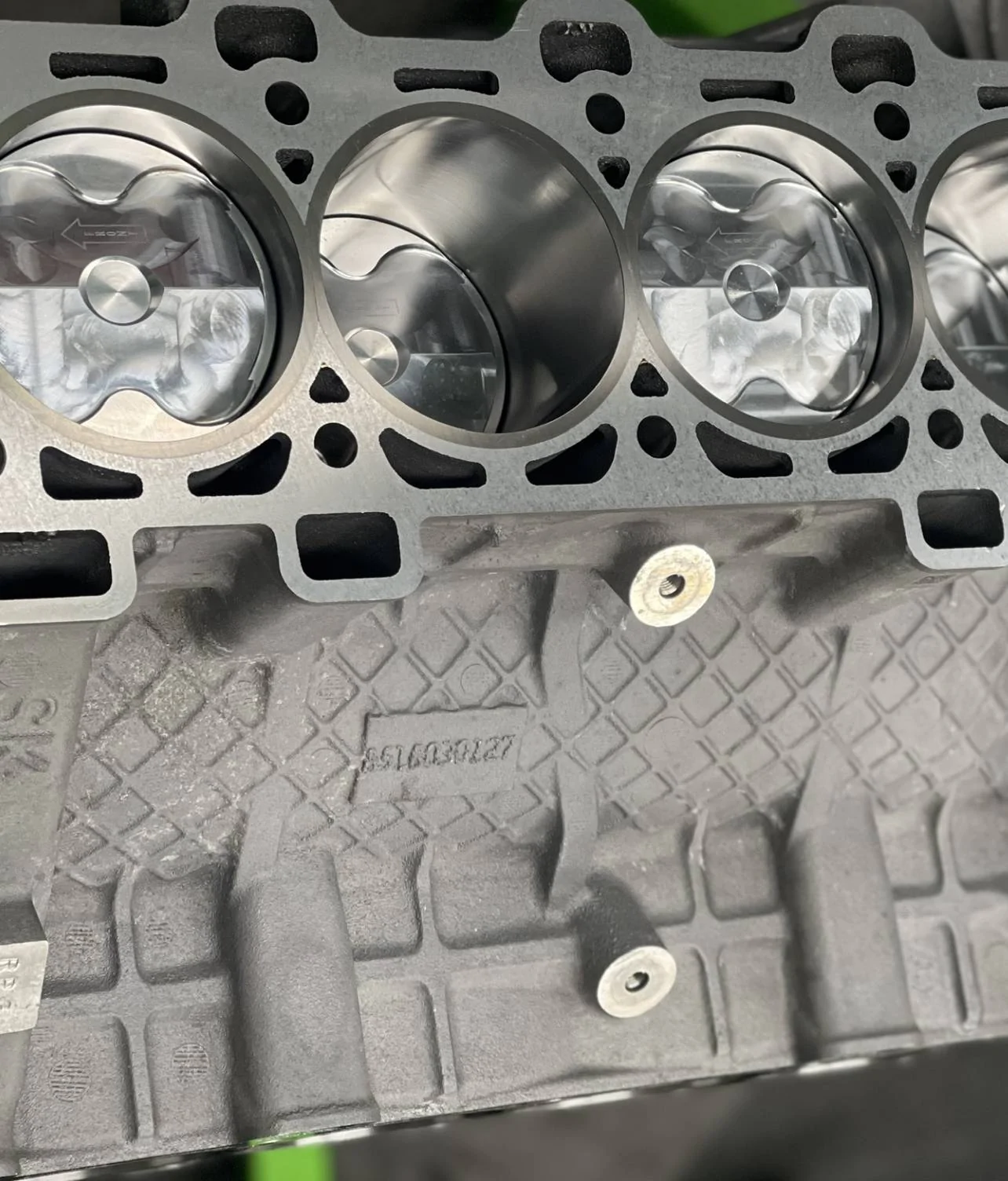

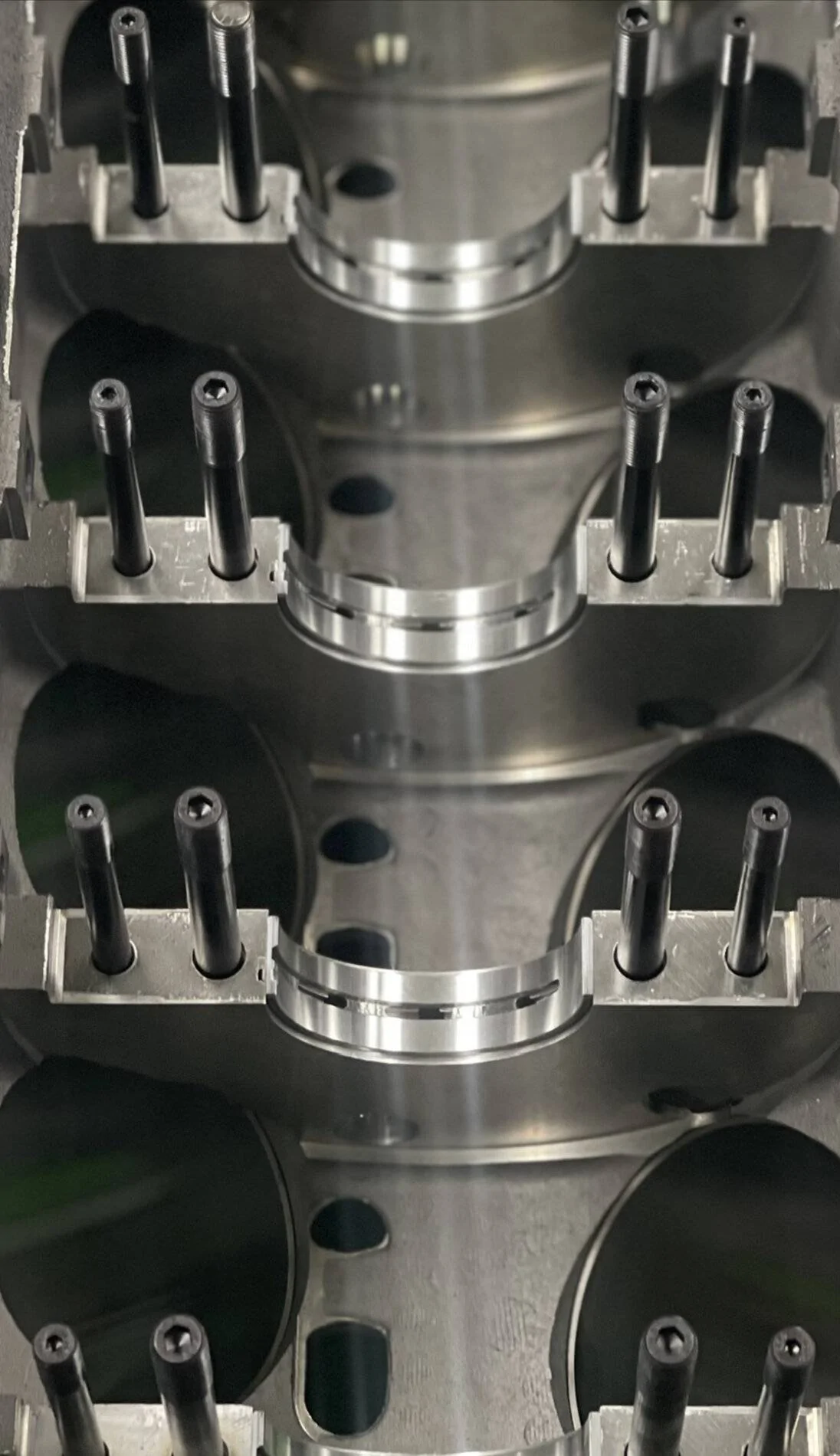

Received RPG motor back ... so I feel like am sitting on a “gold mine “ of engines . LOL
Not a Gen 2 voodoo but a sleeved Gen 1 .
Note only 2 knock sensor bosses .

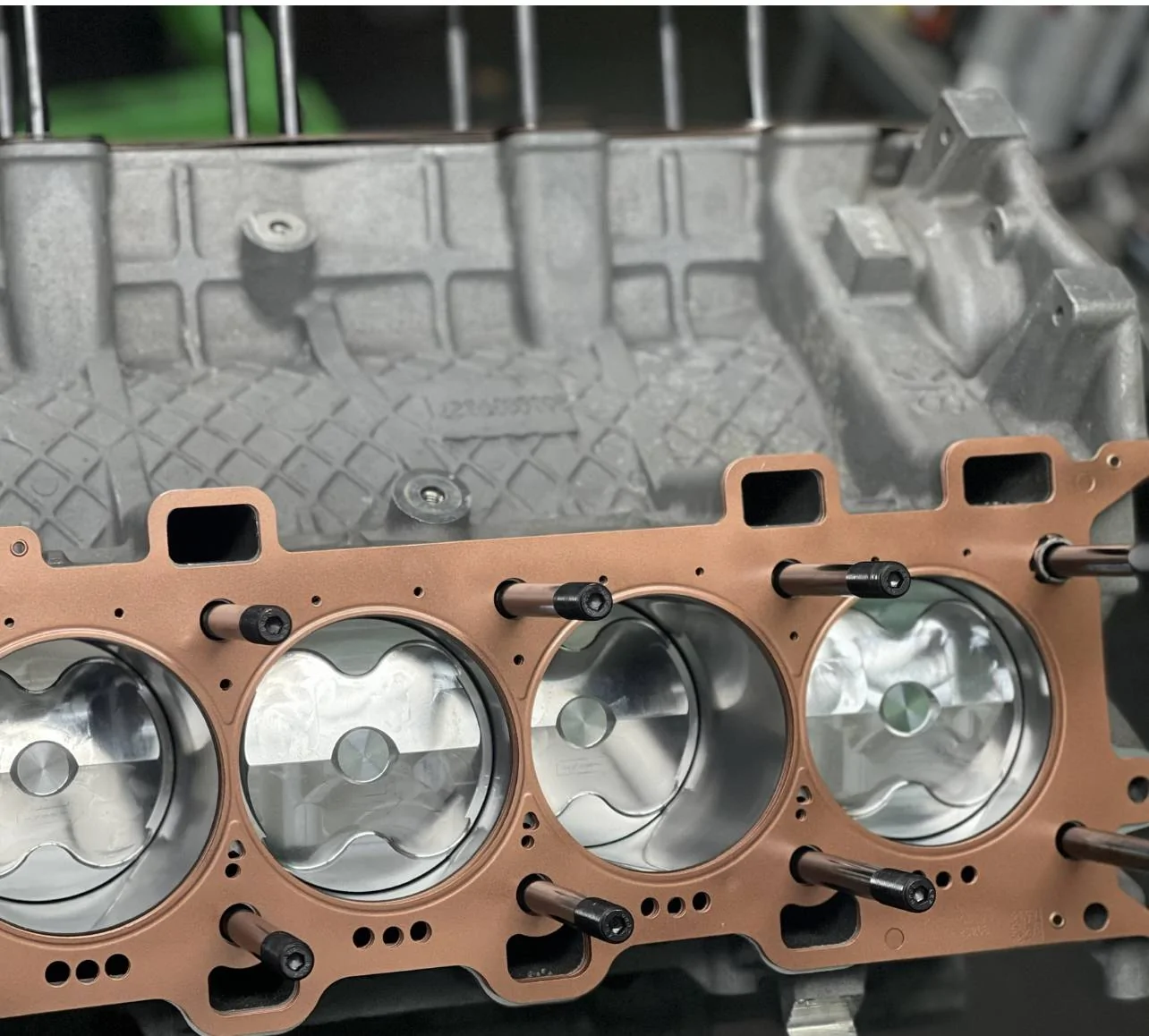

Indiana

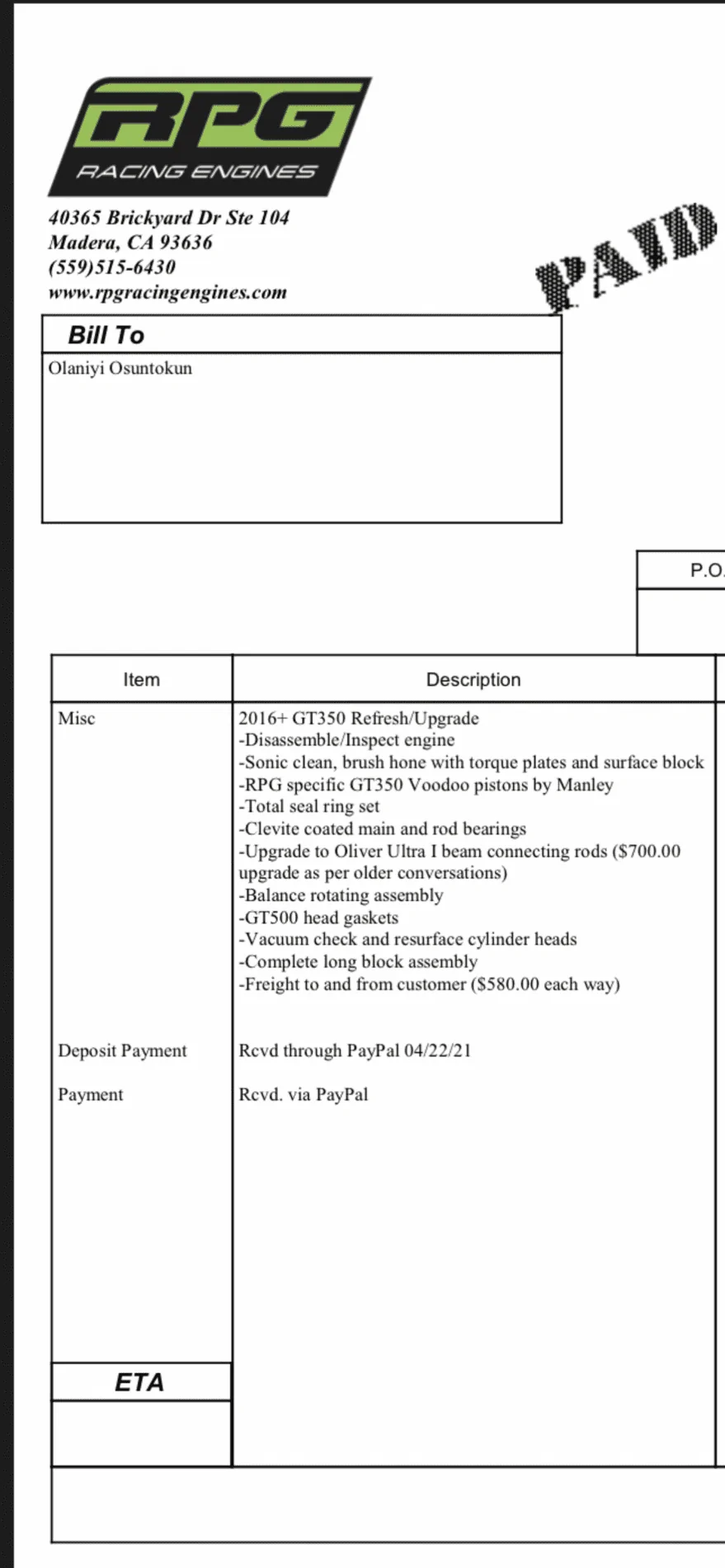

Final build specs .
RPG Manley piston/ultra light oliver I beams
I thought the pistons looked too shiny to be Mahle (stock )

Sent PM - rebuild cost .
Note this was a “rebuild “ of a previous build
Had the block sleeved the first time around and line honed for main studs .
Also previously had head studs /valve springs and OPG/CS .
