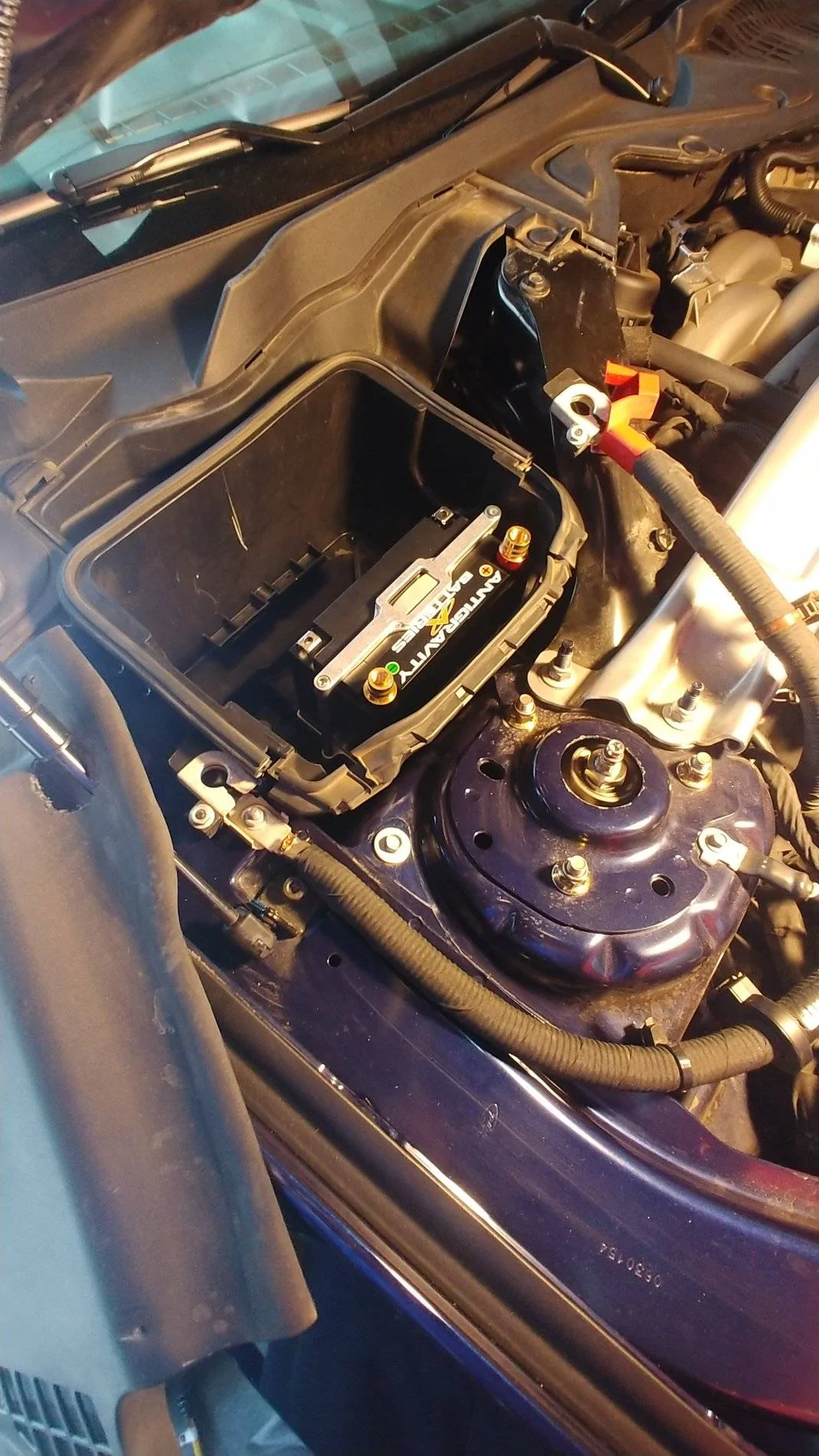

People are ordering the ATX20HD or ATX30HD, the 30 has more Amp Hours and Amp Hours are the Capacity of the battery meaning how much energy is stored in it. So more capacity gets you more storage time and can handle more accessories like Camaras or Radar detectors without draining as fast when the car is not being driven. Keep in mind and ATX20 is more for Hi-Performance or Track use though many are using them for street daily driver use also. Check with Sagittaria... he Daily Drives his ATX20HD, but not sure if during the super cold. We are just always conservative in our recommendations since we don't want people saying the battery drained fast when the ATX20 is not meant to be a direct replacement for a full sized Lead/Acid battery that much larger. So we say for mainly daily driving go ATX30HD.
As far as the mount... we have one for the ATX20, and ATX30... I will try to post pictures.. but for the drop in fit you would still have to rig something like Tomster did until we finish the mount. But we do have Something as below that could work for the ATX30, but we would have to cut the sides off (the Left and Right sides) because this is for an H6 size Battery which is the same width and footing mount as the stock 96r Mustang Battery, but it is a little longer left to right. and we could cut that down for you to work if anybody is interested, but it only works with the ATX30HD size.

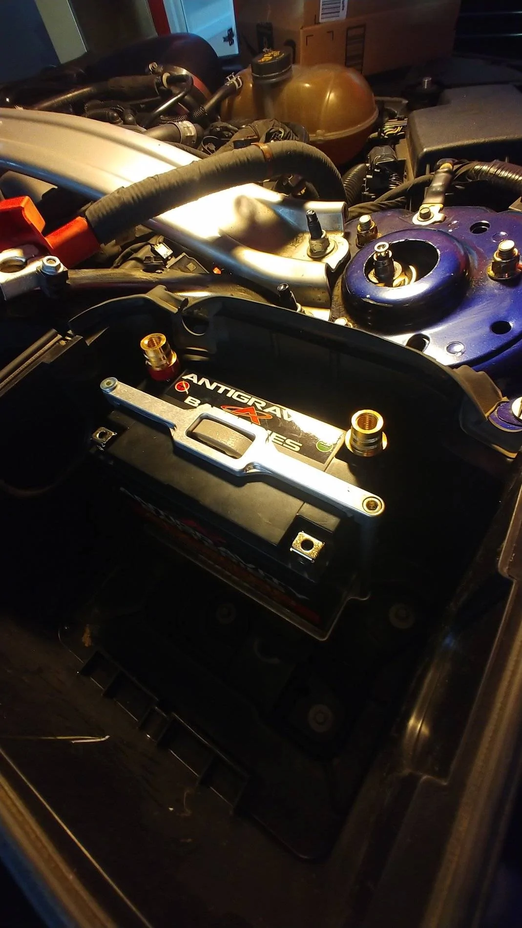

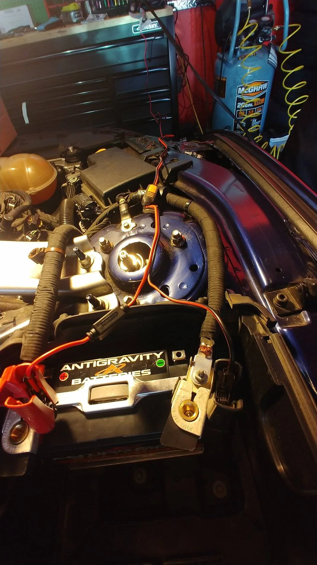

1 month with the battery
This is how I secure the battery. 2 bolts. Superstable
So far so good. Days without charging and battery is perfect.
First 30mins drive the Volts were going crazy. Oscillating btw 14 and 16 V. Then I think the system learned and stabilized around 14.4V like my old OEM battery
