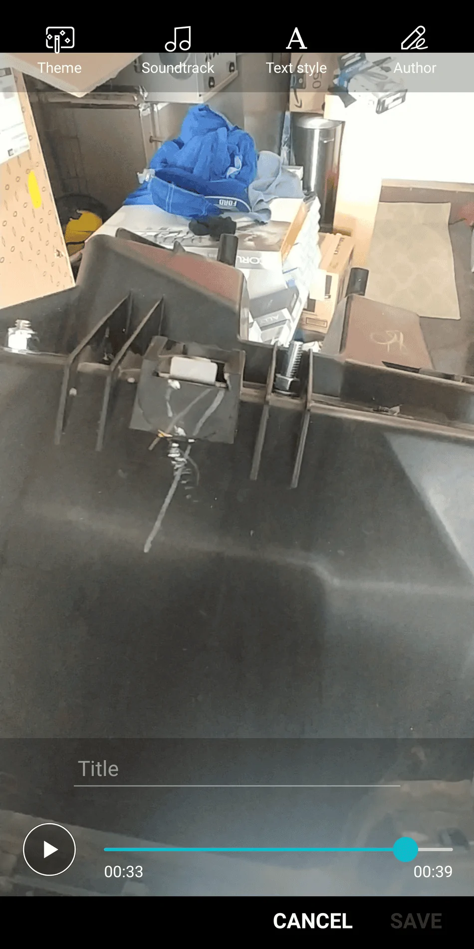

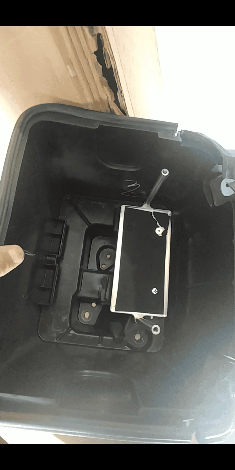

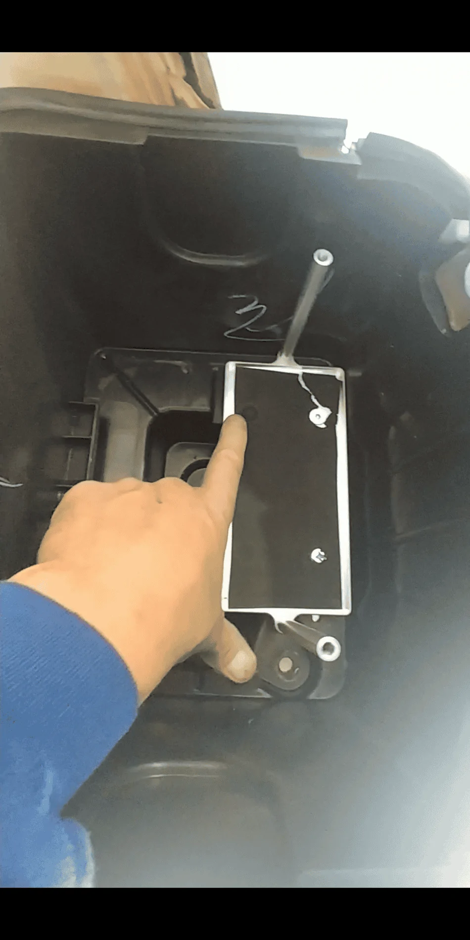

Drill 2 holes. Box is plastic. Be sure you keep the 3 box bolts holes free. So i ended put the older toward the inner part of the box( meaning watching the car from the front the battery older is on the right of the box. Last. Under the box , there are some plastic fins. I was able to put one of the antigravity bolt. Right in between the fins. It will be easy to see them in real life. Kind of hard for me to explain but i hope u understamd with the pics :)

Thanks for the reply and additional details. What you did makes sense. Before I drill the factory box, I think I'm going to try creating a base that will fit in the bottom of the factory box. If I dont like that, I may end up following your method. Thanks :handshake:
